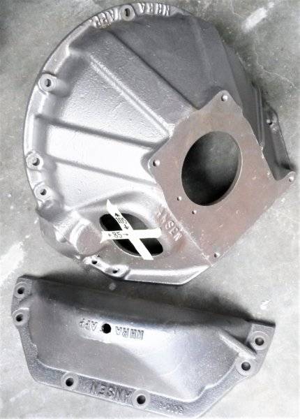

Back ground. I´m building a Nostalgia SS/B Barracuda racer (hemi) and since I got an Ansen Bellhousing with the 18 spline A-body trans and don´t like the look of a new Lakewood, I decided to try get this to work.
The original SS Steel Bell is hard to find and would cost a fortune anyway...
172 tooth fly wheel with bolt pattern for a 10,5" clutch is no problem I think.
There is reason to believe Ansen did use a clutch fork available at the time. Possibly from a ´66 Hemi B-Body.
´66-69 apparently use a throw out bearing with a shorter sleeve so probably this one as well.
Clutch linkage is a matter of measuring, cut and weld so I don worry to much about that.
Early (´64-69) clutch fork and throw out bearing is what I need. Or so I think…
Anyone have any experience with this odd B-Body stuff?
Would really appreciate if you taking the time.

Yes I have been in contact with them, but did not know much about this odd Ansen Bell.
I´m pretty sur though I can use a ´62-65 b-body fork and hope the pivot for this fork bolts right on with out modifications…

Ok, well this what it looks like...
