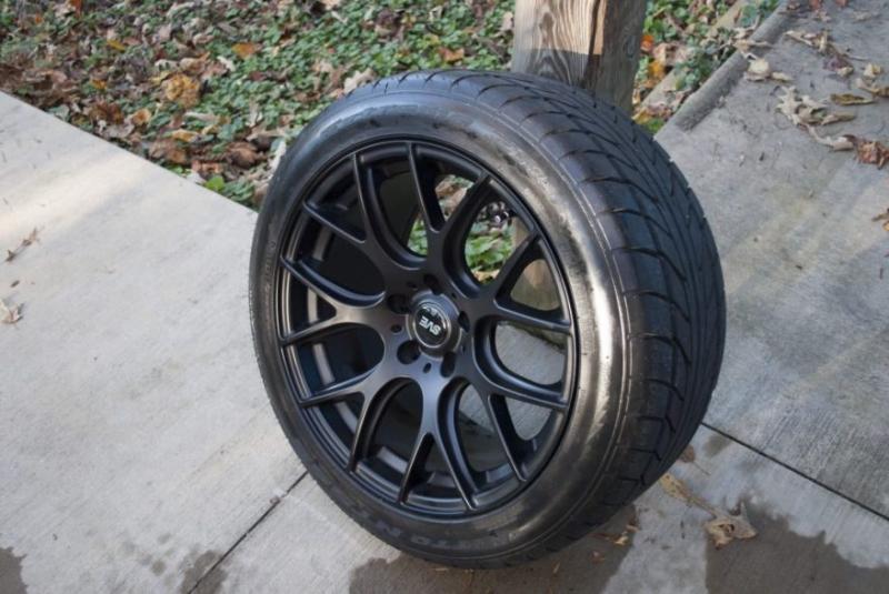

Looking at SVE Drift Wheels, 18x9 (05+) front and 18x10 rear (94-04 rear) off LMR.com. (https://lmr.com/products/SVE-Drift-Wheels)
Would like to run 255/45/18 NT555 G2 front and 295/45/18 NT05 rear to keep a similar stance, and for clearance with turbo.
I've seen an A-Body with these identical wheels, they look ridiculous (in a good way). Does anyone think the 6" backspacing will be a problem on the front and rear? Fronts have a +35MM offset, rears have a +22mm offset.

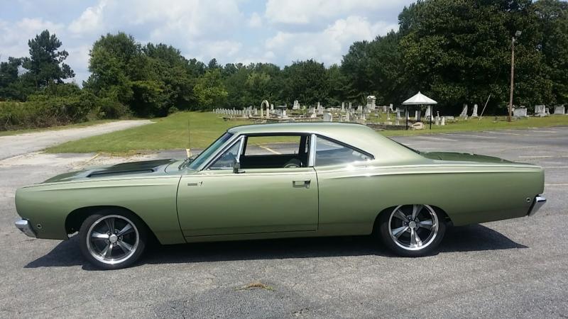

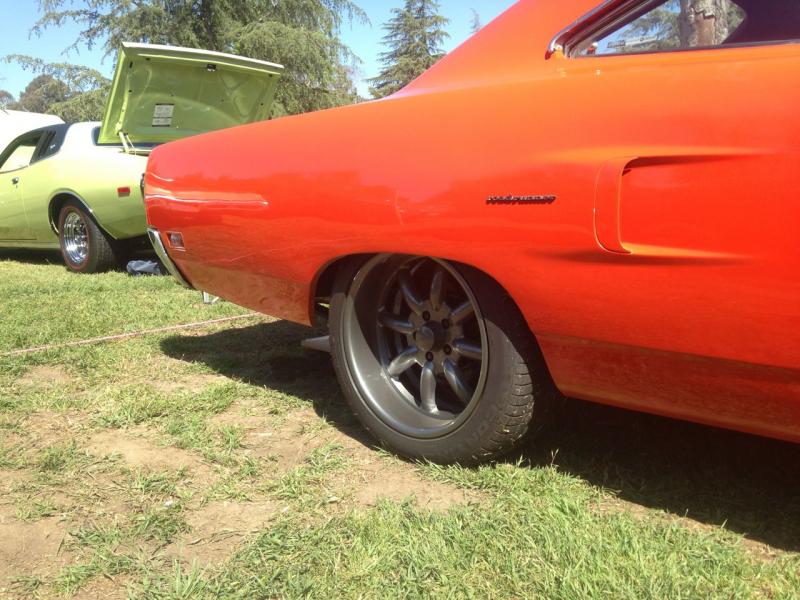

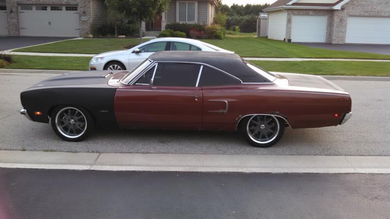

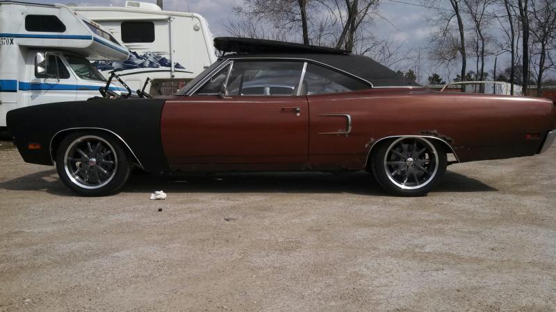

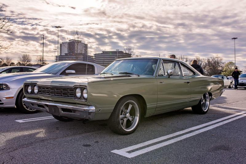

here is mine, had to go with 18s to clear the wilwoods. i tried to go with the biggest side wall. i don't like the rubber band look. 18x8.5 front 18.9.5 rear. none taken RC, we all can't be the same, what fun would that be.
i got 4.5 on the front an 5.75 in the rear for back spacing. you might get by with the 6 in the back but i think you will have a problem with the front. jmo

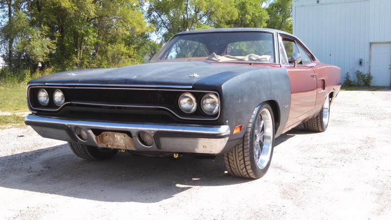

I have 18x9 in back and 17x8 in front. Think I could've gotten a tire with more sidewall though

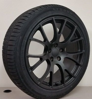

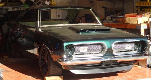

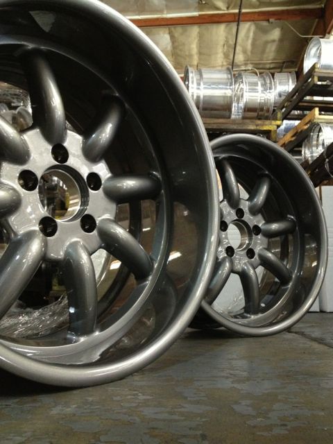

Here are the wheels on Moselyme's A-Body.. As you can tell, it's pretty much identical to a factory Hellcat wheel but in 18" diameter. Not sure if he's finished the car, from the build it's been under construction for a few years.

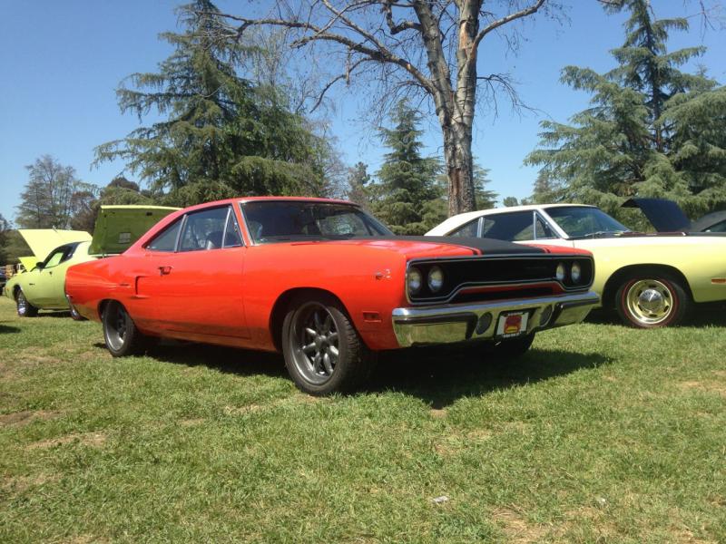

I'd post mine but they're 18 fronts and 19 rears, 18 all the way around will look great.
hey ummmmm, i think there should be some more pics of your ride graginov911. don't be holden out. lol

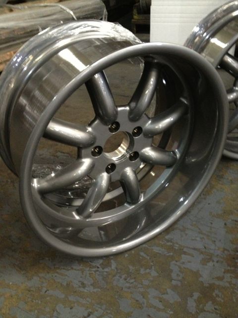

Great images, thanks for the feedback. It's surprising how a few members believe moving to larger diameter wheels is blasphemy. The wheels I purchased are nearly identical to the Hellcat, just in an 18" format. Would I run 20's, of course not, but you have to step up into 18's to have the proper wheel height in order to clear the tie rod assembly. With 6.3" of backspacing, I believe it will work. If an A-Body can use this setup, then with a B-Body it shouldn't be an issue. You can always run spacers to push the wheel out, but not the other way around.
20-hellcat-replica-wheels-dodge-challenger-satin-black-5x115-255-45r20-tires_161884107253.jpguhupu3az.jpg

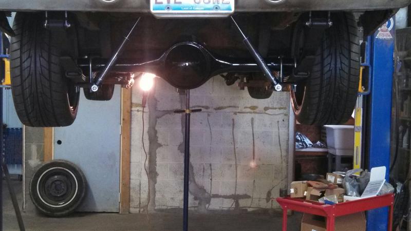

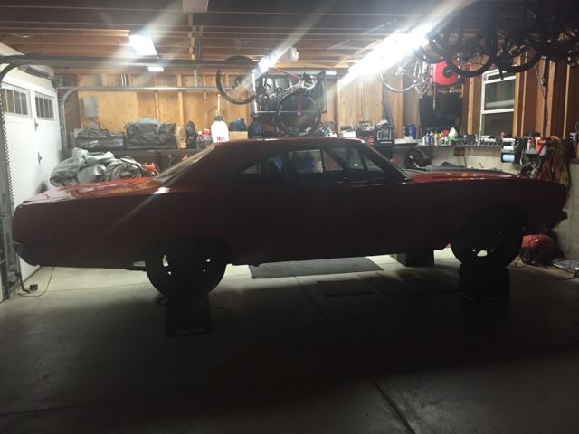

Well, wheels worked out great. No new pics yet, still waiting for my 14" wilwood 6-piston setup to arrive for the front. Just needed a 5/16" spacer on the rear, have around 1/2"-3/4" of tire clearance to the leaf, another 1.5-2" to the outside fender. This is with a 20ish mm offset on the 18x10 rear with 6.3" of backspacing.
