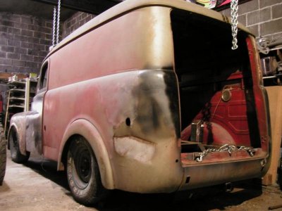

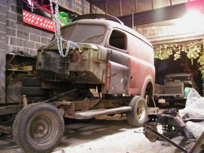

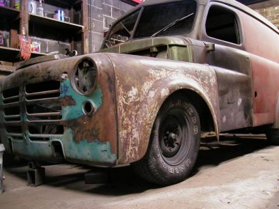

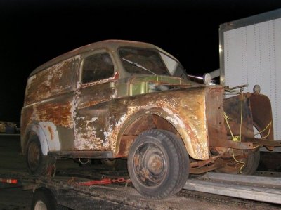

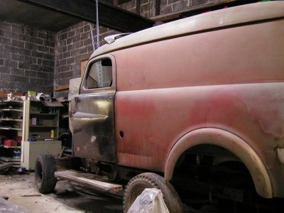

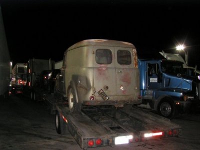

Arrival Day on transport from California (in 2001). I bought it on the Internet for $500 and it cost just over $900 to ship it to Iowa.

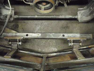

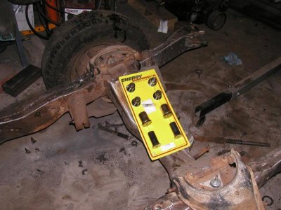

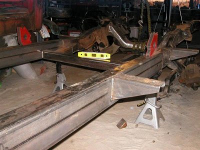

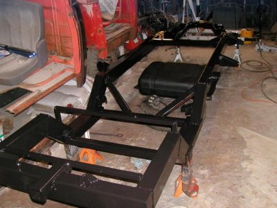

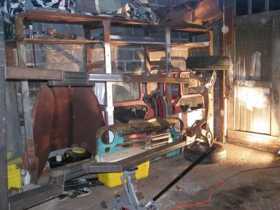

Frame Pics. 1988 Dakota IFS 3" x 5" x 3/16" steel for the rest of the frame (I know... Way OVERKILL)

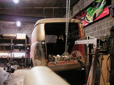

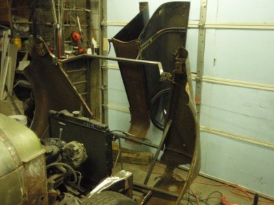

Removing the body from the old frame was interesting... But fun!

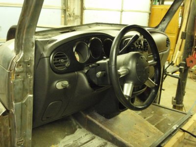

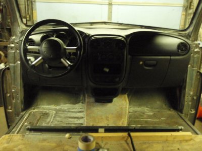

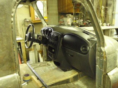

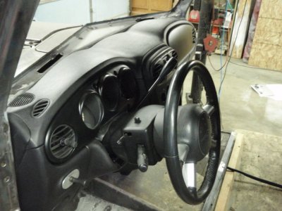

2004 PT Cruiser Dash and wheel. 2000 Dodge Durango steering column
167822_1820827166290_2438846_n.jpg167630_1820827006286_1164417_n.jpg166829_1820826766280_4047748_n.jpg168042_1820827326294_6161920_n.jpg168946_1827856542020_6807646_n.jpg
167822_1820827166290_2438846_n.jpg 167630_1820827006286_1164417_n.jpg 166829_1820826766280_4047748_n.jpg 168042_1820827326294_6161920_n.jpg 168946_1827856542020_6807646_n.jpg
thanks , now bring us up to snuff
dam we must both be working our keyboards at the same time
boy that dash sure looks good in there

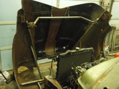

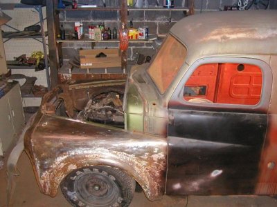

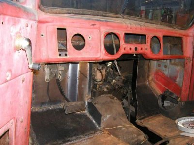

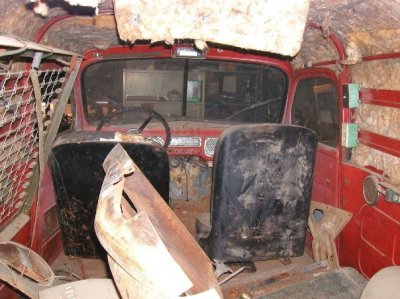

For Reference purposes... This was the original dash and a shot while I was fabbing up the new firewall.
Too many holes here

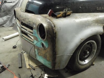

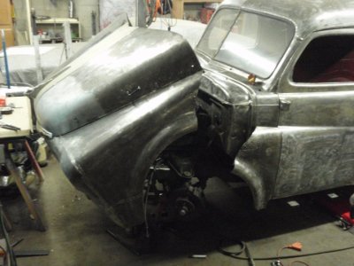

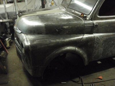

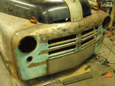

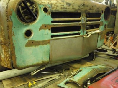

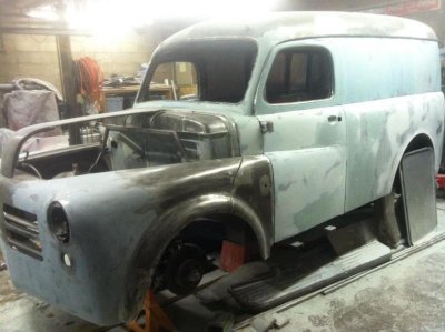

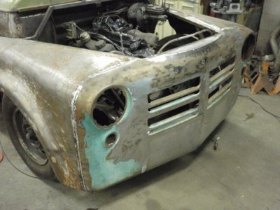

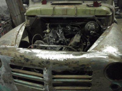

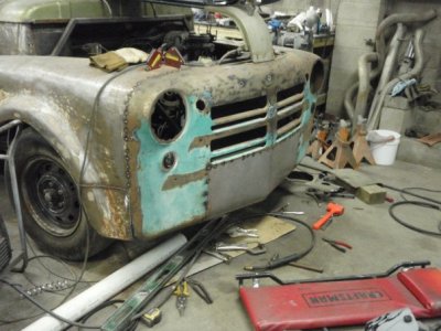

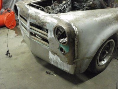

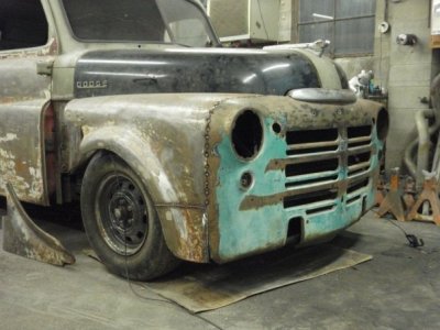

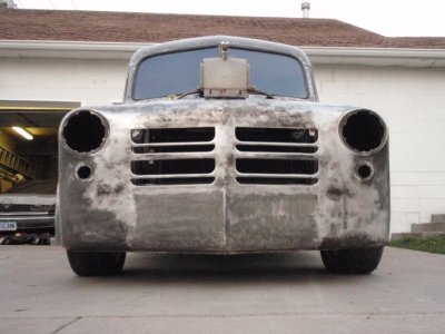

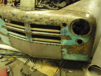

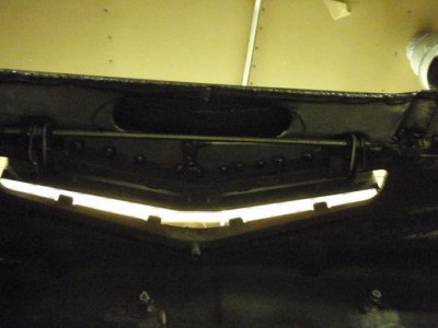

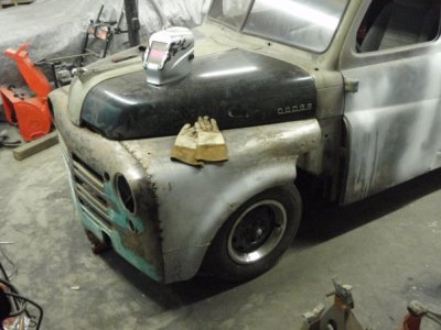

I put a defined "point" on the front of the Panel Van to match the rake in the windshield... It was all too round and un-defined before.
12834_1294315283822_5632985_n.jpg12834_1294315323823_4991087_n.jpg12834_1294315363824_1188984_n.jpg21551_1297190035689_7010402_n.jpg21551_1297190075690_7146382_n.jpg17151_1303510873706_7688439_n.jpg17151_1303510753703_7605608_n.jpg17151_1303510833705_5952102_n.jpg

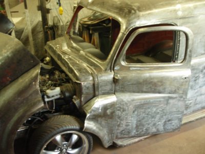

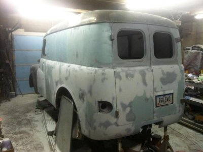

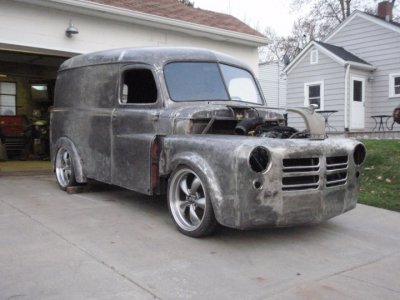

I loved the look without body filler... but it just wasn't straight.

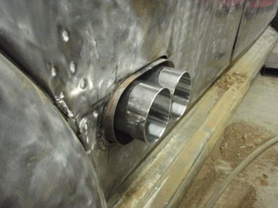

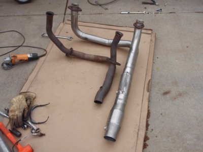

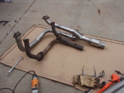

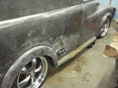

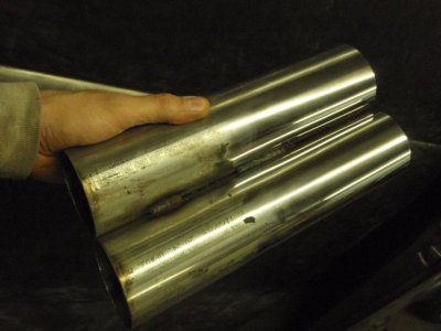

Some Exhaust work... That's two 3" exits for the exhaust.
26095_1406545009495_7929595_n.jpg26095_1406553329703_8202486_n.jpg26095_1406544929493_6217402_n.jpg
Here's the Old Y-Pipe for the 2002 5.9L engine next to the one I fabb'd up out of 409 Stainless.
looking very sinister :headbang:

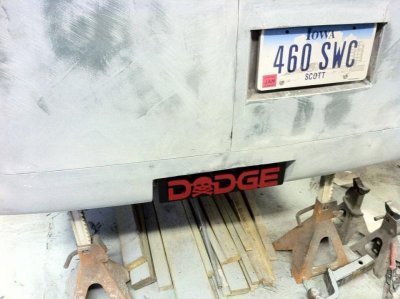

Some custom touches on the rear...

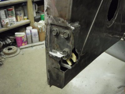

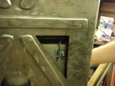

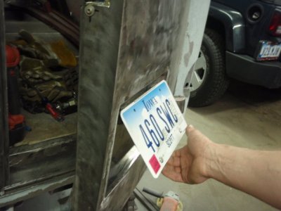

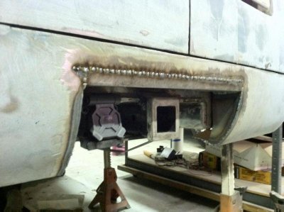

Here's the mount for the 7-Pin trailer connector. You can see it is hidden well in the previous pic.
Notice, there is no door handle...
Oh wait... There IS a door handle!

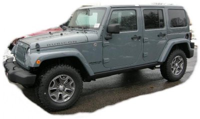

I have gone through the full gamete of possible colors for this thing and still have not decided. It may just end up a satin black. But I keep thinking about a straight up gray color that kind of looks like the truck did before I added that plastic filler... Kind of a polished gray. I have a few samples of colors from vintage '50's Dodges. But then Jeep came out with a new version of the same gray on the Wrangler this year so I may go with that. I know it's kind of a boring color, but I'm not looking for anything super flashy on this one.96d01a20877b7ce9105811df776540adx.jpg

Doesn't it though!! I was WAY surprised how good it looks. It's like it was meant for the '50's Dodge truck! Just a 1/4" to spare from side to side too. Of course, I had to cut down the dash top, but Okay...
I like the Jeep color better myself and yes that dash looks awsome. How did you come up with that dash? You couldn't ask for a better fit.
I'm kinda diggin' the Jeep color too... Plus, it has proven difficult to get the 1949 paint color formula for a 2014 paint. That dash was an accident... I spend time in one of the local junkyards "window shopping." I was trying to brainstorm one day and came across this PT Cruiser that someone had already pretty much dismantled. The dash was on the ground behind the car... It hit me as soon as I saw its shape. Nice thing is that I can work some amazing freakin deals at this particular yard. That whole dash (well, I had to buy pieces from three different ones to get one entire one) only ran me $30!
