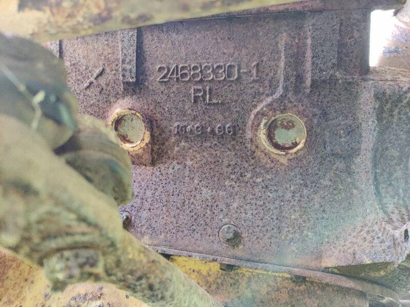

By the way. Here is the # on the side of the engine block.It looks like 16-3-66
The cast 10/6/66 is to late for a 66 car. Your plan to clean cylinder before removing pistons is good but they come out the top.
My thoughts? Take it to a machine shop or someone with experience.
I agree with @R413 I would take the entire engine to a reputable machine shop before I would recommend getting in there with a cylinder hone. Just my $0.02
