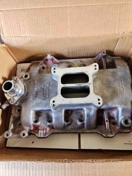

So I came across a dual carb intake for a poly 318, and thought about grabbing it for later use. Right now my 318 is stock with 2bl carb and runs great, 15 psi oil at hot idle and like 40 more or less while driving…doesn’t get hot or anything…so don’t wanna mess with something that’s running so well…I wanna enjoy it with my family for a while. (Speaking of which…he told me he changed oil and used 10-30w…but I always like to change oil when I first get a car…think I should use rotella 10-30 T5 for the zinc?)
BUT…I’ve been looking for when it IS time to rebuild…I’d like to keep the poly, and it would be neat to have a dual carb set up. What all would be necessary to utilize the dual carbs and what carbs would be good on it? I was told I could install it right now with 2 500 edlebrocks but I just don’t think that’s right…I’d think I’d need at least a different cam or something huh? Seems like it would be too much carbs for the stock engine as is. Also I figure linkages would be a pain..
Intake in question:
I'm NOT sure, but I'd bet that intake used the afb, with the small bolt pattern, and the edelbrock/Carter afb/avs use the larger bolt pattern.
That manifold is cool, but finding small footprint carbs, air cleaners, fuel lines and linkages might make it more work and money than it's worth.
On the other hand..... I'd probably pick up the manifold anyway.
Yeah true. My neighbor said he may have a 4bbl poly intake laying around when he gets back from offshore he’s gonna look for it and give it to me if he hasn’t chunked it. Prolly just go that route but damn duals/deuces are cool lol
