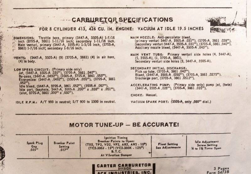

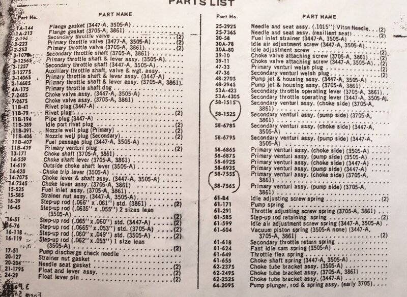

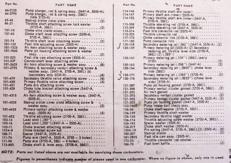

1962-65 dual quad adjustment/tuning sheet from Carter
sam dupont
3:52 PM
Nov 9, 2020
2,055
3,355
USA
Ran across this sheet I have for my 3705s carbs
Hope these are easier to read.
I can read them just fine.

Nice! Thank you much. Here goes, (can hardly wait for these answers) what is difference between a solid seat and a resilient seat on the 3705's?
Thanks again for posting.
JP
JP
You are welcome. I tried to write a title line that would pop up if anyone did a search for tuning on those carbs.
JP
The difference between the solid seat and the soft seat: solid seat is metal to metal (the screw in seat and the moving stem opened by the float pull clip) and the soft seat (basically the same EXCEPT for a tapered viton tip on the moving stem opened by the float pull clip). The best combination is the soft seat as it provides a more positive, tighter shut off and is less suseptable to dirt.
