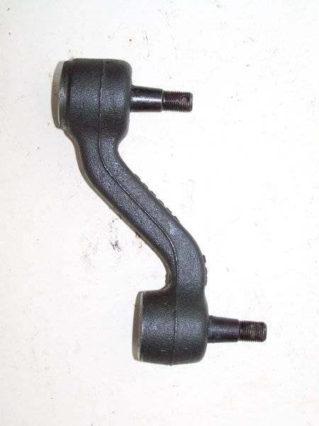

Can anyone tell me which end of the K779 Idler Arm is the K frame end?
Here is a pic of the new idler arm that I have.
There is a difference between the ends...
The heavier end goes in the K frame. Looks like the top half in your picture. There is a slight difference.
Check the other end for torsion bar clearance after installing. Some have been known to interfere.
