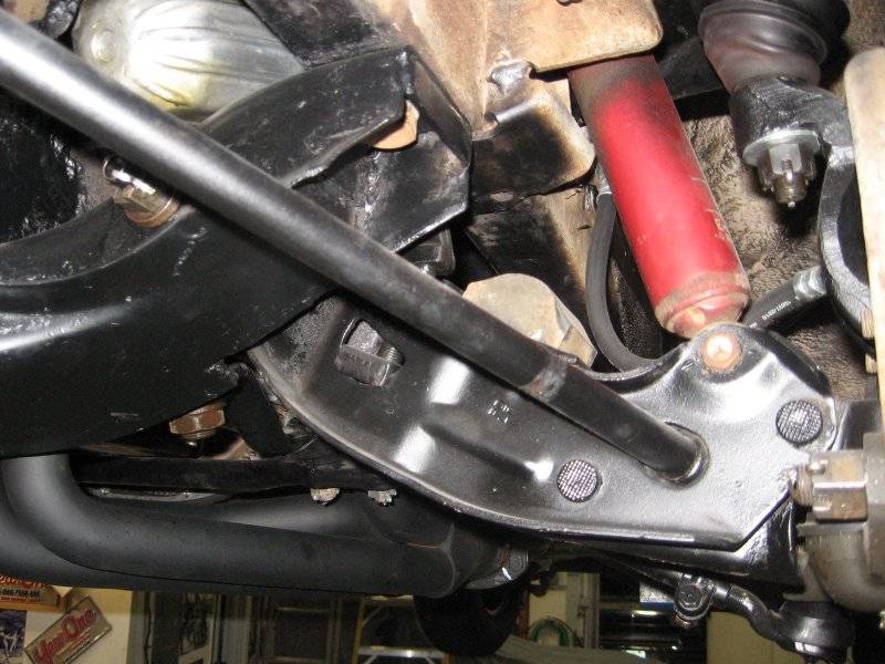

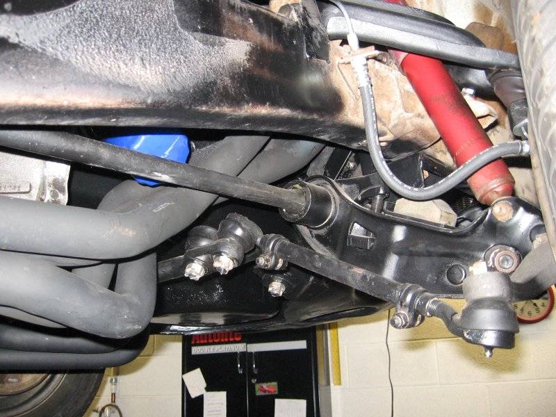

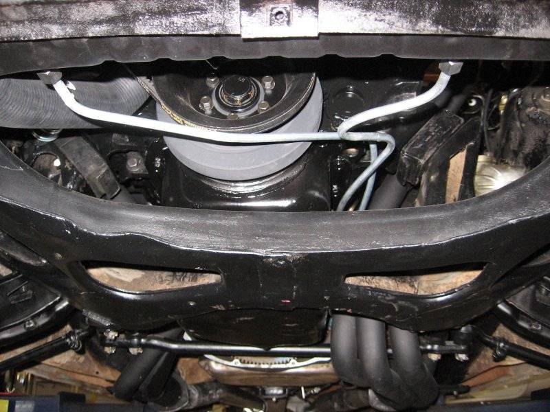

I put a 70 LA 318 and 904 in my 63. Summit and Jegs have budget headers coated and un-coated.
I bought the Summit un-coated (painted) #SUM-G9040 less than $250. Ceramic coated #SUM-G9140 less than $400.
Fit fine lots of room in a B body.I now wished I got Ceramic.You do have to remove the center link and pass it thru the driver side header.
Photos
Thanks much! I didn't know if the 62 would be any different due to the older type motor mounts but should be fine.. And yeah.. knew about the center link, i have never run a small block before but when i was a kid my friends had them and that center link issue seemed like the end of the world back then, now it's just another 10 mins :)
