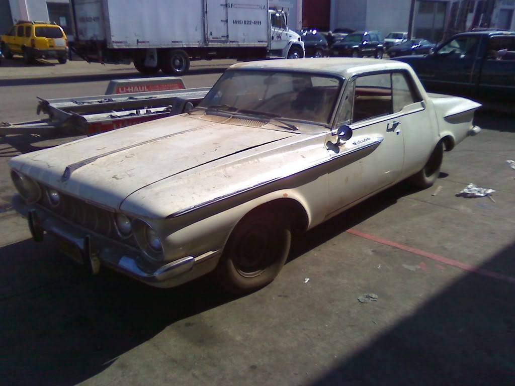

1962 Plymouth Belvedere "Jackpot"

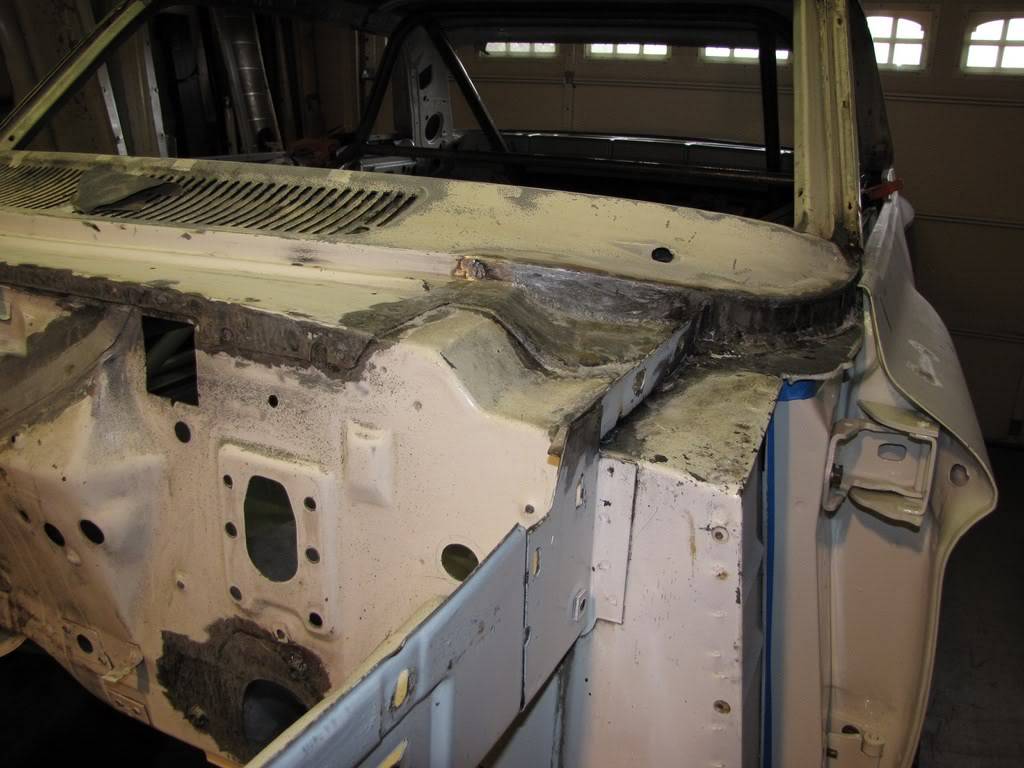

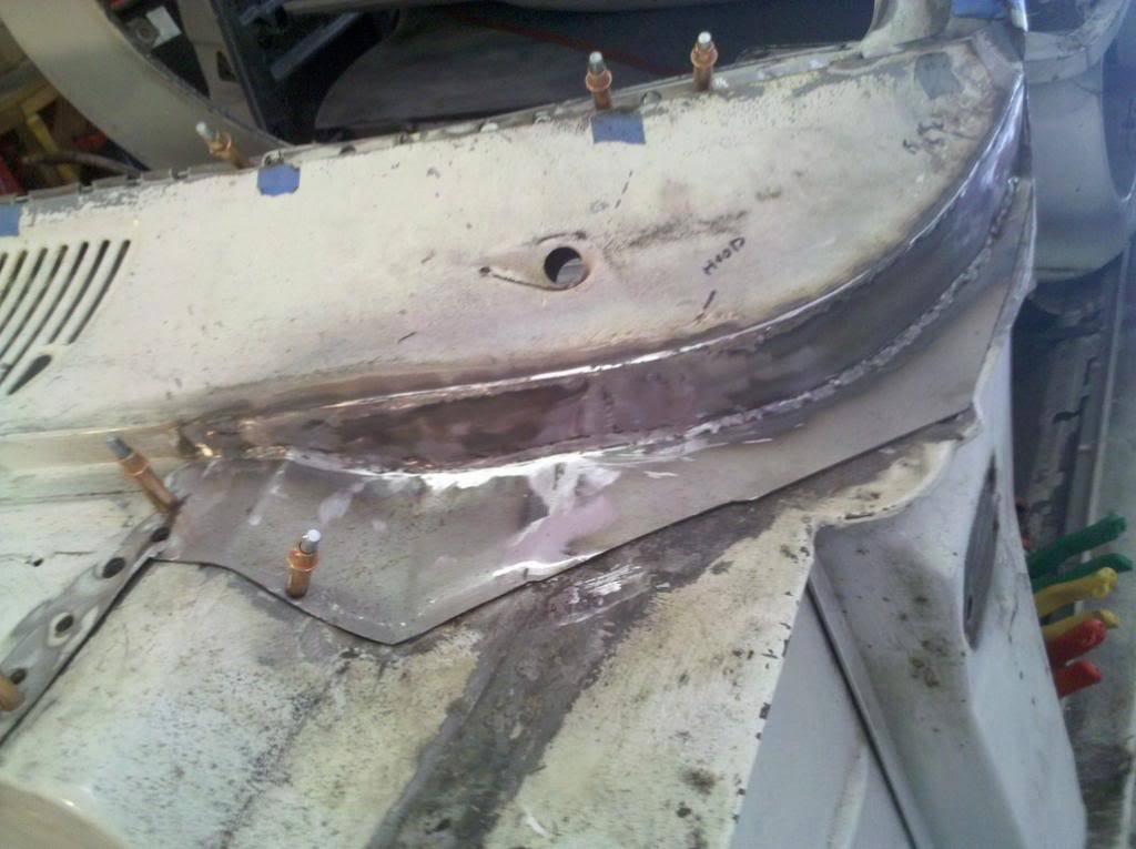

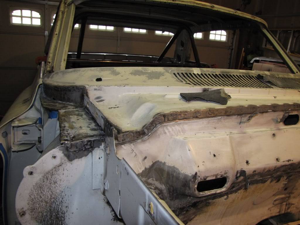

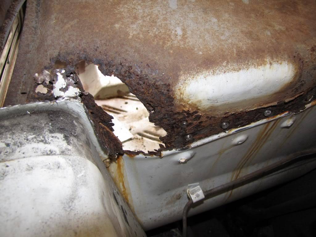

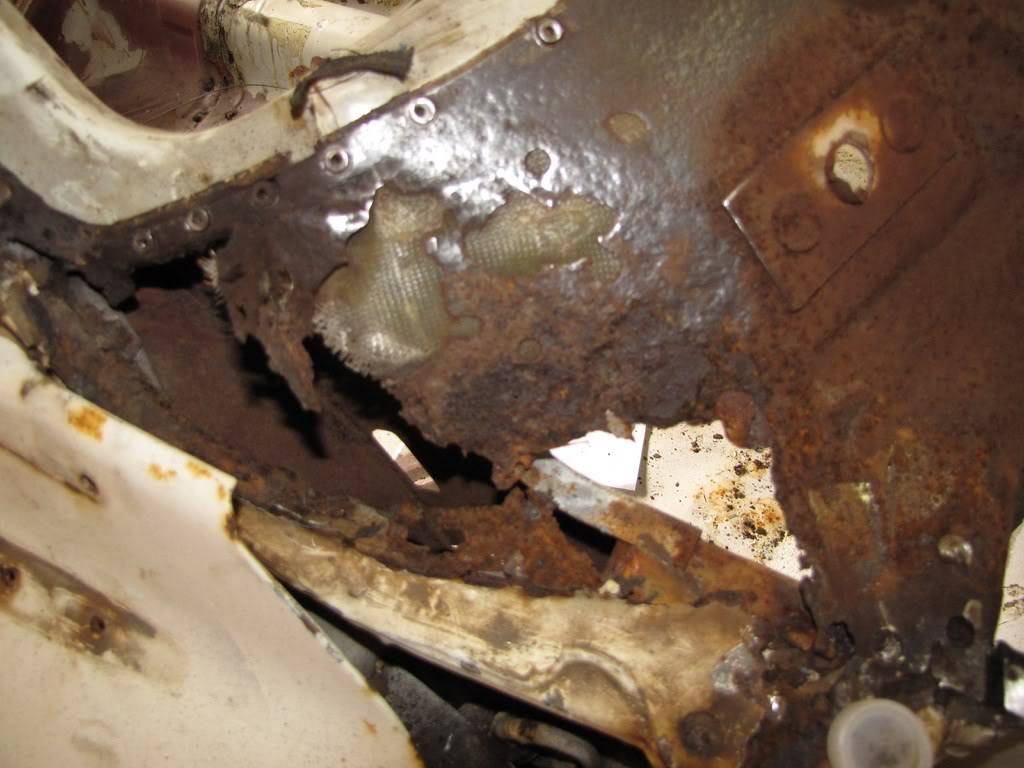

As the cowl repair progressed, I also got working on some other rust repair. There were a couple spots in the trunk, the lower corners and rear lip of the back window were rotten, and both quarters ahead of the rear wheel were rotted through. So all that was getting patched as well. Also dent repair on the roof and top of passenger quarter where years ago a tree fell on the car. Also a big crease by the tail light panel where some yahoo apparently pushed the car around with a forklift while it was in storage
Quarters being patched:
And done:

Great looking work Bodee...Man I feel sorry for you early B-Body guys. Almost every one of you end up doing some kind of crazy surgery in the cowl area because they're always rotton. Turned out real nice!
Sure is looking great. Thats a cool story behind it, wish you luck although it sure looks like you have it covered!

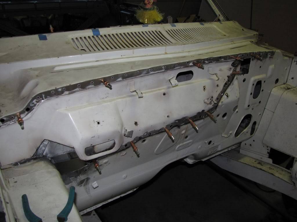

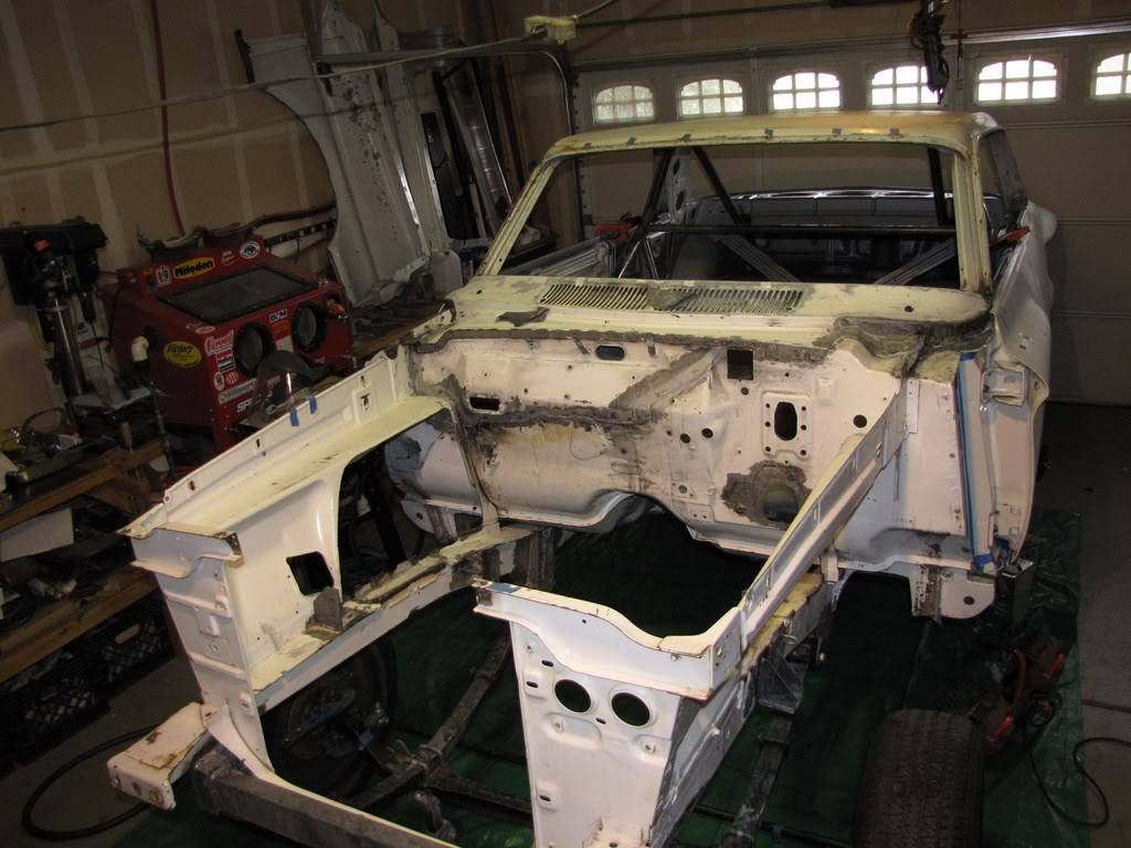

Okay........Time to raise this build thread from the dead. I've got a few years of (slow) progress to bring up to date. So bear with me. Here comes some more posts from the past to catch up to present day.
So.. let's see where I left off. I had the firewall reconstruction done and quarter panel repair and other sheetmetal rust repair patches and stuff done (Check!). Frame connectors are in. (Check!)
So the next thing up is The front axle swap, the cage and some seat relocation/ interior craziness.
The axle swap, cage and seating mods kind of were figured out and went together all at once, since it all fit together like a puzzle - but I will start posting pics the inside first, then move on to the axle/steering setup.
