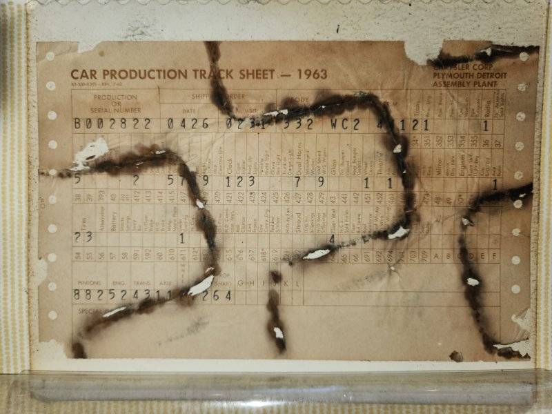

This is the build sheet that came with my car. My VIN is 3331XXXXXX. My car didn't come with a Fender Tag. How do I tell whether this is the correct broadcast sheet for my car? It currently has a 440 in it now so not the original motor. Any help would be greatly appreciated. Thanks.
Check the Sales Order number on the sheet to stampings on the body.
Okay, the number on the radiator core support is 3107051837. Does this number tell you what motor originally came in the car? Thanks for all the responses.
Looks like the engine is 52 on the BS.
318?
318?
I don't think this build sheet is to this car? The numbers on the radiator core support don't correlate from what I can tell.
