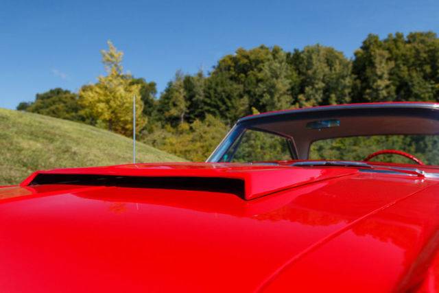

The Hemi scoop would look good. Max Wedge has the dip in the middle. Crossram doesn't matter it's where you put the hole. Don't forget engine is offset so a small scoop might not be centered.:lol:
I was very fortunate to find a same color, similar patina, 64 hood for my car, and put a MW scoop on it.

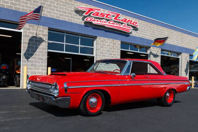

Here's one on a '64. It would look okay imo.

Then max wedge scoop it is.
Didn't hit disagree button but do. Don't have full info but if an air cleaner top could hit scoop because of the dip in the center of Max Wedge scoop. OP could answer that. Do like the look of it.
Post # 5 is Hemi scoop. I think Sled City makes Max Wedge scoops in different heights. Likely + 1" or + 2" would be enough.
