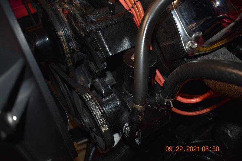

So I had a leak at the PS pump, decided to put some stop leak thinking well it probably won't stop the leak but what the heck, try it anyway. Hell now it's much worst. Off to get the pump rebuilt. Looks like the PS pumps are not available.

Just saw a picture, looks like a federal pump

By looking at the cap, it looks like a Thompson pump, Federals look very similar, but the cap and brackets are different. Your pump also has the large return line. This changed after 1966, with a corresponding change of the fitting on the steering box.

IMO....it looks like the Federal pump, as the high pressure fitting comes off of the ftont of the pump. If it were a Saginaw pump, the high pressure fitting gomes off of the back of the pump. If it were me, I'd remove the pump from the car to gain clear access and to de-grease the assembly. After repairs are complete, refill the system with a good grade of HYDRAULIC OIL, ISOVIS # 32 or # 46 for vane pumps.

I'm pretty sure it's federal, definitely not a saginaw
