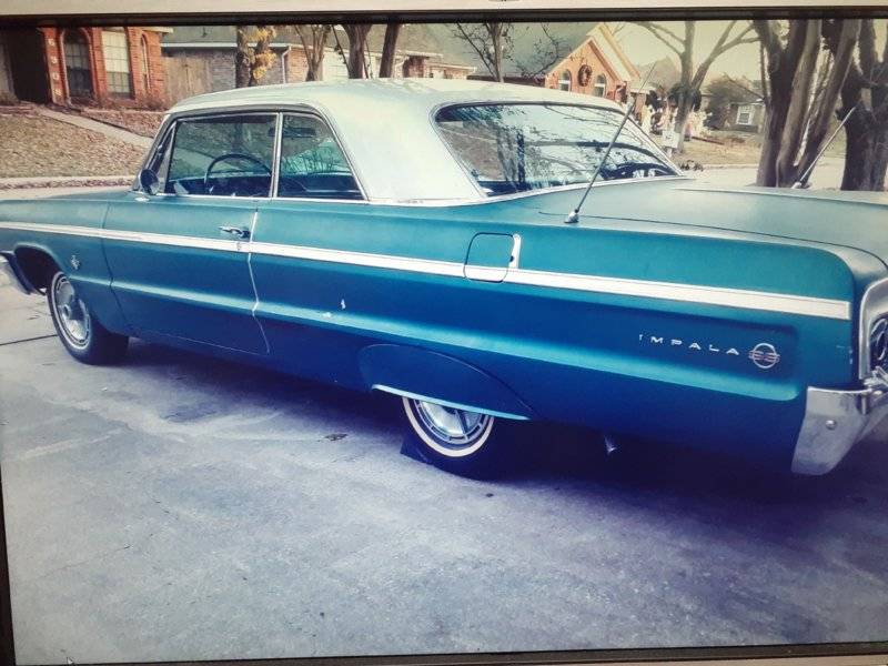

I took a pic of a pic of my 64 ss impala. 64,000 miles. 409 4spd. I'm the 3rd owner.

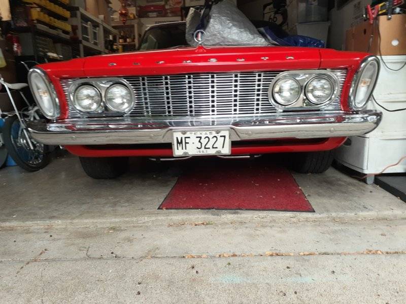

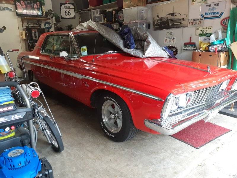

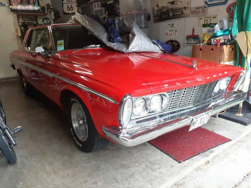

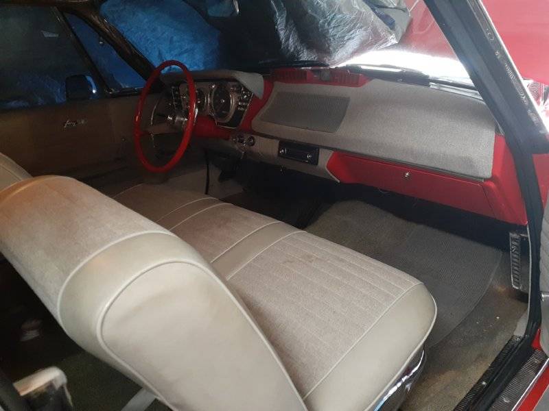

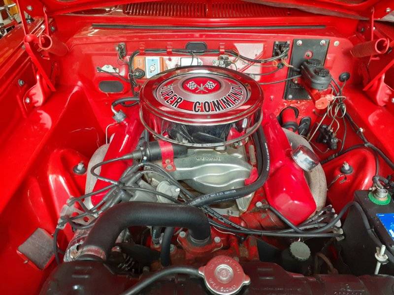

No comments. Good or bad on my car?
Had to step away for a bit. Looks real nice! Wait till you get a load of member's @383man s '63. Looks very similar. You can see by my avatar that I'm into the early "B" car.
