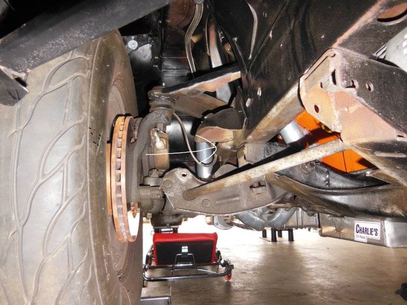

the gas shocks i pulled out on the main body, measure 1.5" and fit no problem,and they were speced for a 63 belvedere, the strange units measure 2 1/8", upper stud mount is off appx 1" from the shock hole with car jacked up, which translates to appx 1/2" of grinding/cutting involved, did not know wheter other manf of shocks, viking, qa1, have thinner main bodys, i will take a closer look at it next week,,,,thanks.
Is it hitting the upper bump stop bracket? A little grinding will fix it.
arrow shows the hit point.

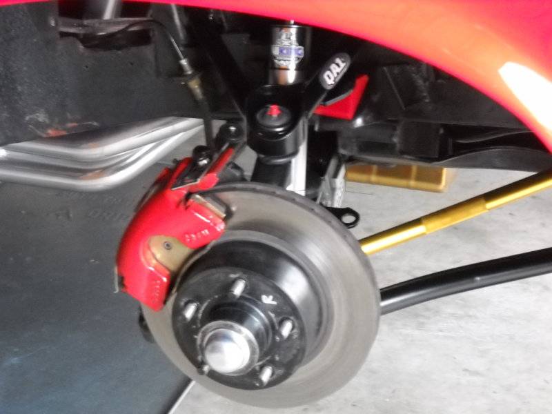

My Viking D/A front shocks: NO upper sleeve... NO interference.

these dont have an upper sleeve either, the main body hits the frame by the bumper stop bracket as per the arrow above. body measures 2 1/8" where as the gas shocks that i pulled off measure 1.5"..i will pull the tire and see what its going to take to notch that frame bracket.
