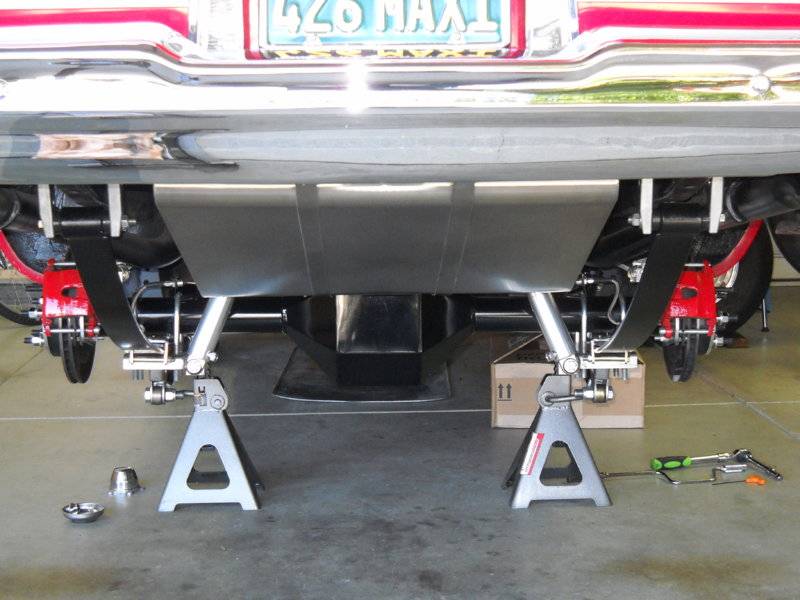

I bought a custom 21 gallon S/S tank from Rick's Tanks in El Paso when I switched over to EFI. I added another strap. The trick would be to find another stock tank with the rear filler that fits the space. Adding another strap was not a big deal.
