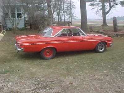

Well it was so nice out today i gave the Belvedere a bath and took a 10 mile cruise.I kinda figured with the gear change the speedo would be way off and it is.It has 4.10 hears with a 28" tall tire and the early 64 style 4 spd.what do i need to do to get the speedo to read accurate?

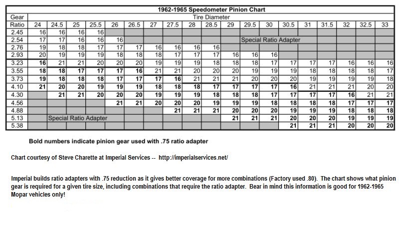

Here is a chart that should help.
The chart shows a 18 tooth with a .75 ratio adapter for 4.10 with a 28" tire.

I was going to quote the same chart. I still have no idea what the ratio adaptor is for. Brewer's has the pinions for the 62 to 65. Bring your wallet. I just replaced mine and happen to have an 18 tooth in my parts box. Message me if you are interested, you are on your own with yhe adaptor.
Mark
the ratio reducers are just a small gear reduction device that bolts to the transmission. they've been around for decades. i use one on my 65 coronet.
I know that this is an old thread, however I want to thank 'ply64post' for posting the 1962-1965 speedometer pinion chart.
I found out that I am running the correct speedometer gear for my 1964 Dodge 440 426 Street Wedge with a A833 4 speed running with 26" diameter tires and 3.91 rear gears, 19 Teeth.

lewtot184---I not sure what you are talking about-.75 ratio reducer?
Could you explain or show a photo?
My 64 Dodge came from the factory with a 426 Street Wedge, A833 4 speed, 3.91 sure grip and a 19Tooth speedometer gear installed.
Do I still need this .75 ratio reducer?
