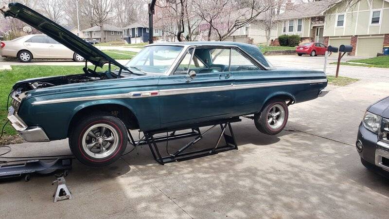

I ordered new park and shift cables back on Black Friday. They arrived late January. Finally got a warm weekend with no rain last week and got the car up on my new hydraulic lift which made it a lot easier to replace the cables. I found that the bolt hole for the shift adjustment was stripped which is why it kept coming out of adjustment. Put a helicoil in it and got my wife to help me adjust the shift cable. So much easier to see what's going on with the pan off.
I am happy to say that it now shifts properly as well as no more transmission oil leaks from the cables or anywhere on the transmission.
