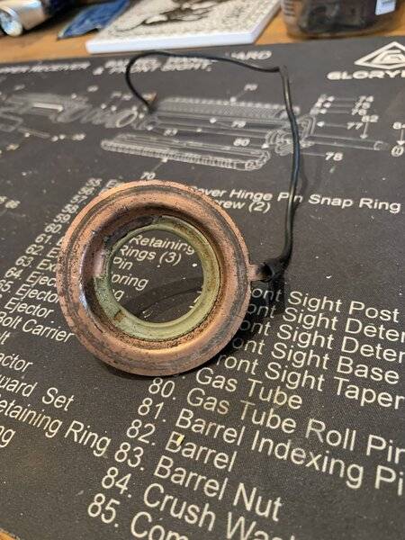

Is there anything I can use to repair the inner sleeve lining? I see they have the whole thing at classic, but if I need to buy another who has them? Thanks!
I had to go to classic for mine for the whole contact. Just put it in today. The horn would not stop blaring. Root cause: the epoxy-based material had deteriorated and created a short to ground. Mine material looked far better than yours but it was still bad.
