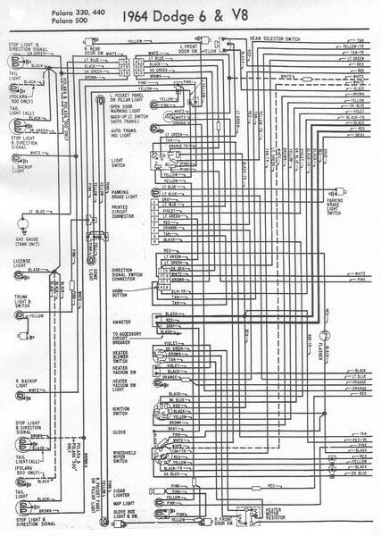

Here are complete wiring diagrams for your 64 Polara.
http://www.mymopar.com/downloads/1964/64PolaraA.JPG
http://www.mymopar.com/downloads/1964/64PolaraB.JPG
Thank you so much!! Am i correct in believing that the black cable going to the relay is supposed to have 12V+ with ignition on?
