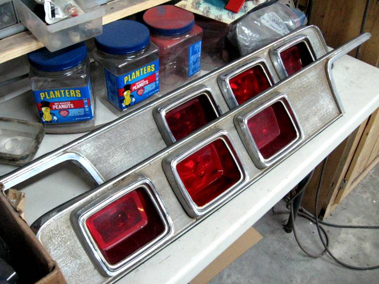

The Polara 500 used a chrome panel that the others didn't which allowed the bezels to lay against a flat surface. I've been told ,but can't confirm that the 330 or maybe 440 outer bezels? where different ,do to conforming to the car's body and not the flat chrome panel. Maybe some of the 330 , 440 guys could clarify.
The 330, 440 tail lights are an individual light! Where the 500s were 3 light assembly The Canadian built cars had a two light bezel similar to the 500 style for the 440 model.
Yes, all three light buckets were joined on the Polara and not separate as the others where. Although i believe there is some slight differences on the outer? light bezels themselves.
The Canadian 440 model is the same as Polara/Polara 500

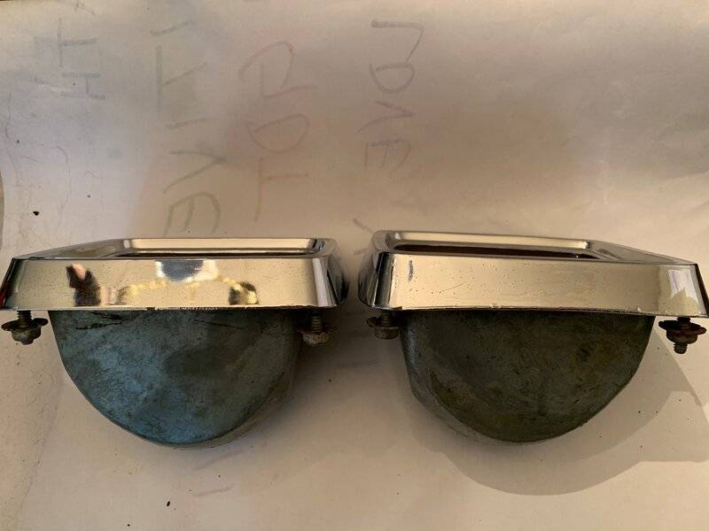

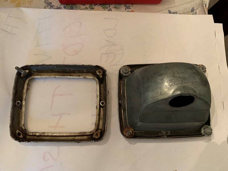

I randomly gathered one of each, the complete one is from a 330 and the lone bezel was from a 500. Other than the mounting, 330 had studs and nuts on all while the 500's had a random mix of studs/nuts and countersunk screws. Both bezels have the same part number of 2424224. I will go grab a complete 500 tail lights and look at the end ones.

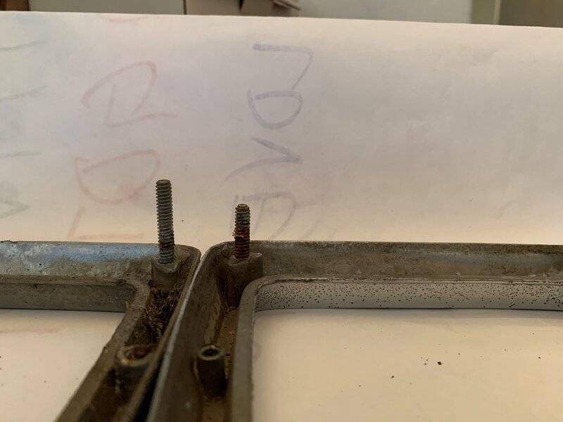

Upon further investigation, and after seeing Jeff's post above, here is some more info. I looked at about 8 of these things and there are some differences. The curved end pieces did have a different part number 2424222 and there is a photo showing those 2 at a different angle. The stud lengths on the 330 versus the 500 were about 3/8" different. 330 at 5/8" and the 500 at 1" and there is a photo of that also.

There are actually 3 different square bezels. There is one that is flat on mounting surface to mount on larger chrome base on Polara and Polara 500 (and Canadian 440). This would also be used for inside tail light that mounts on flat surface on body of 330 & 440. There are also separate left and right curved bezels to match the slight body curve when these are mounted directly to outside position on body of 330 and 440 U.S. models. Reproductions of each are available from Jim Kramer.

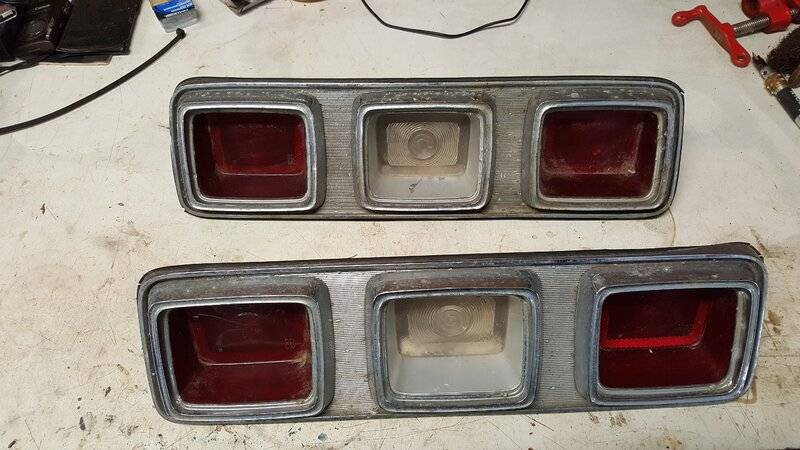

These were the lights that came on my '64 50th Anniversary model. Originally the center light was the backup light. I changed the center lens and converted the lights to sequential operation.

A little known fact: Dodge had originally planned on the Polara 500 to have 3 red tail lights on each side, instead of red, white, red, but this got dropped before production. The factory parts manual shows the large base plate with 3 dark (red) lenses for Polara 500. The factory shop manual shows a separate, different 3 tail light circuit for Polara 500 in body wiring schematic. In addition, there was different body trim planned, with sill and wheel well moldings similar to '63 Polara 500 or '65 Coronet 500. The wider center trim moldings were to be eliminated as well, but this too was dropped.
