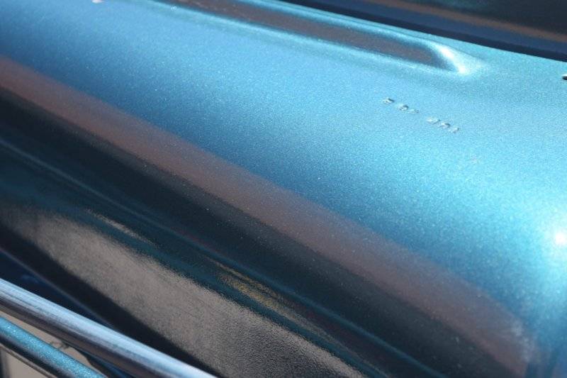

Here is Dark Turquoise I am painting the wife Dart Ragtop tomorrow. Yes the turquoise colors get really confusing... I know as I was researching for the Dart.
Also here is the dash I restored with what I believe is medium and dark turquoise. I had the original matched at the local auto paint store.

Here is Dark Turquoise I am painting the wife Dart Ragtop tomorrow. I have not heard the term "Light Turquoise" before. It is usually called Aqua for the light. Yes the turquoise colors get really confusing... I know as I was researching for the Dart.

I am. I can't even tell you how many spray out i've done and still can't decide on one. I even got a bunch of those original paint chip pages for all different 60's mopar turquoise colors but due to their age there off also so real help there. The more i looked into it the more it got confusing. Same codes called med and dark ,different codes called medium but for same year,different branch of mopar. The factory codes / names simply don't work ,you got to go off of the paint companies codes and even then sometimes the formulas are off compared to todays paints.

That's a great color ,do you have the paint manufactures code number for that?. To me that's a real nice medium shade turquoise . I keep bouncing between a medium shade and a lighter shade. Can you post some pictures of the car when you get it finished?.

It is a nice color. If you look up 1964 Dart on paintref.com they used a color called med. turquoise on the Dart and 880 cars. If you cross ref. that code it was also called "light turquoise "on other Dodge cars of the same year and was also called "Silver turquoise " on Chrysler cars same year. I just have to make sure i don't get this med. turquoise mixed with the other med. turquoise or the other, other, med. turquoise or the dark turquoise named med. turquoise or Heaven forbid 68' medium / Dark turquoise and we can't forget about Bahama turquoise ( really med turquoise on a different model) or let's throw in a "Peacock turquoise" to keep 'em all honest, lol. My head hurts.

Dark is L and Medium is K in the chart above.

I have not tried a PPG jobber but your gonna find that virtually no one has the color code for the turquoises anymore. They will have to try to match it from the paint chips that most places have so it won't matter what you call it you will have to point to it in a book and see how good the guy behind the counter is at matching. I had the original colors on the dash so he scanned them with mixed results. If you want either of these two colors I can tell you who to call to get Automotive Arts Motobase (excellent paint). They actually got the factory (AA) to dig through the archives and found the dark formula but the medium Chad sent a number of samples and we got it very very close.
