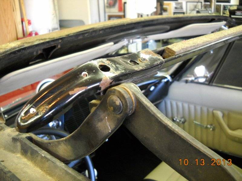

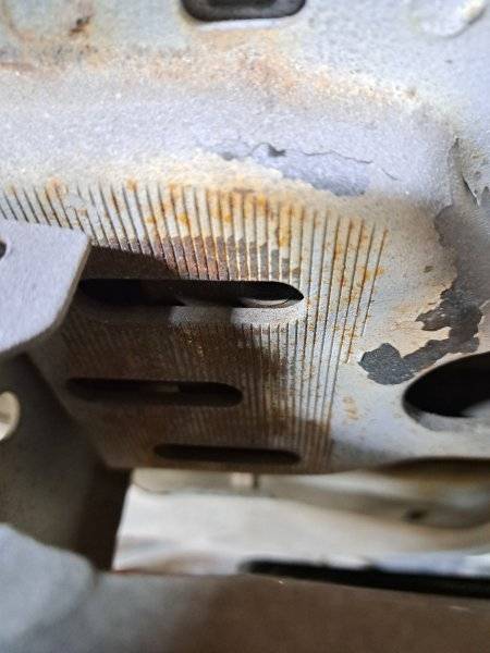

My 1964 Fury Convertible project is slowly coming together. The top mechanism was in pieces and I have mostly figured how it goes back together thanks to some pictures in my manual and online. Could anyone give me a picture of the 3 hole adjustable brackets that attach the top mechanism to the body? After going through all my boxes I don't think I have those two brackets so I might have to make some. I did find the rear 2 hole brackets :) I guess the biggest thing I need to know is the thickness of the bracket and where the x-link for the top attaches so that the geometry is correct. Does it attach to one of the three bolt holes? Thank you for any info available.

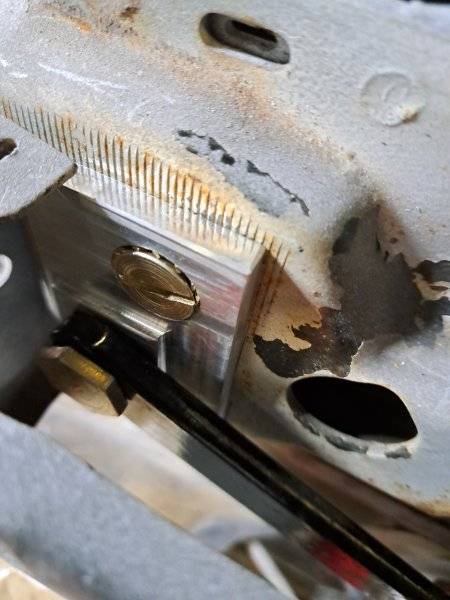

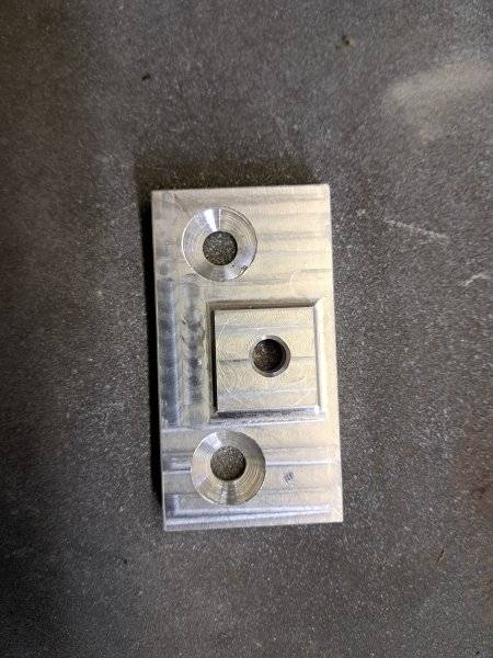

Thanks again for the pictures. I made a couple brackets today. I think they should work well!

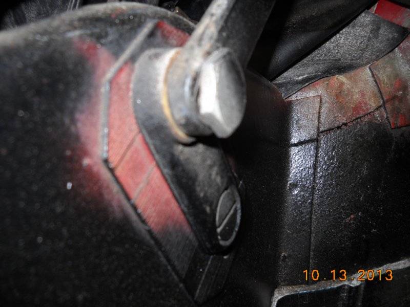

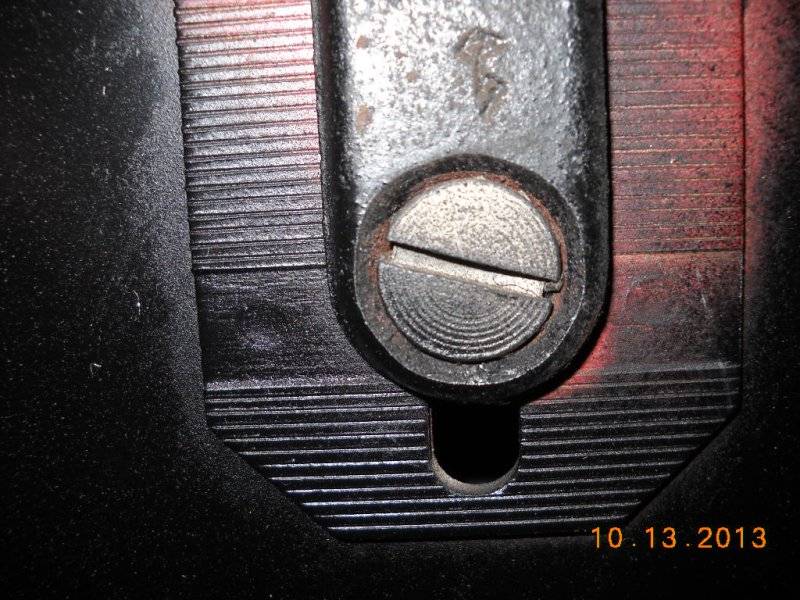

I found a few pictures of my 63 Fury that might help you as well...

Whoops! Looks like I'm a little late to the party. Your pieces look great!
