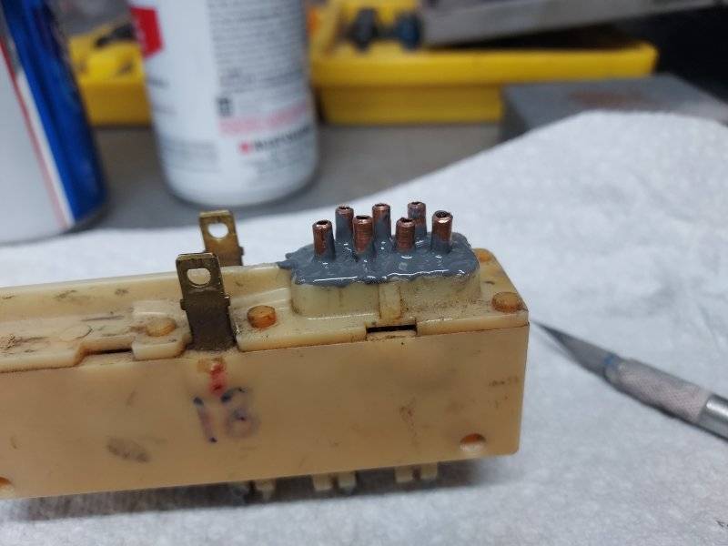

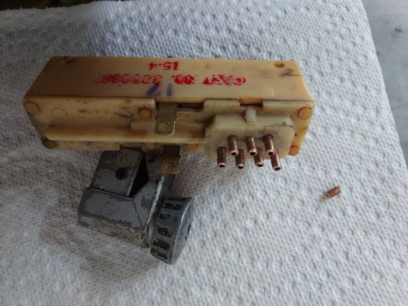

I rebuilt my own heater control. Took out all the old plastic pins and replaced them with copper tubing. They are press fit and I added a little JB weld insurance. Not all that hard. Be careful not to drill to deep as there is a "slider" under the holes that direct the vacuum. when you push the buttons.
I rebuilt the valve in my 62 300 the same way except I used Aluminum or steel pop rivets after removing the shaft / pin from the rivet. You will have a flange on the rivet body to work with.

Sorry for the late reply. I kinda did the same thing. I’ll de starting the car soon so I’ll see if it works. Thanks for the reply.
