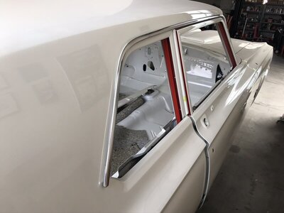

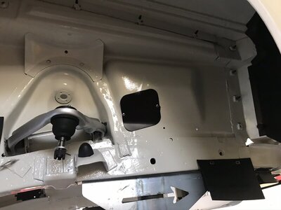

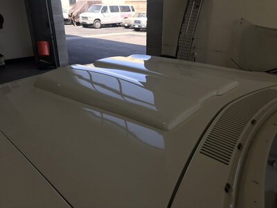

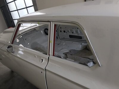

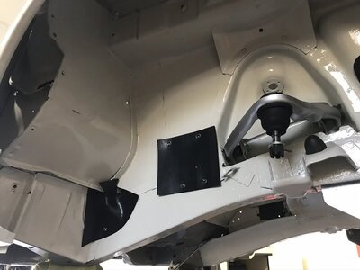

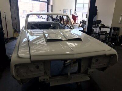

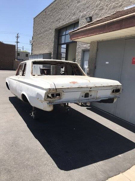

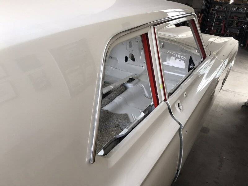

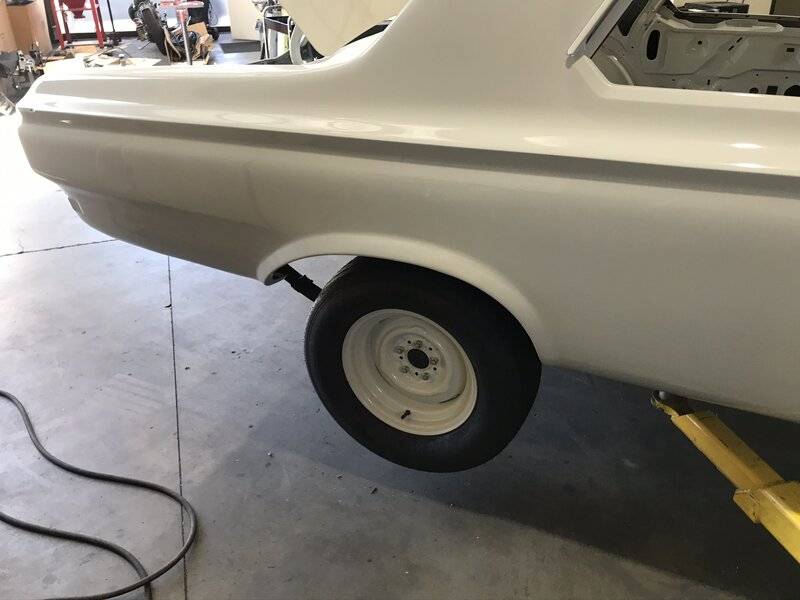

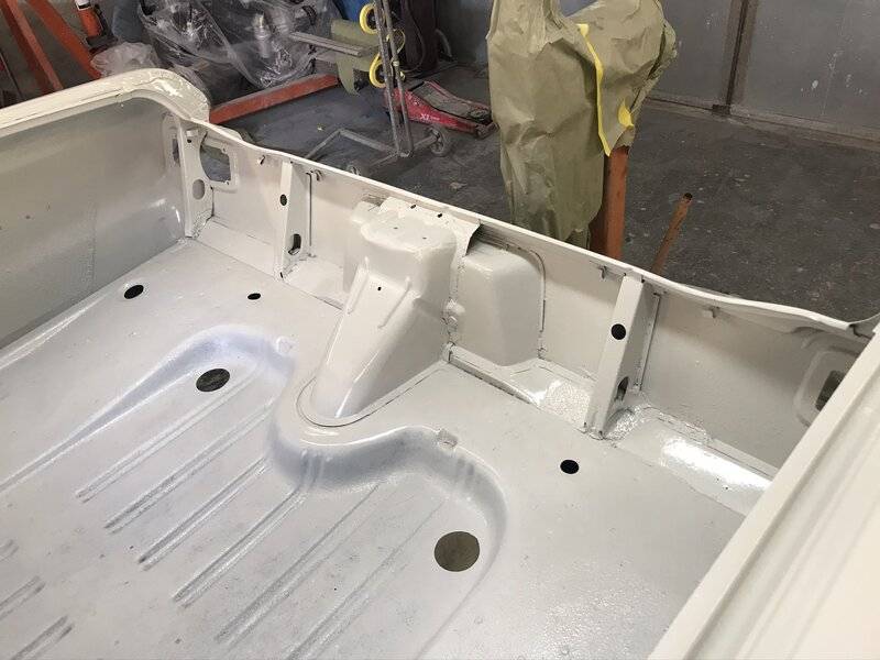

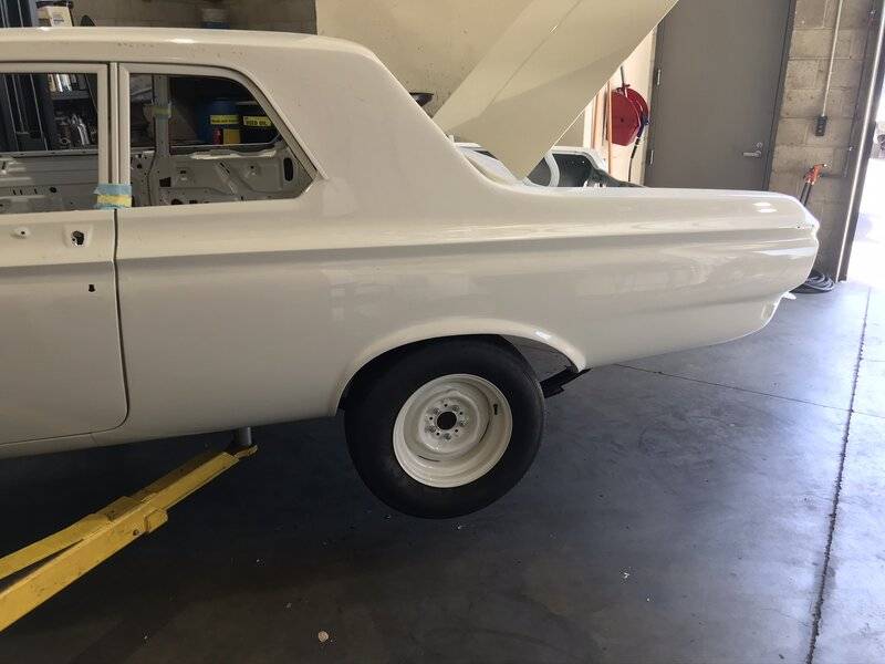

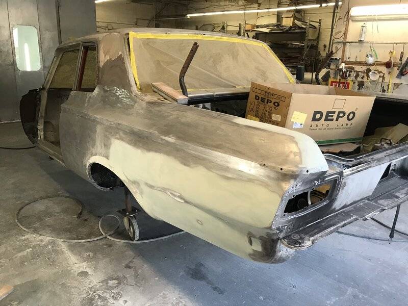

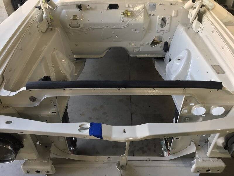

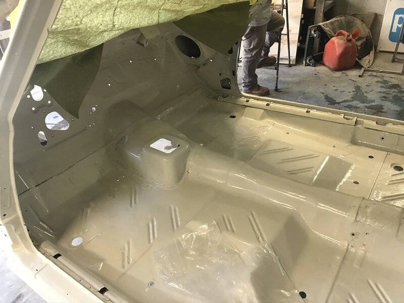

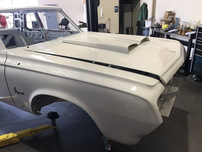

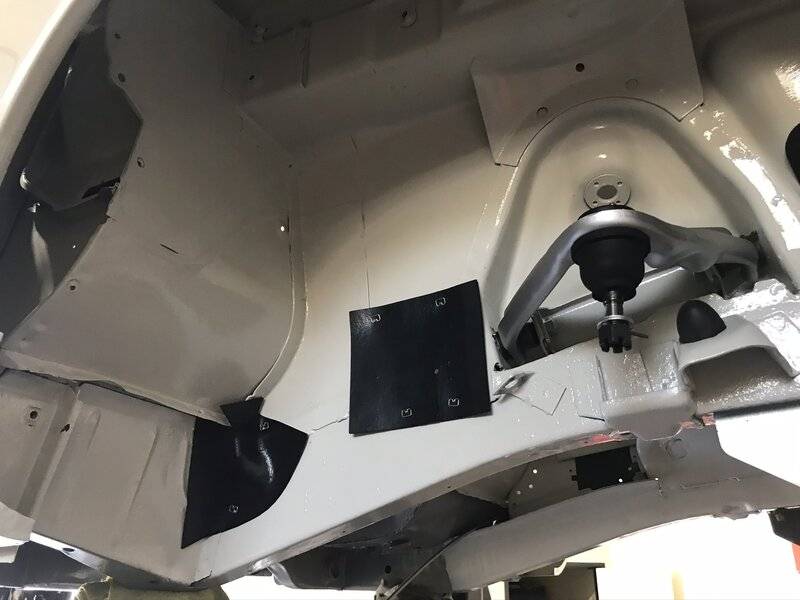

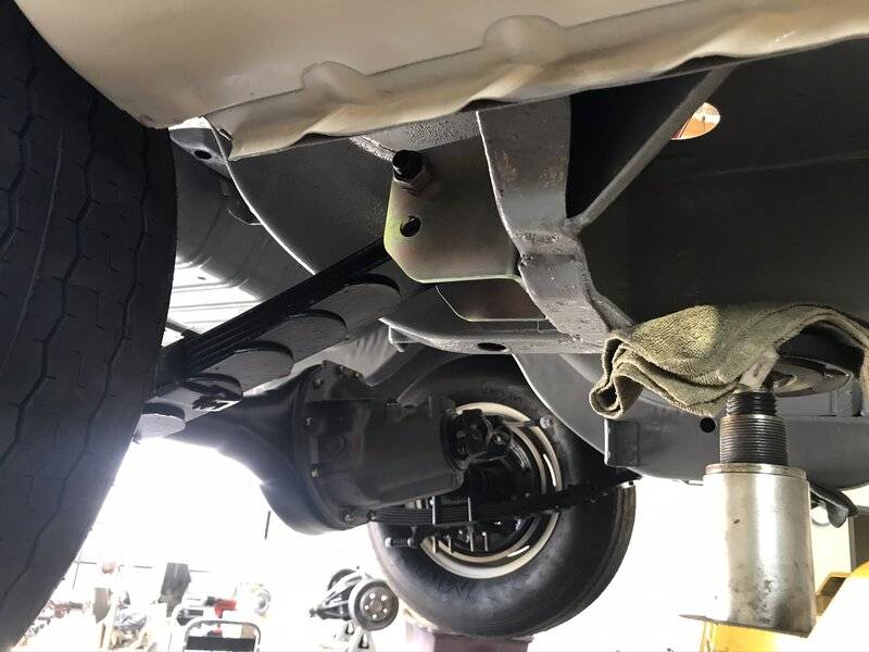

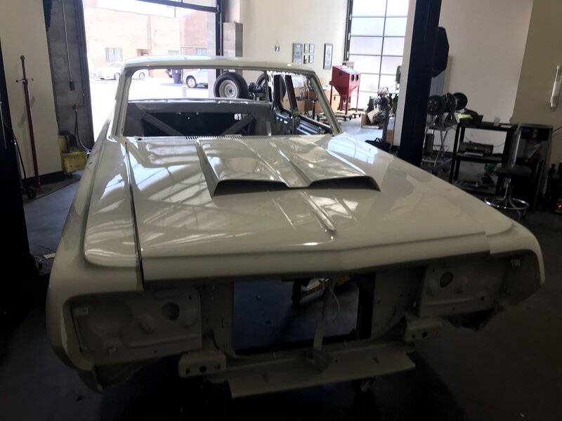

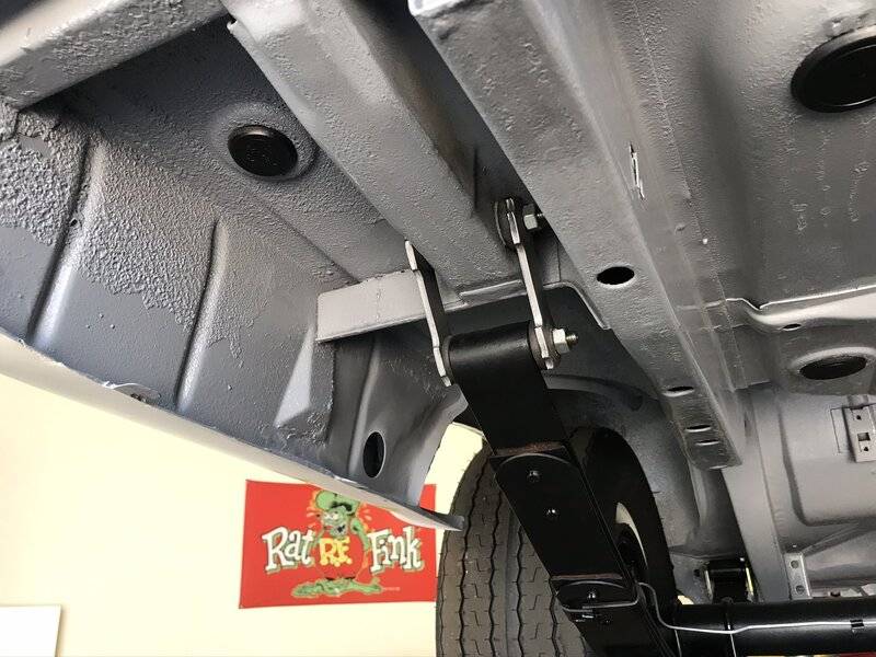

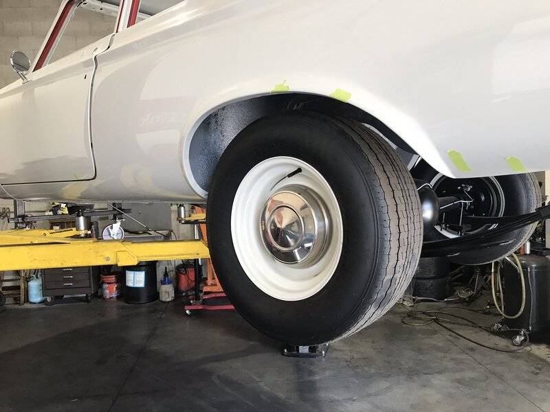

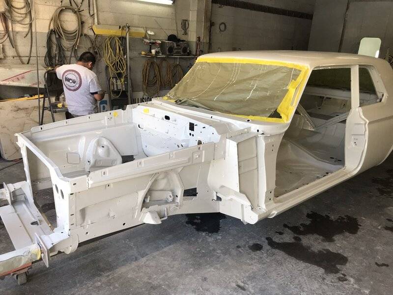

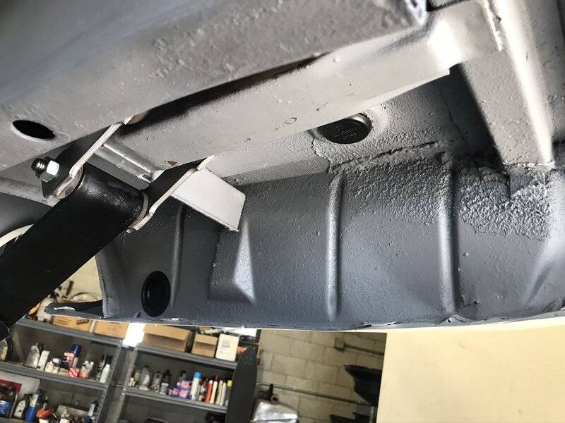

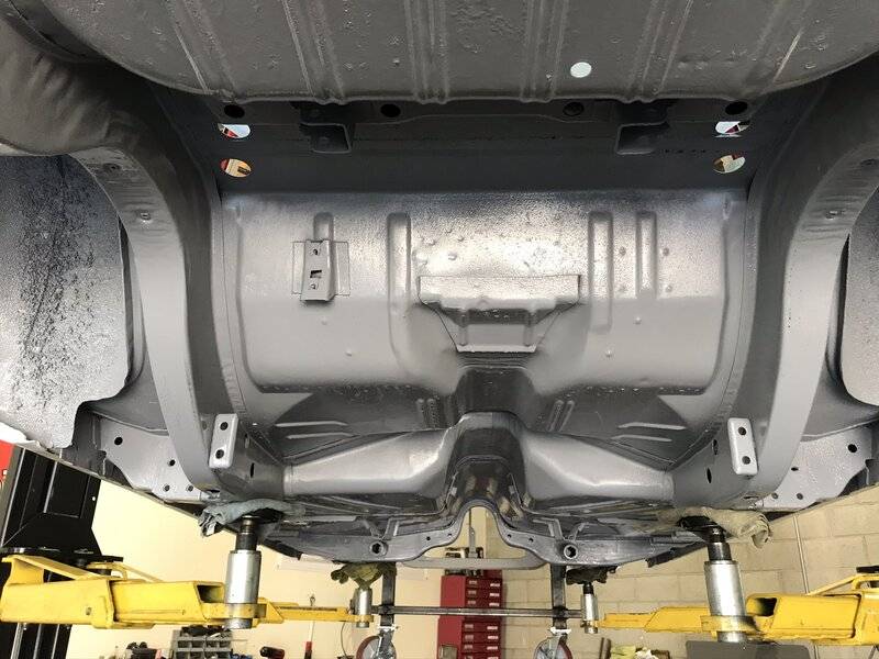

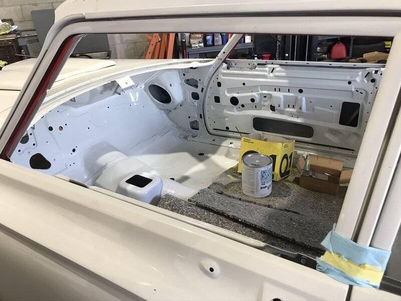

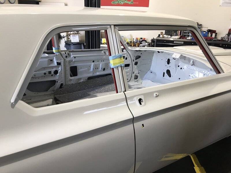

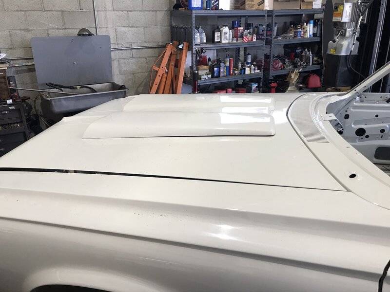

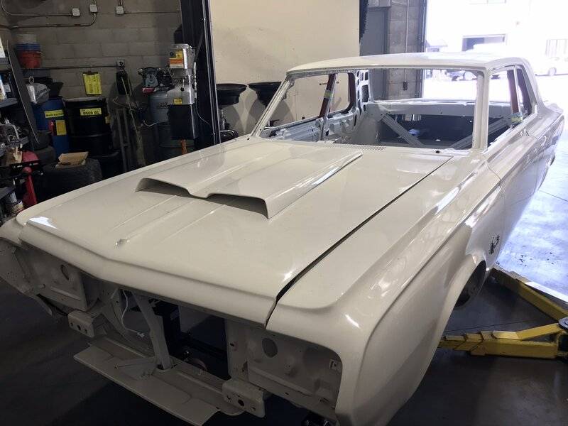

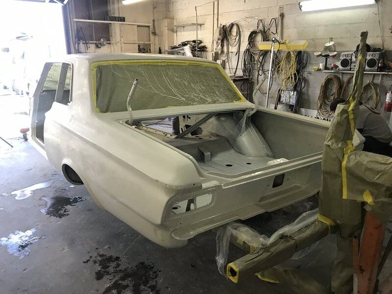

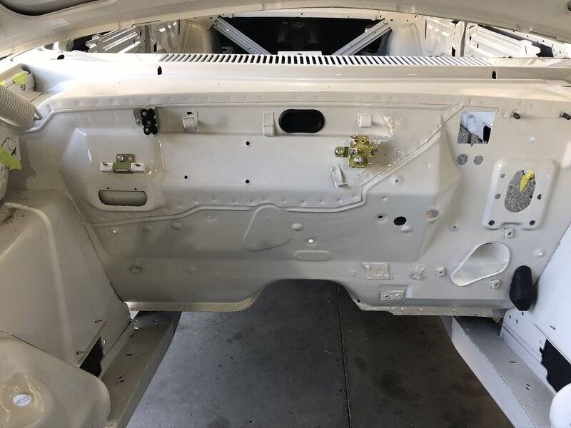

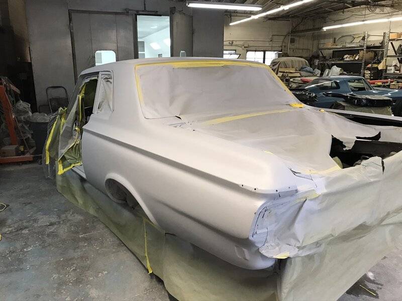

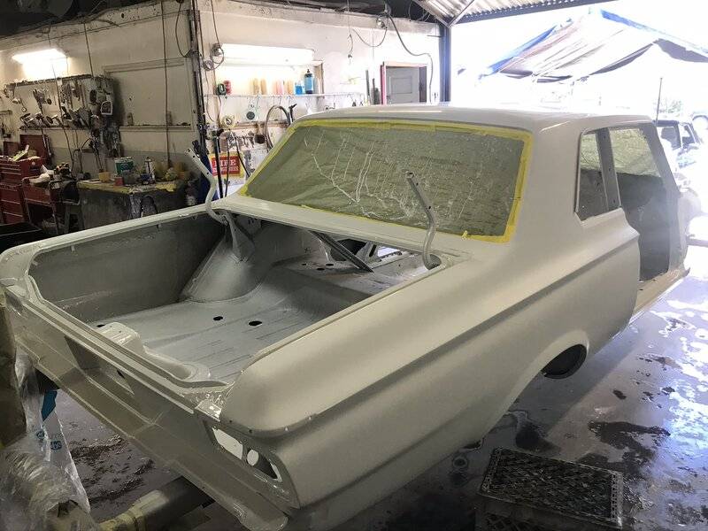

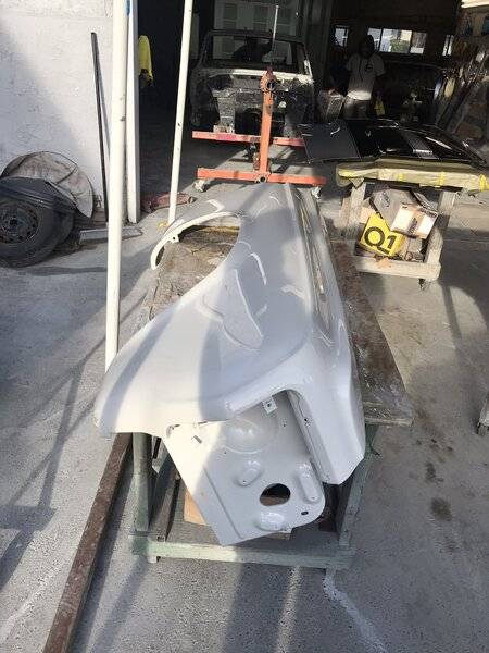

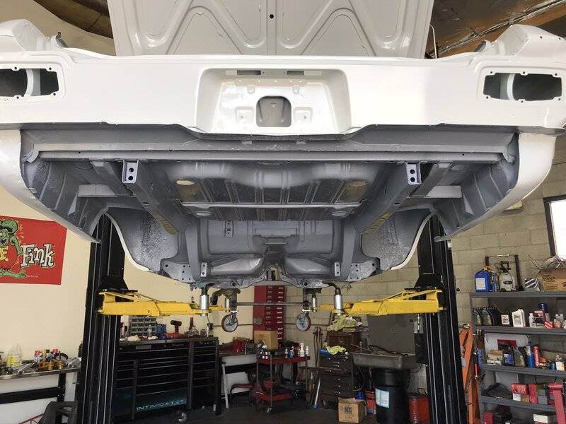

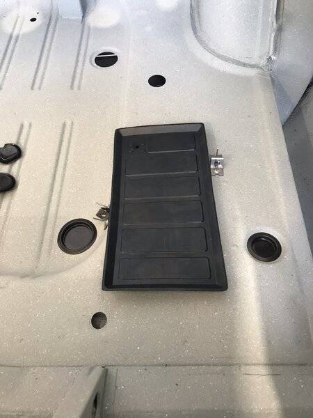

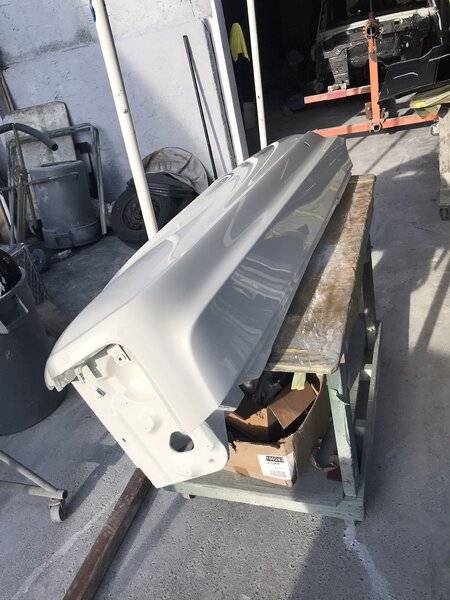

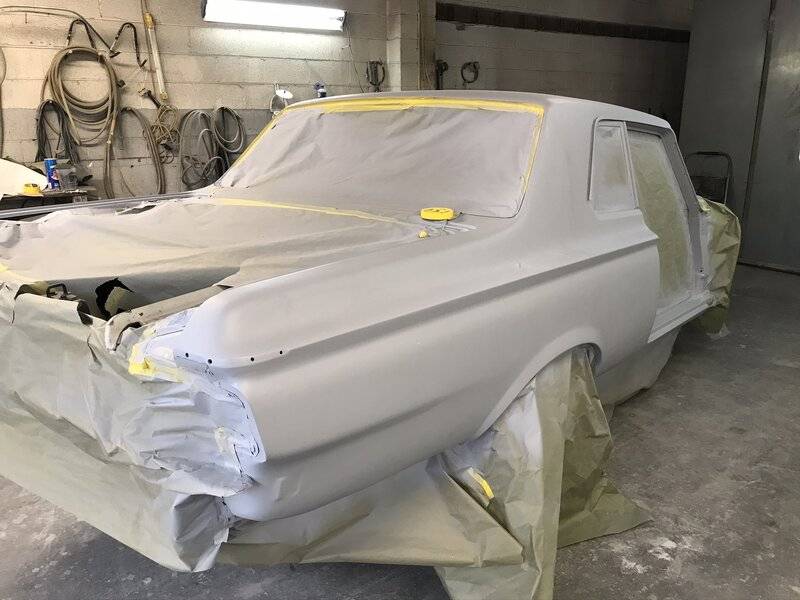

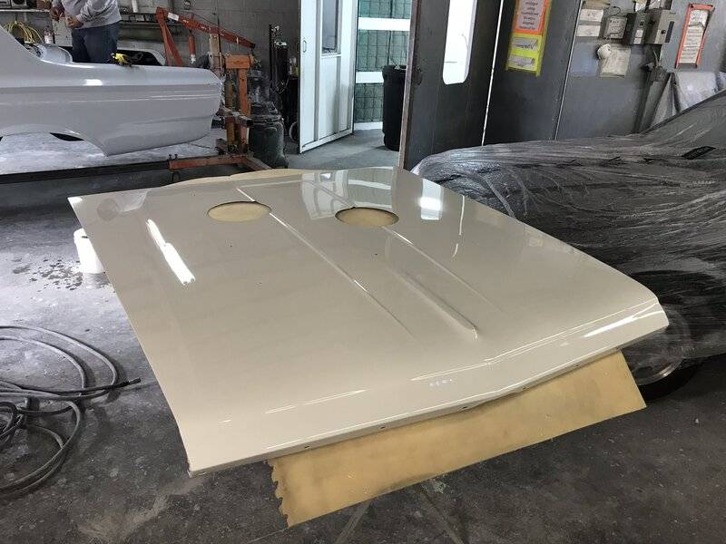

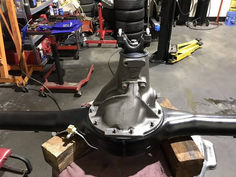

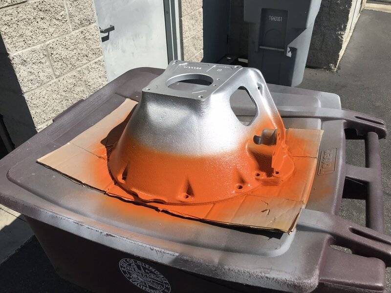

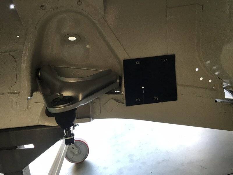

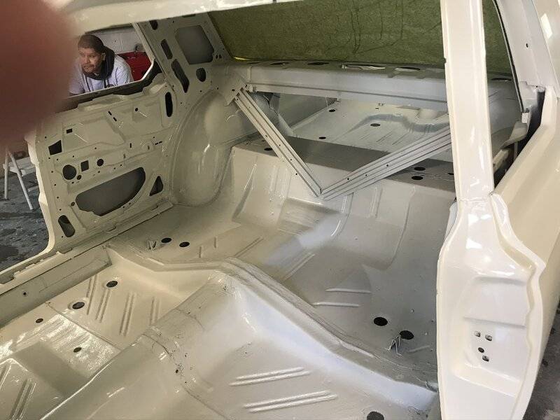

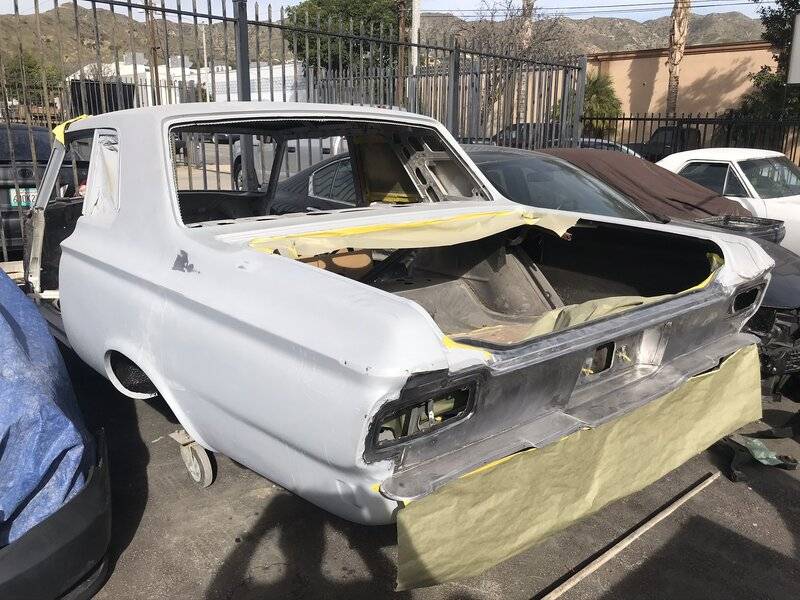

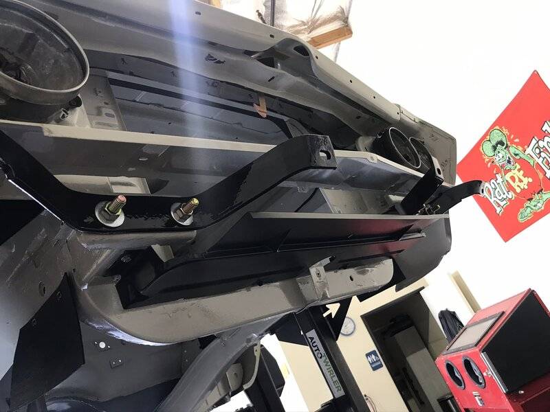

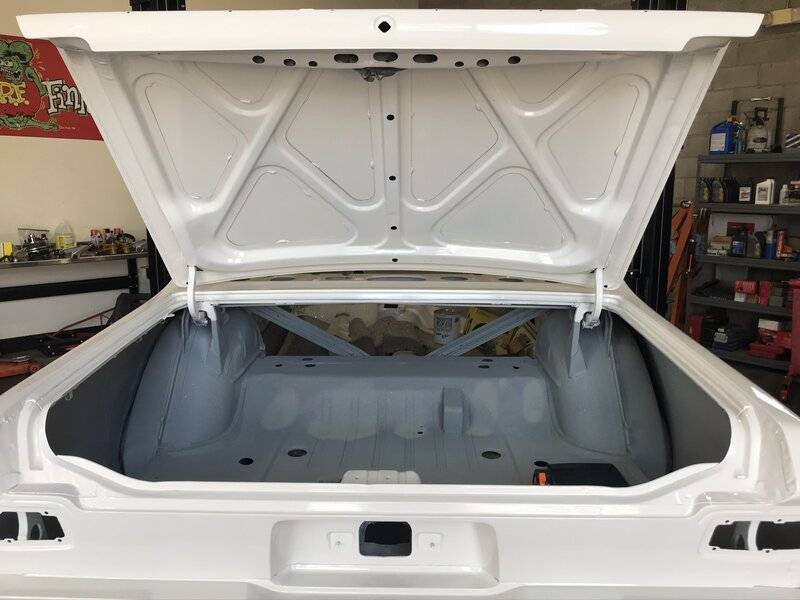

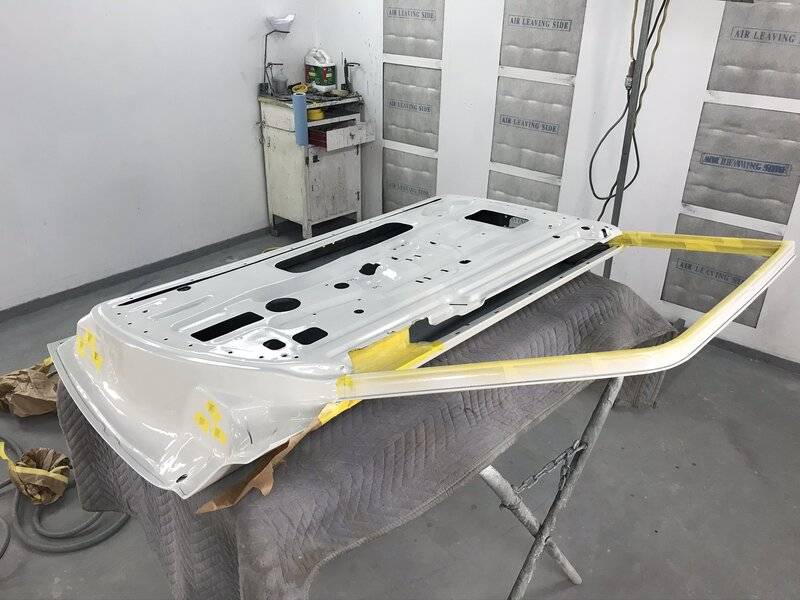

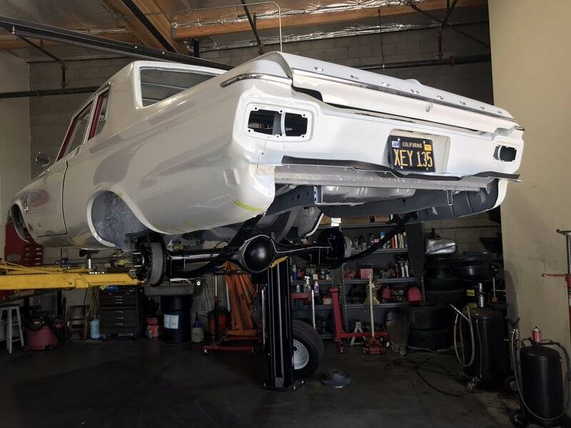

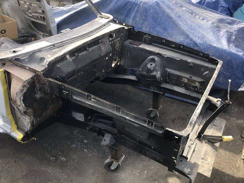

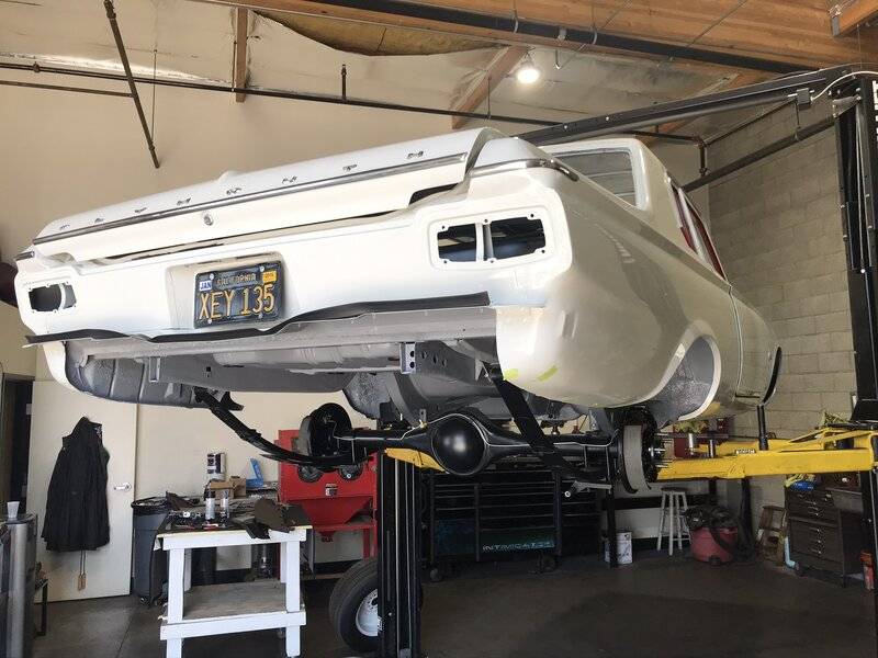

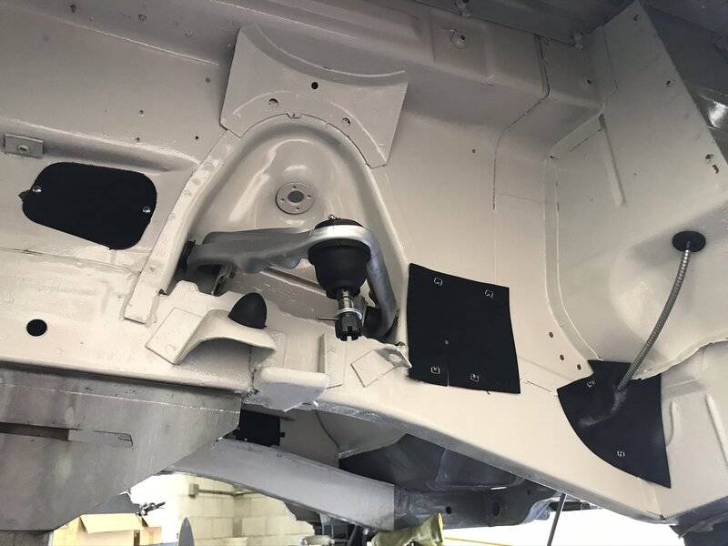

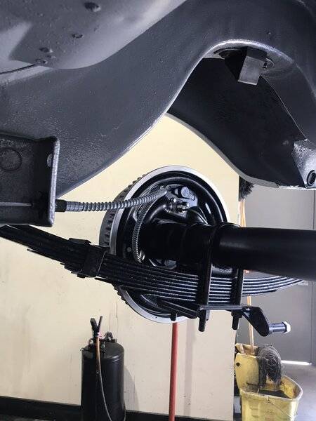

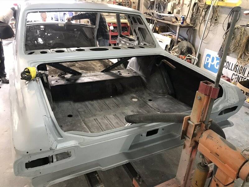

I'm posting my 64 Plymouth Savoy build. Purchased this car 5 years ago on eBay. Los Angeles plaint built car shipped to Jerry Reid's Chrysler/Plymouth dealer in Glendale Arizona. When I purchased it, the pink slip was still in original owners name. Had no engine or interior except bench seat and rear seat. Original 6 cylinder 3 speed column car. Enjoy the pictures!

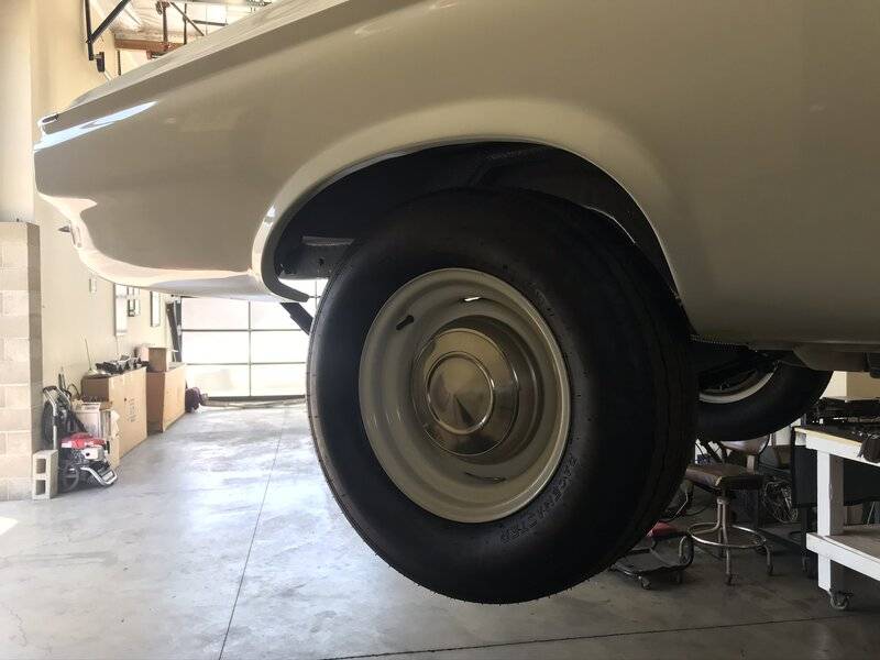

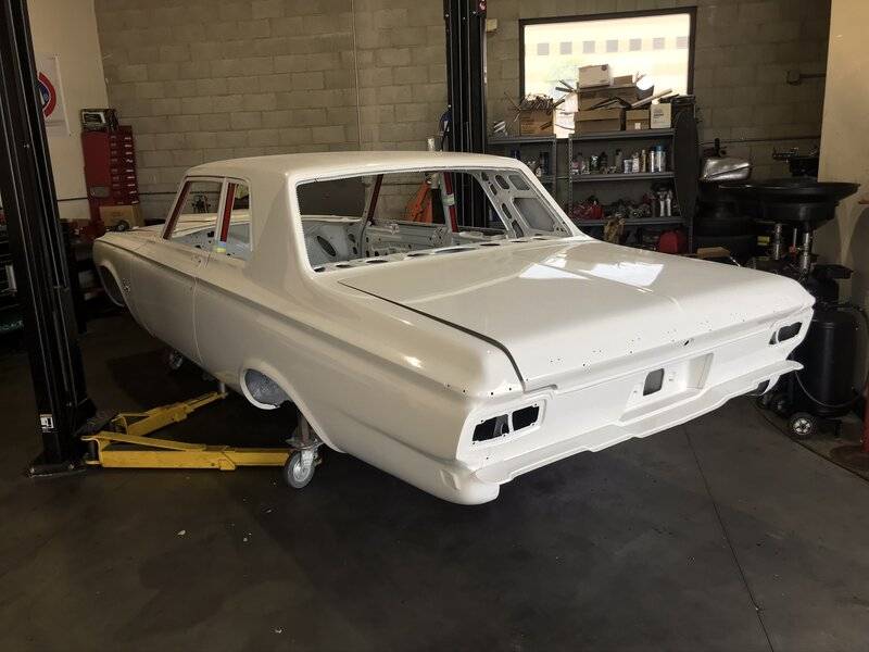

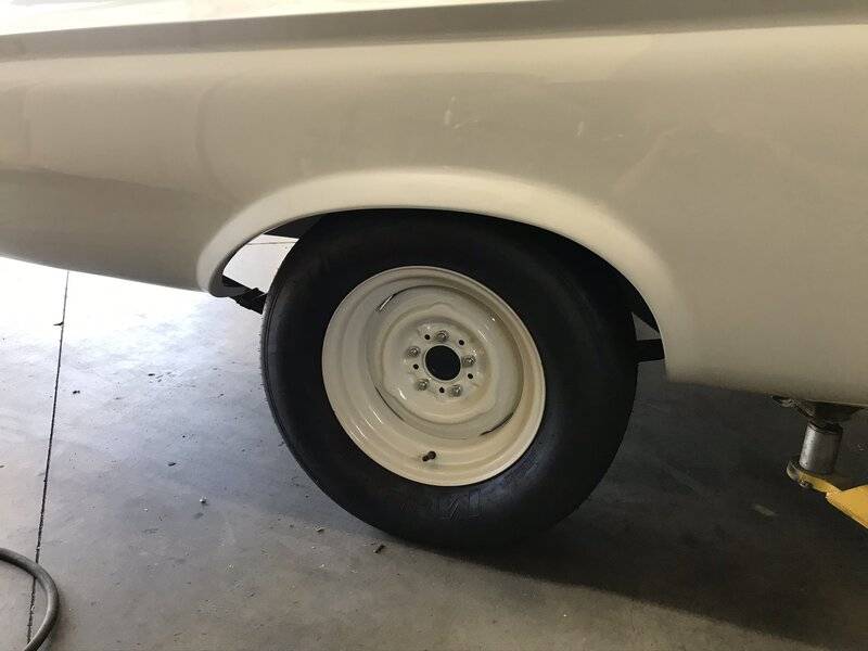

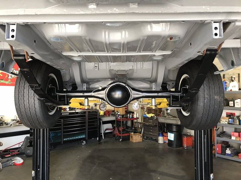

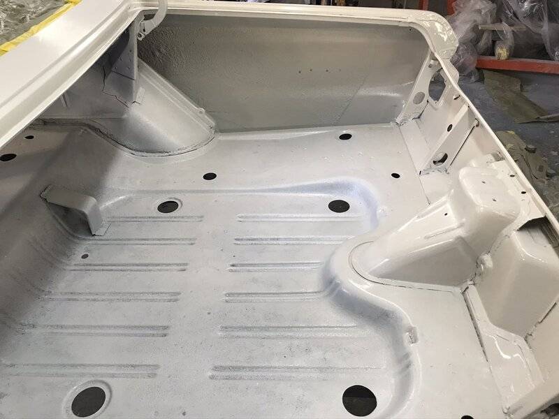

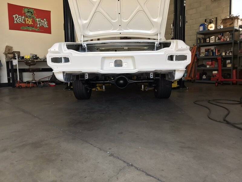

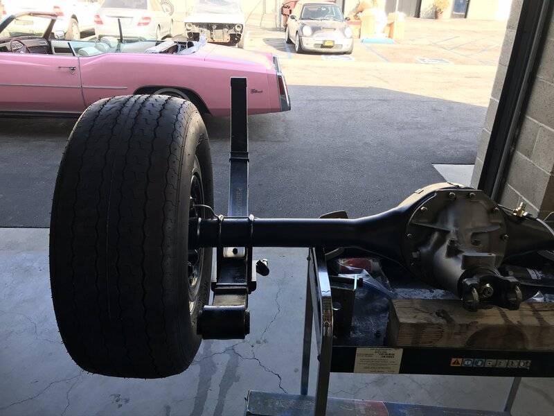

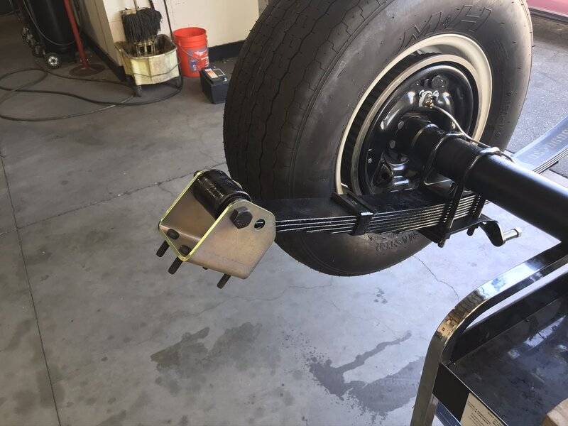

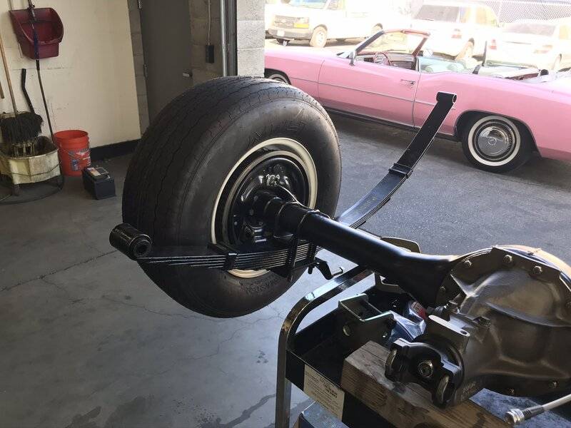

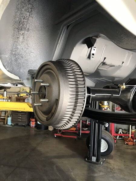

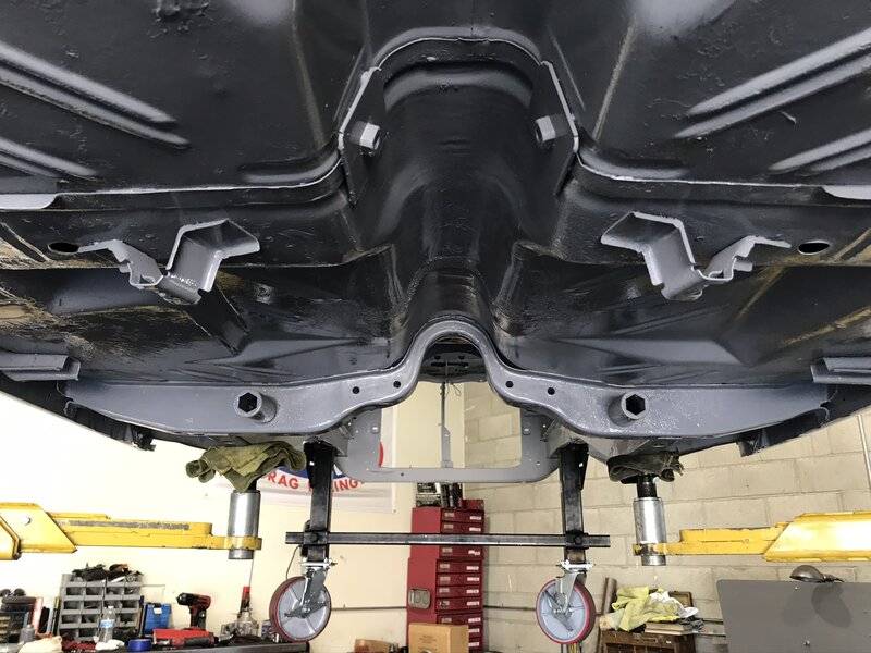

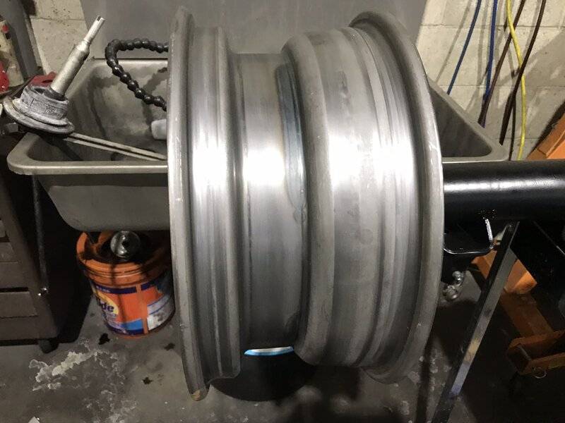

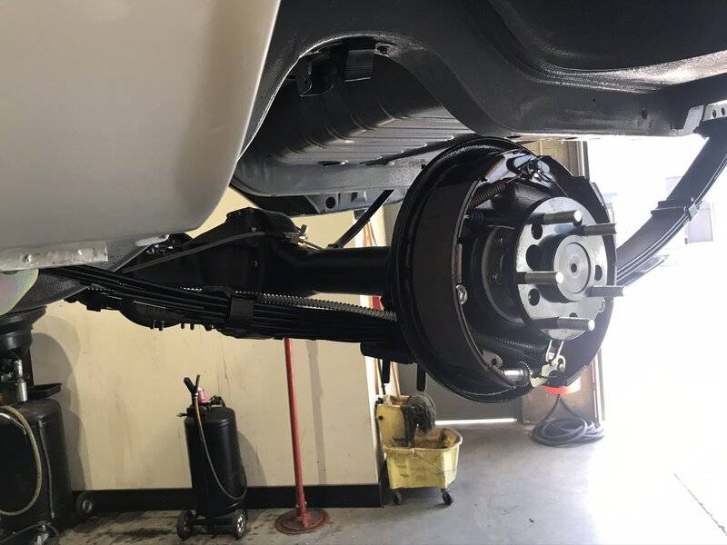

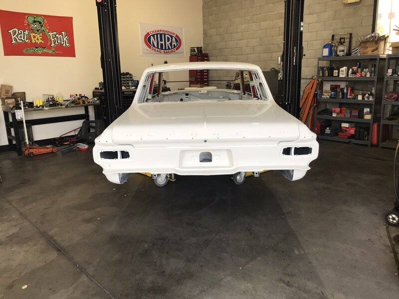

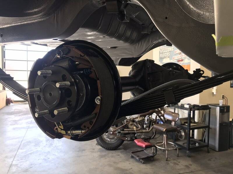

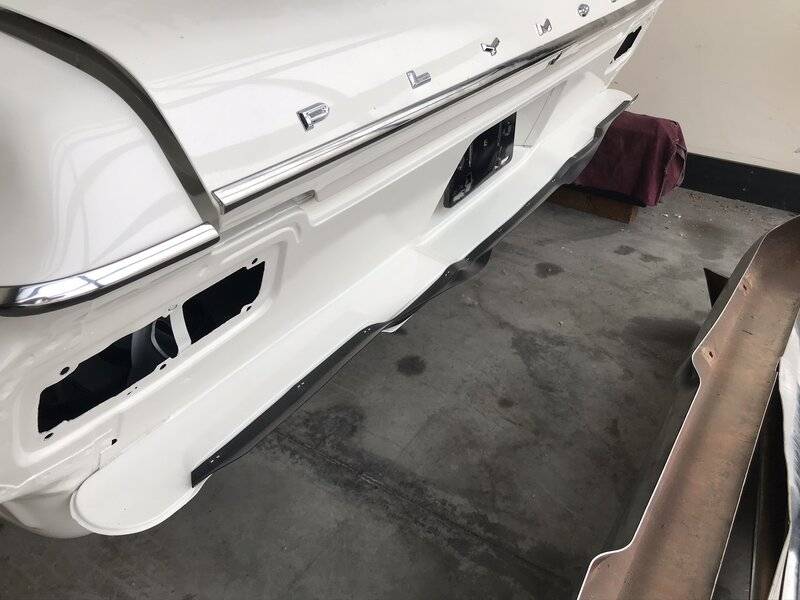

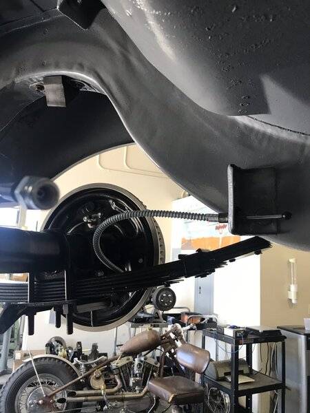

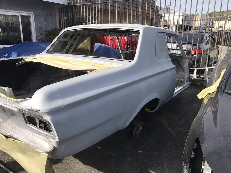

I stripped it down and made caster wheels
IMG_0676.jpg IMG_0687.jpg IMG_0700.jpg IMG_0715.jpg IMG_0760.jpg IMG_0762.jpg

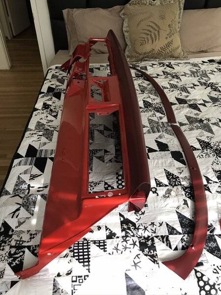

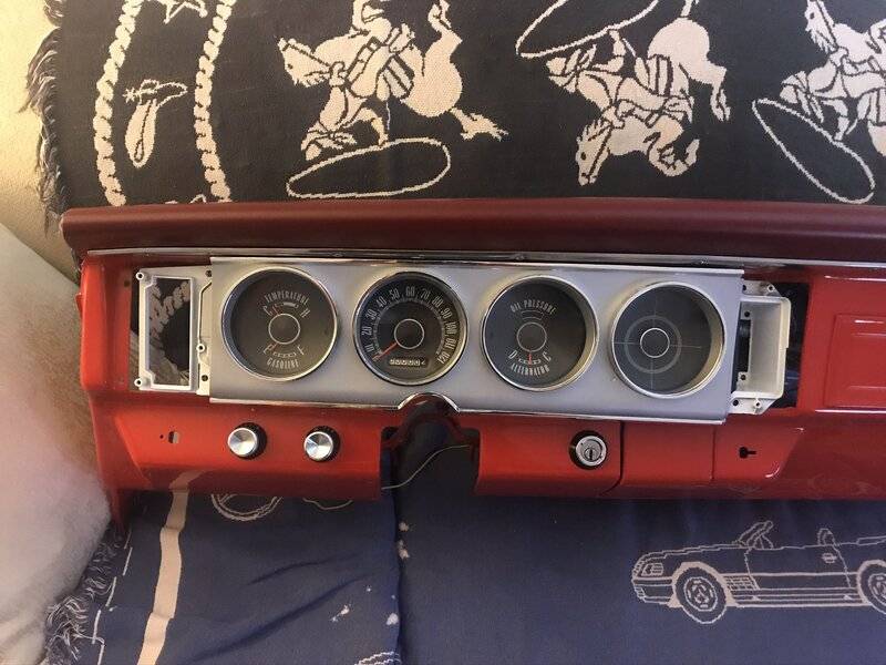

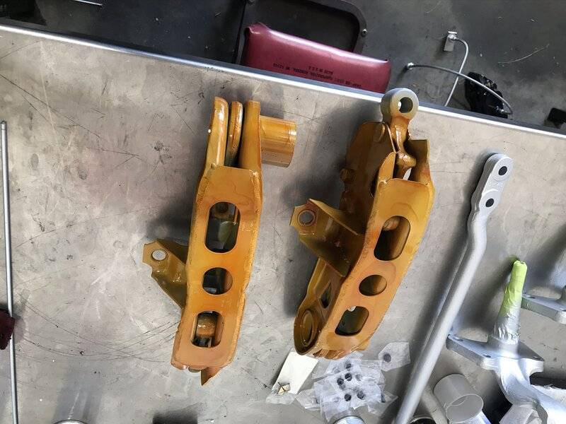

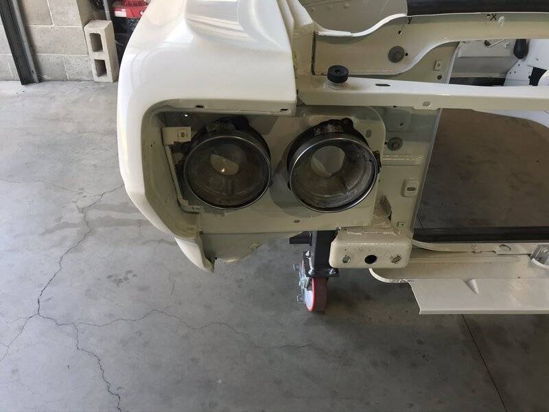

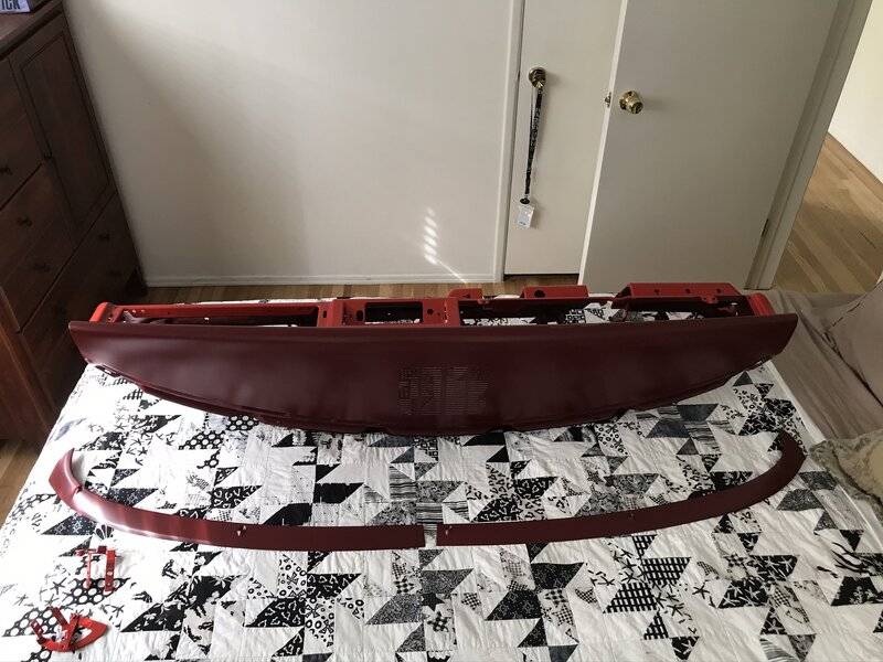

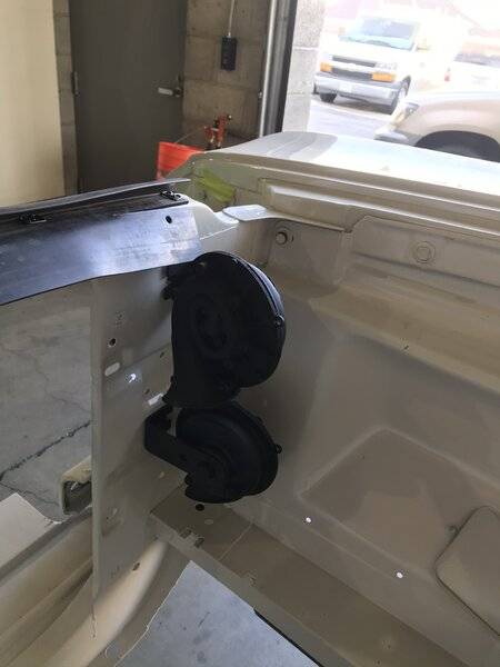

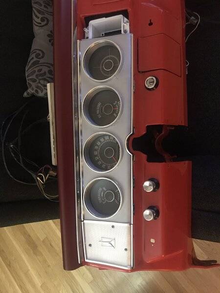

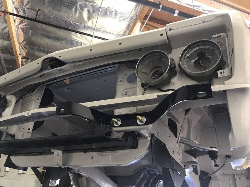

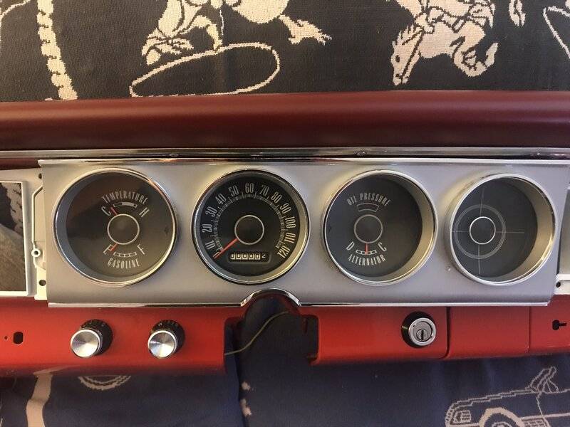

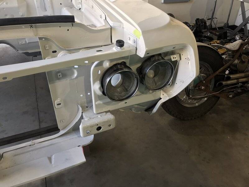

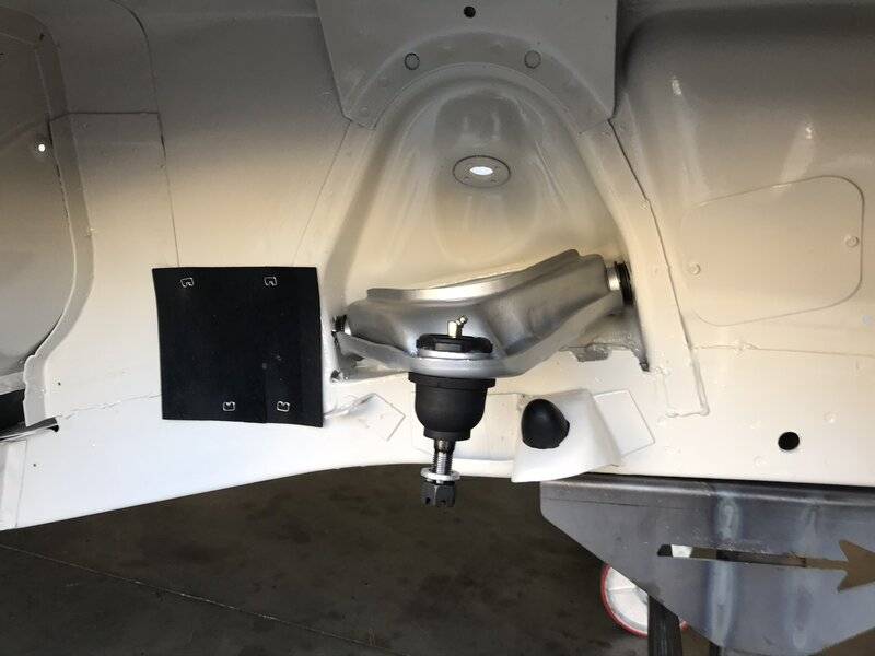

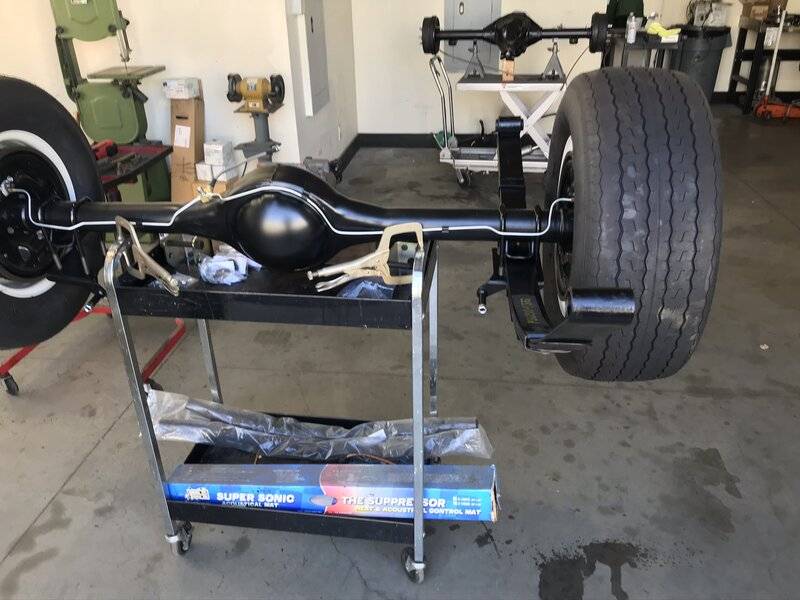

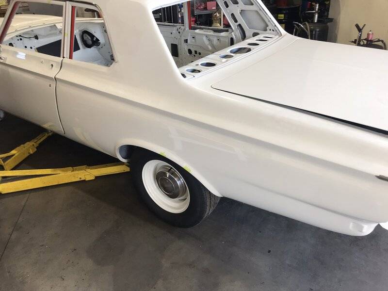

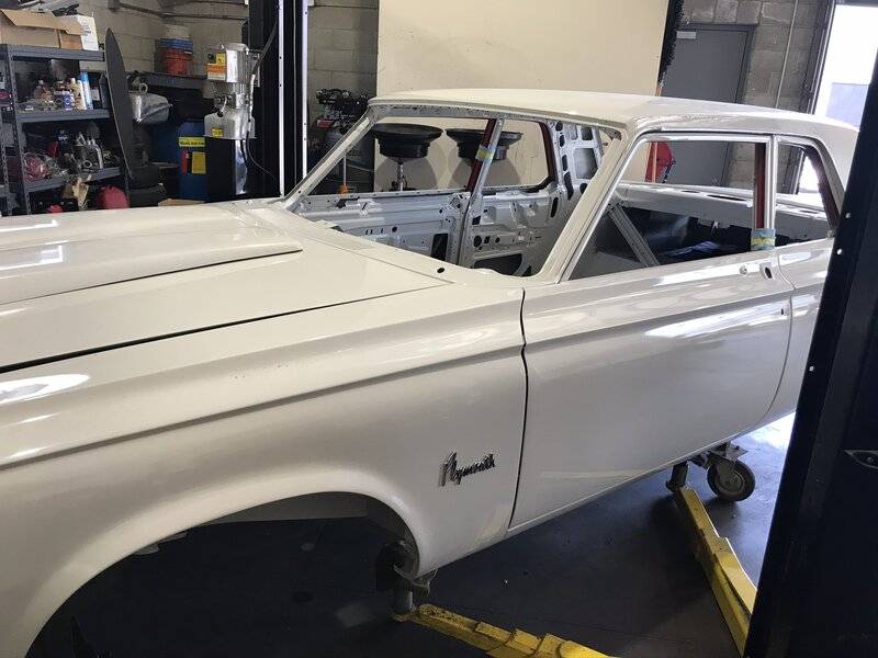

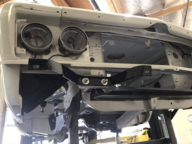

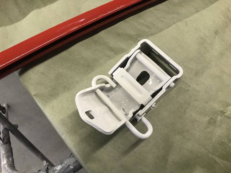

The head light light assemblies and harness is all the once off the car just cleaned up. The horns are original and function properly
IMG_1117.jpg IMG_1118.jpg IMG_1119.jpg IMG_1120.jpg IMG_1121.jpg IMG_1122.jpg IMG_1123.jpg IMG_1124.jpg

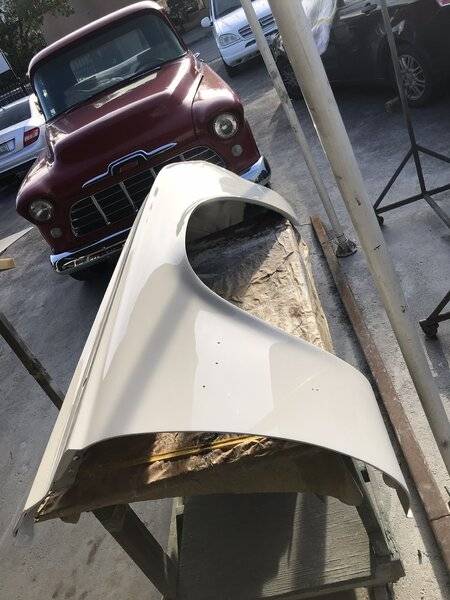

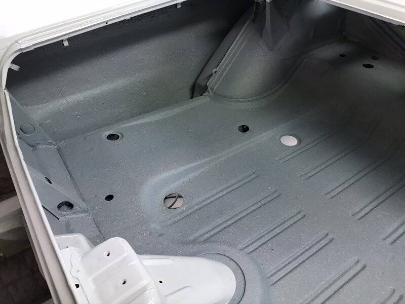

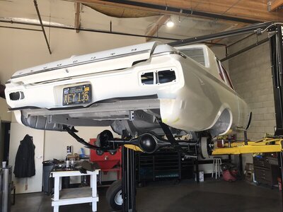

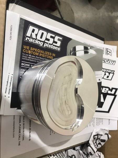

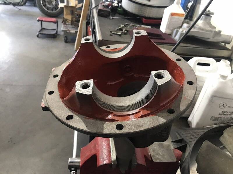

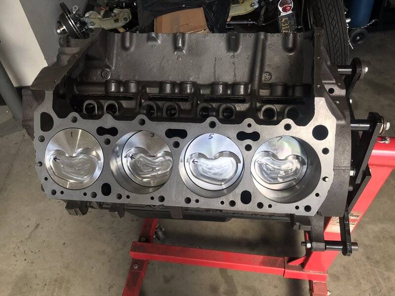

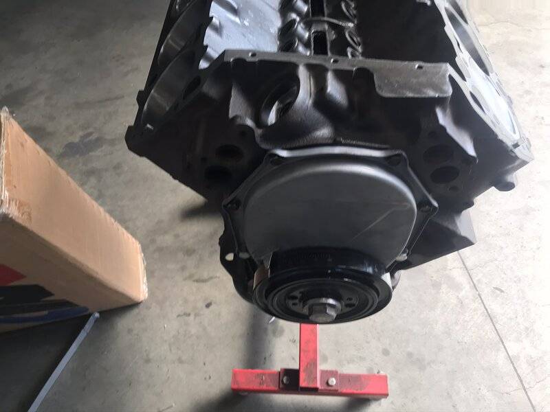

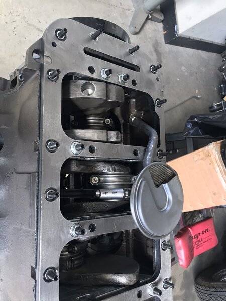

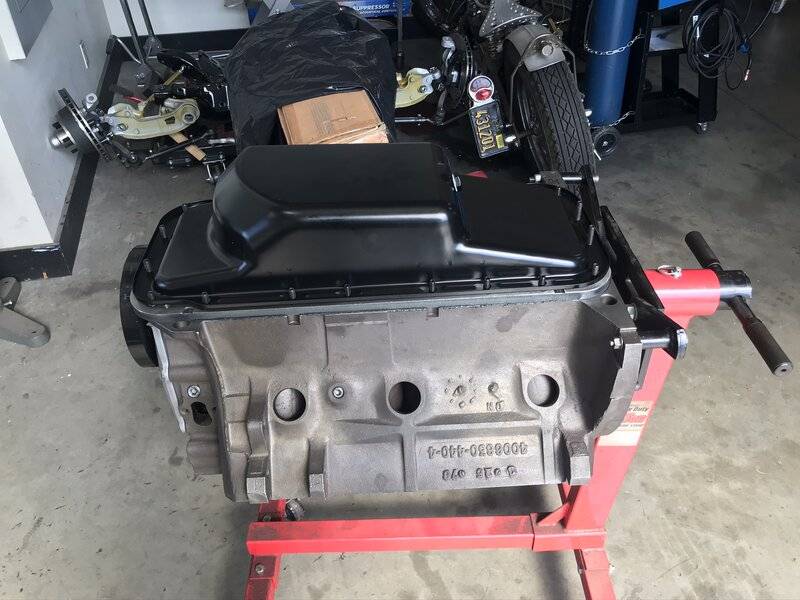

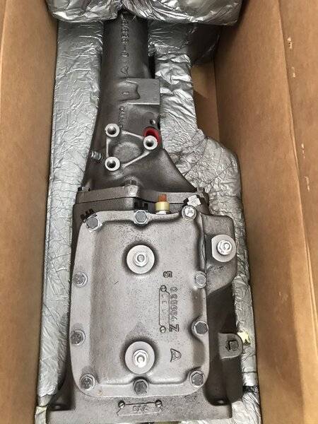

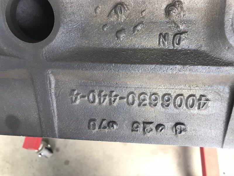

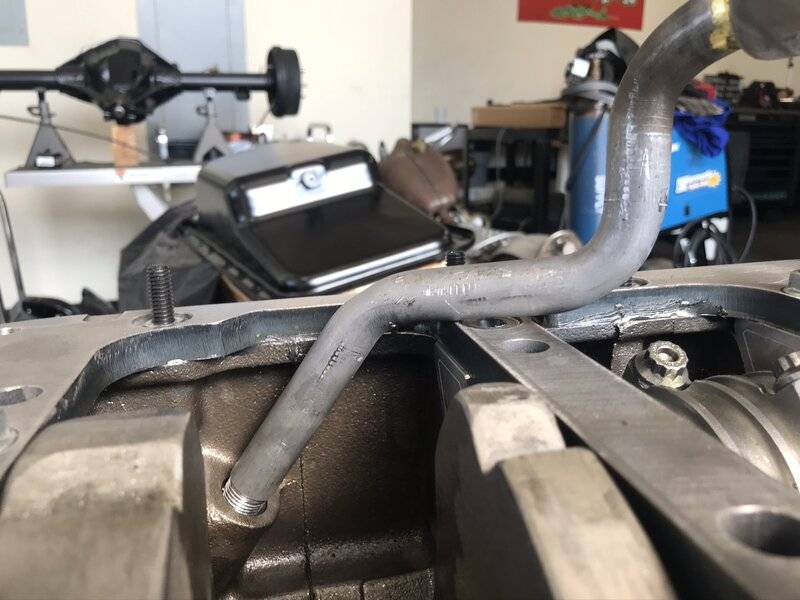

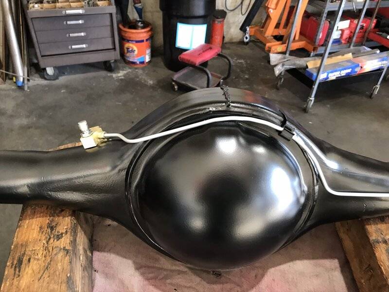

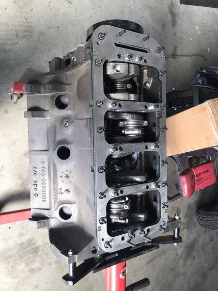

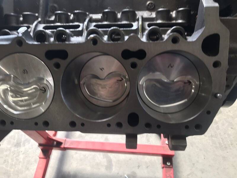

Motor is a 440 .040 over forged crank offset grind to a 3.899 stroke, Molnar 7.2 rods with chevy journals. Custom made Ross pistons.
IMG_1194.jpg IMG_1199.jpg IMG_1201.jpg IMG_1202.jpg IMG_1206.jpg IMG_1209.jpg IMG_1213.jpg IMG_1214.jpg

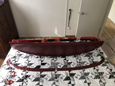

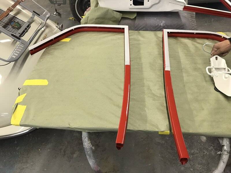

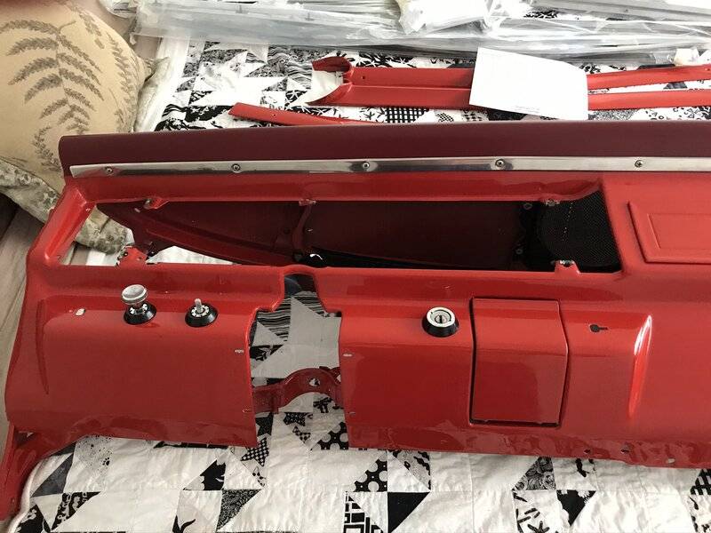

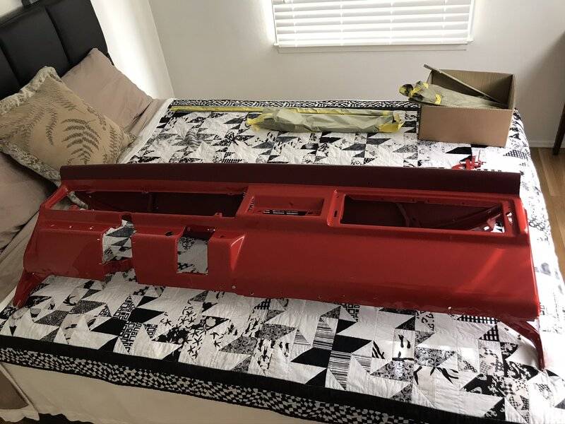

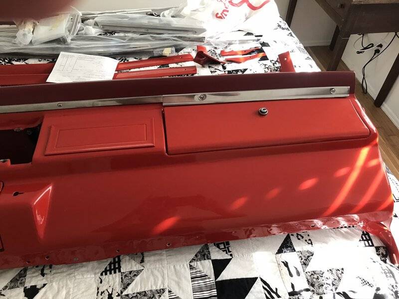

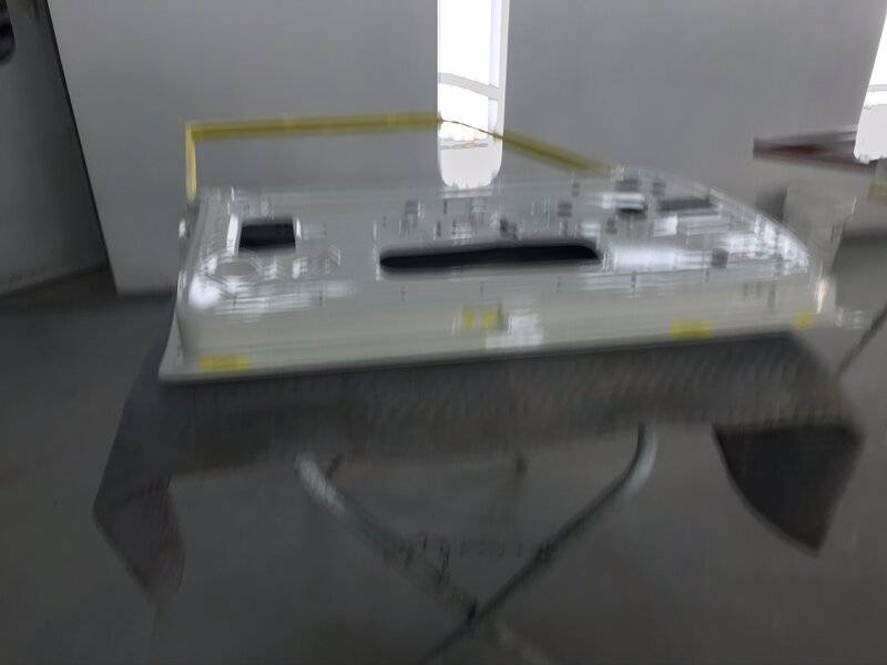

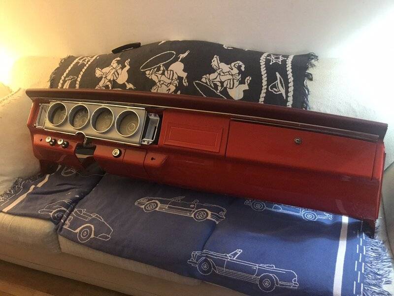

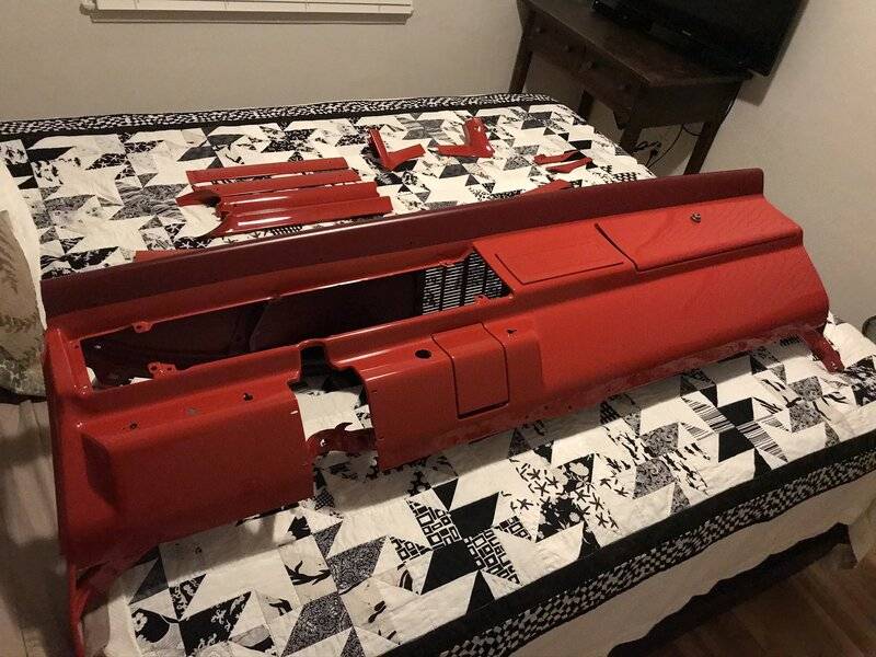

did you do the top half of the dash a mat red and the bottom half a gloss? I’m in the middle of body work myself and wondering if you had the colour code for the top and bottom of the dash?
