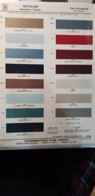

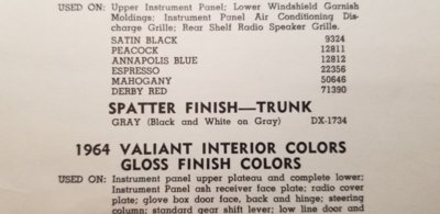

64 paint chart
Unfortunately you can't get the proper color of Zolatone anymore discontinued.
Eastwood shows black & white on their website.
