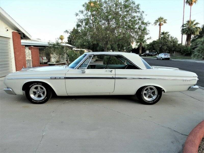

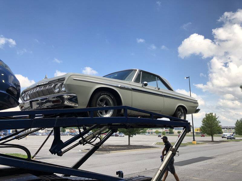

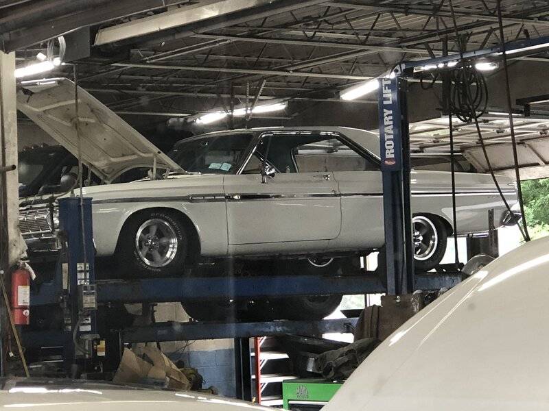

1964 Plymouth WW1 white
Definitely not a bright white. I was going to paint my 64 that colour but was too creamy. A close modern paint color is called “cool vanilla” .
Is it a bright white or a more of a "cream" white!!!
WW1
EC6C8525-E221-4396-9BB9-82C063F364B9.jpeg EE10BCC0-970A-45F8-8273-47A6C500E8D9.jpeg F8422F53-0CD5-4E01-B877-1F603D0CC184.jpeg
I used Spinaker White on a two tone more door Bel. I did last year. Not sure what years it was used and on what?? It is a soft white, I prefer that to the bright white on these old cars. Google is not always your friend!
I had a 1973 Satellite Sebring Plus that was Spinnaker White and it was a bright white. I prefer the WW1….
I had some old Spinnaker white and a Ford Performance white (really bright) , I shot some side by side, the Spinnaker looks less bright,more cream ish, BUT you might well be correct . Anyway, reason I am asking I have decided to paint my 64 Savoy back the original WW1. I want more of cram white.

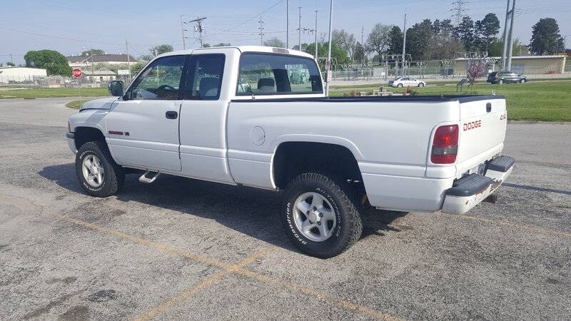

another WW1 white, but a 1996. it is the same color

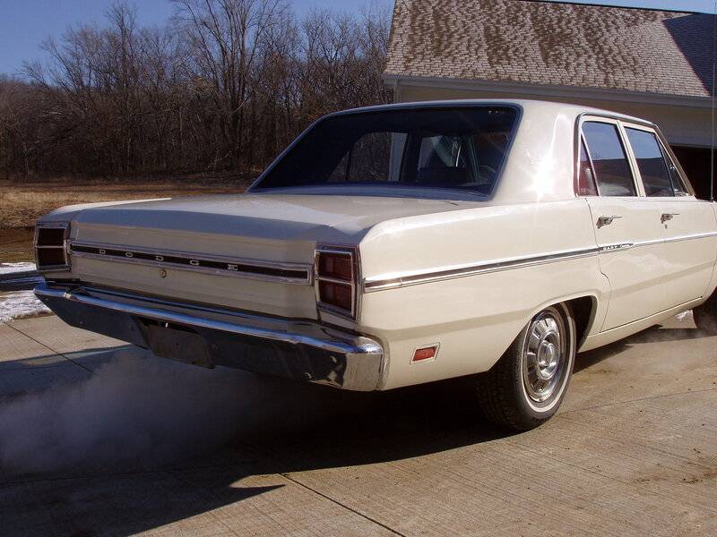

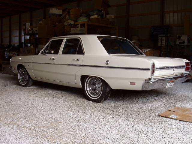

I would recommend you specify year when you order the Paint, as W1 is used by Mopar for many years, and the white on my dart is much softer then the W1 coded paint on my 2017 Jeep Patriot, which would be considered spinaker. the 64 should have a Ditzler 8358 code, and chrysler number DT1263.
I remember because I have a 65 dart painted W1 as well, and it looks like the dart. soft white.
