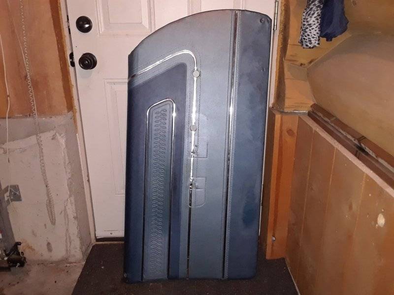

I recently changed the door panel cards on my 64 Polara - learning curve but they turned out better than the 60 year old units. Not perfect but acceptable for me. New re-pops are about $850 US which equals about $1300 Canadian by the time they reach my door. The bottom of the vinyl has old paint or whatever which I can't remove. Anyone have success with painting vinyl? I'd be looking for product information as well as color match. I'm looking for the deep / dark blue for the lower part of the panel. Thanks, Charlie

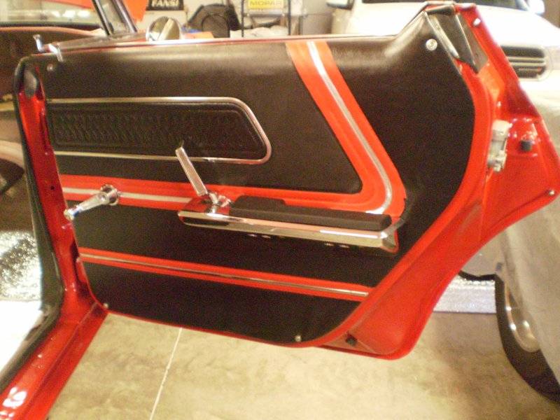

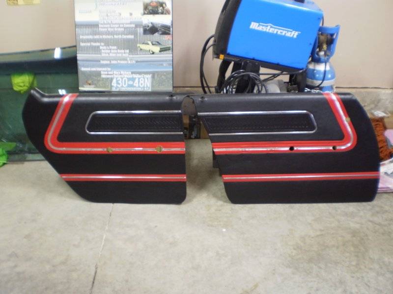

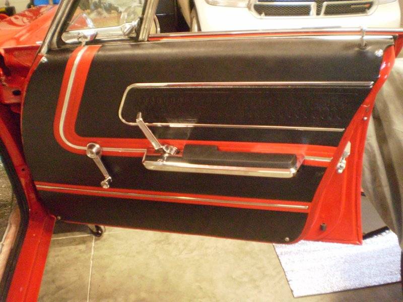

Here are my door panels that I did up for my '64 Polara 4-door hardtop. They are out of a U.S. parts car I had. The U.S. panels are much more ornate than the Plymouth Belvedere based ones that came with my Canadian car originally. They were originally red, but I masked off some of the red and sprayed them black. I used SEM vinyl paint from CarQuest. Duplicolor has an adhesion promoter that temporarily softens the vinyl to make the dye stick better. First picture is of plainer panels the car came with. I also used the longer front door arm rests and bases on the rear door. Quite a change!
