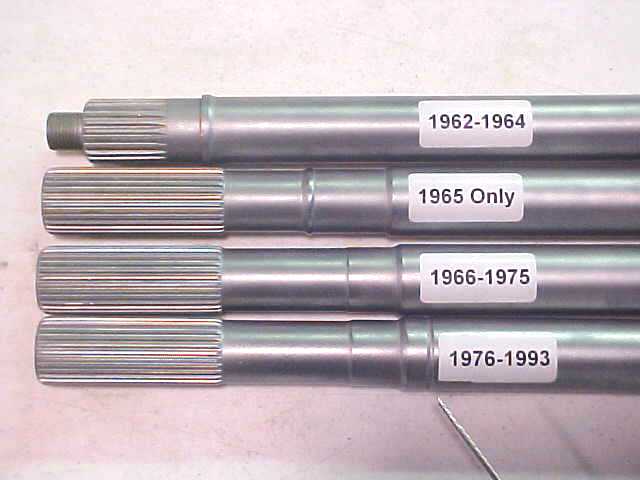

The later yokes fit the 65 output shaft. However some are too long and bottom out on the expanded ridge just forward of the splines. See 2nd shaft from the top in the pic. Easily remedied with a chop saw.
Doug
Doug
Nice photo! I'll keep the ball and trunion.
Good info, thx. If I'm remembering right, that ridge is supposed to have an Oring, which it stops there. .....and the '65 only yoke should be machined round in that area (no spline) to accept the oring.... and that's why the yoke had the small cap with the tiny hole in the rearward end to vent that joint when the yoke slides in and out. Must not have been the best way, because they got away from it the very next year.

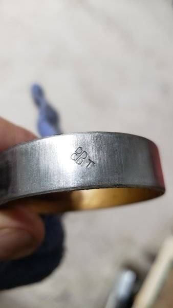

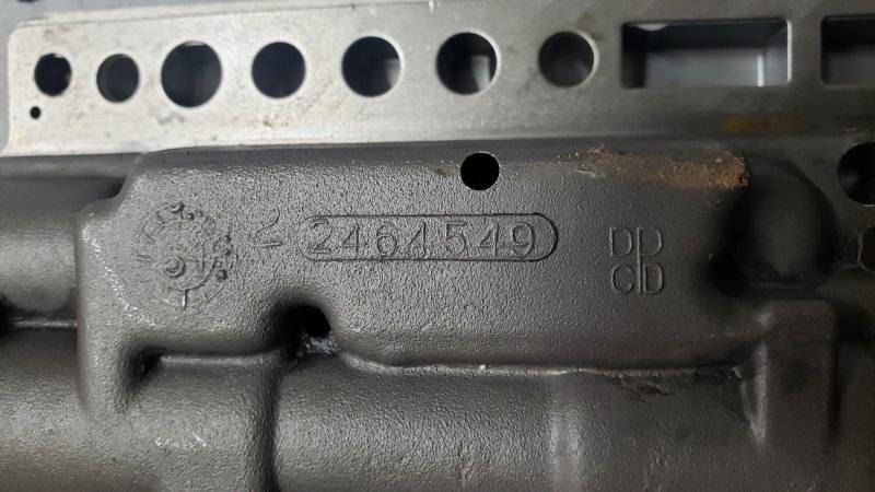

Couple of part stamps...

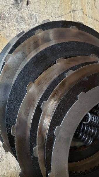

Got the new bushing and seal in place. Took apart the rear drum, 10 springs. Clutches and steels look good. But I have new Alto reds soaking in ATF for install.

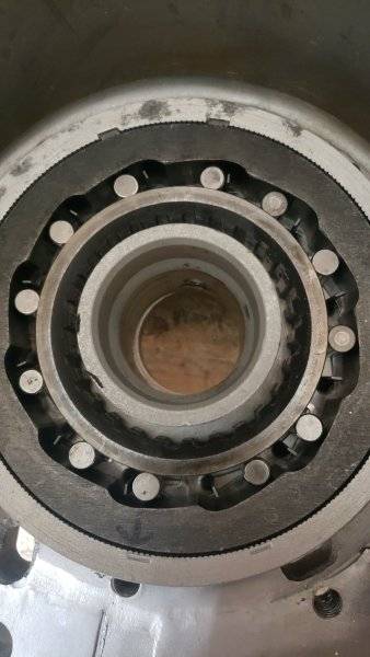

Rear pump went back in, very little wear. Overrun clutch went back in. It was tight in the case and the parts looked new. Cleaned and re-installed.

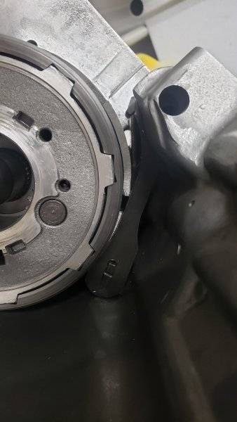

Low/reverse band needs to go in first with the strut. I put a new oring on the pivot shaft and added rtv to keep it from weeping.
So I got the pump housing installed and the tail shaft put in with a new bearing. I still need to measure end play but it feels pretty good.

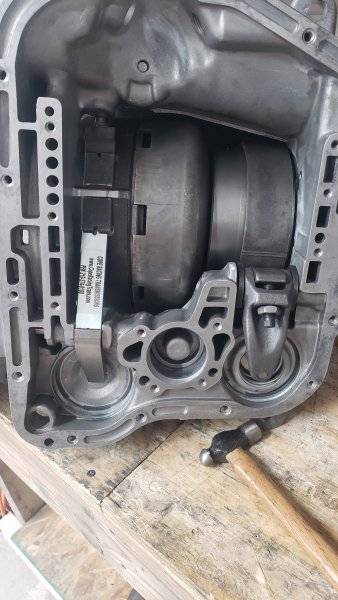

I checked both servos and clutch packs with compressed air and they all are good to move on to the valve body. TransGo TF2 kit going in.
