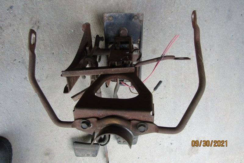

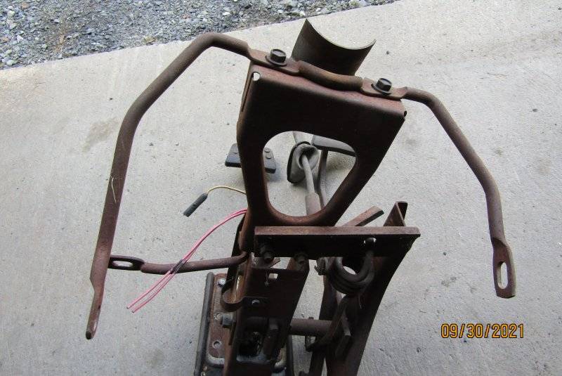

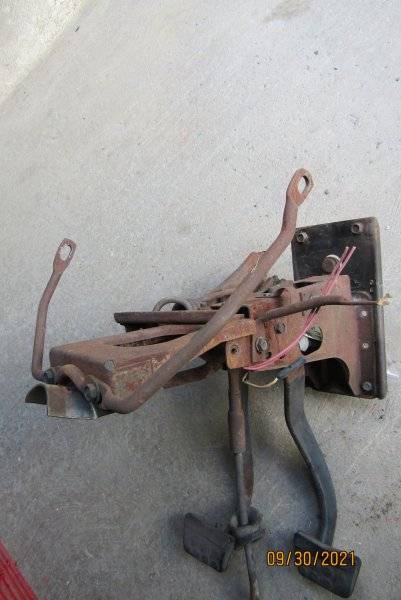

Hello everybody!! I have a customer that brought in there 1964 Sport Fury 426 Wedge to get reassembled and I have two parts that I have no idea where they go. Can I get a little help?
Thanks everyone! Troy

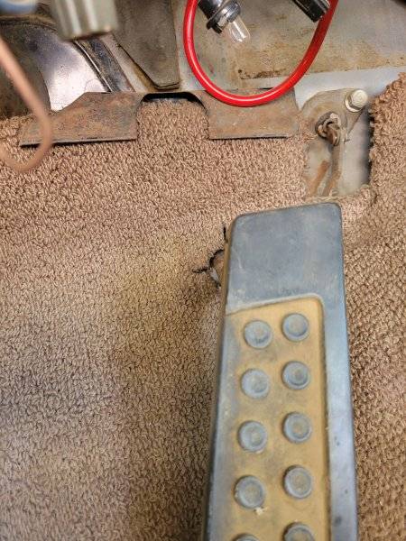

Looks like a steering column lower cover, and those look like braces that attatch to the pedal assembly not sure
Agree with the pedal braces (4 spd?), and the other thing looks possibly like the carpet holder ,retainer.
I just checked the peddle assembly and two of those brackets are hollow and one is sold…..there not them.
The braces sure look like the under dash braces to me. One from 4-speed petals to dash and the other from the radio area to the dash. At least they're that way on the 67 I'm working on.
Winner Winner, chicken dinner! I have all the bracing at the clutch pedal but I’m missing the one from the wiper mount down to the dash. Thanks everybody!!
