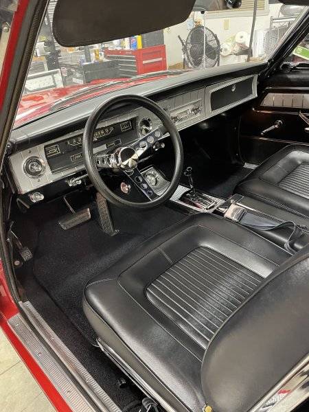

What differences are there between the console shifted vs column shifted 727?
I’m getting ready to pull my 318 and replace it with 383. I have a big block transmission that needs to be rebuilt. I have the stock console shifter and new cables.

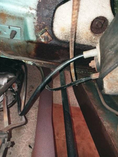

My '65 is a slant 6, column auto, and has the Park, and gear select cables. You'll probably need to get new cables for a console shifted transmission, unless by chance, yours are long enough to reach, and the ends.may be different ? I don't have a console car here to compare...
The valve body is different where the cables connect. There is a column shift VB and a console shift VB.
The cables are the same from SB to BB trans. Why would they be any different? They go to the same place on the trans.
I should have added, you can get cables from Imperial Services, they have a good website, and selection...
R413 is correct, cables are the same , just take the valve body out of the 318 trans and have it put in the big block one when they rebuild it and everything will work
Can you expound on the differences?? Thx...maybe a sticky or link would be awesome.
I've seen application listing for early (62-64) valve bodies and 64-1/2 to 65 as different. Never seen any detail regarding big block small block application, nor console/column. TIA, Lefty71
Early type; 64 and ealier pushbutton. Later type; 64 floor shift and all 65. The rooster comb, manual valve, and neutral switch are different between the 2 types.
