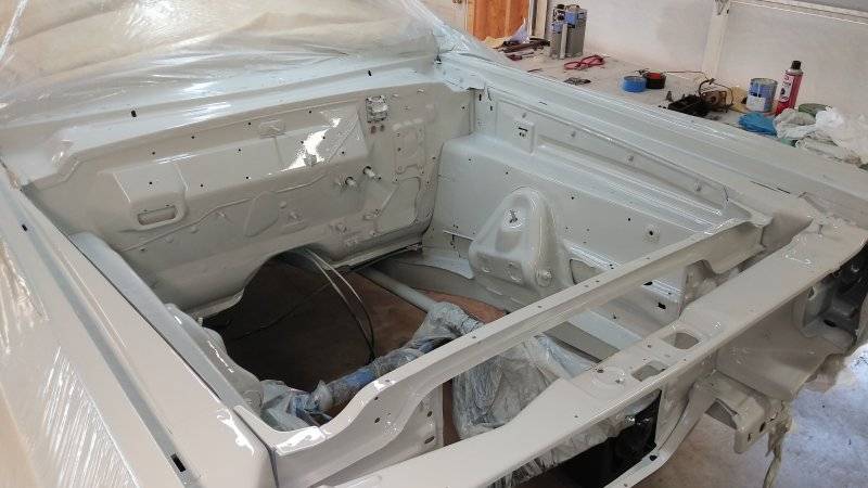

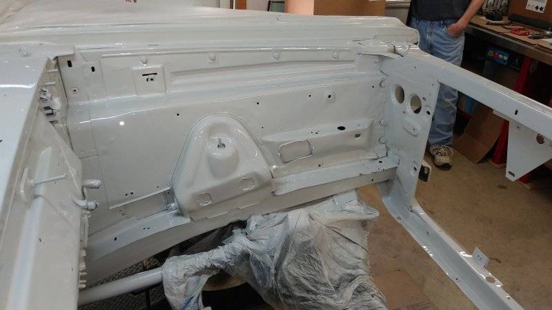

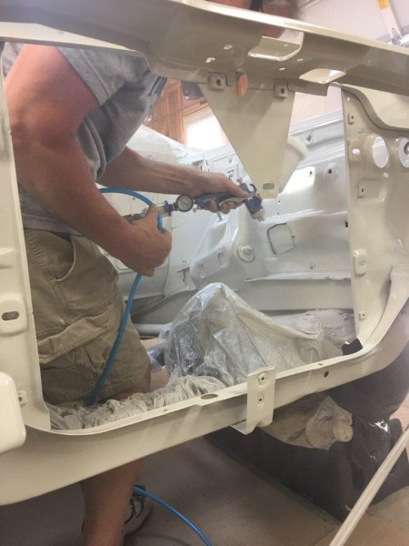

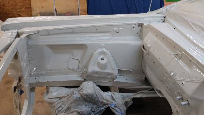

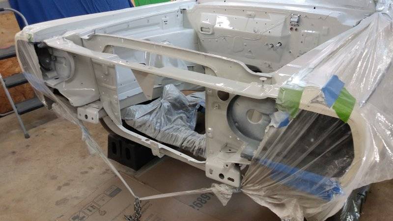

Helping a friend with his Coronet 500 Maxie project. The 65 413 is already built and on the stand which we completed fall of '22. The bay was fully cleaned out and minor areas that needed repair were addressed. Weather was perfect for shooting the bay today in 1965 Chrysler WW-1 white. For this job I used PPG Shop Line single stage JE acrylic enamel, JR506 medium reducer, and JH6002 high gloss hardener. This was the maiden voyage for my new Astro Europro HE103. Atomization and fan pattern were very nice. 2 coats covered nicely with good leveling at an 8:1:1 ratio.
