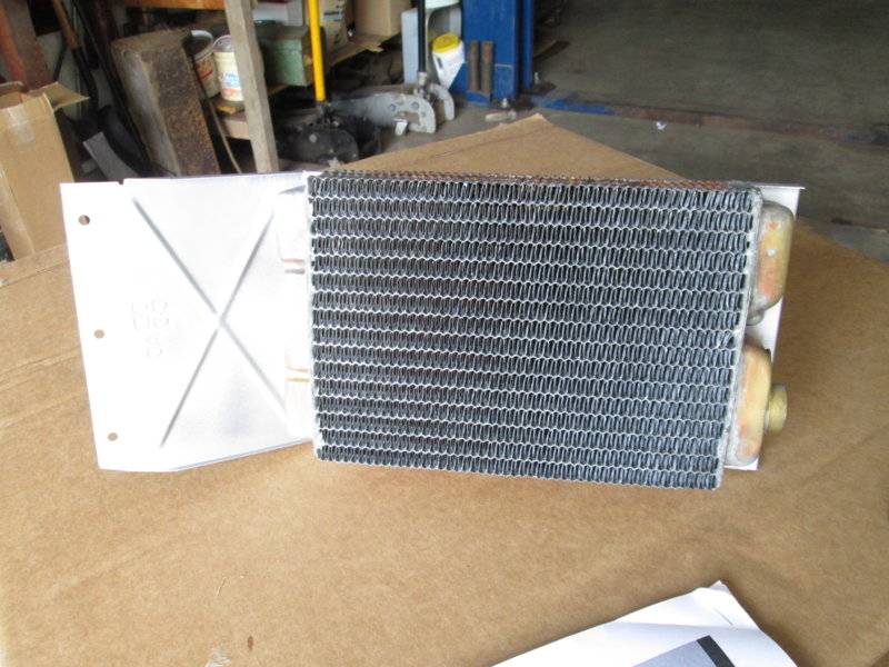

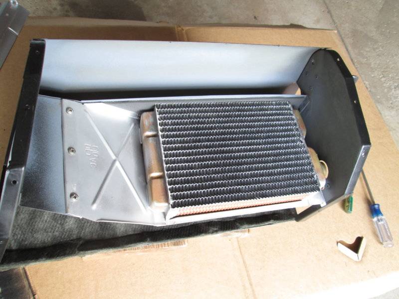

You can send your core to Glen-ray Radiators for a Re-work. It will come back like new, and fit right when installing. Ask for Bob S. You can tell him Dan from Lancaster, NY sent you...
Here's some pics of mine after they re-worked it for my '63 Dodge.
The BEST at what they do.
