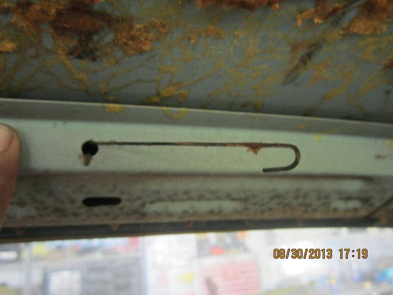

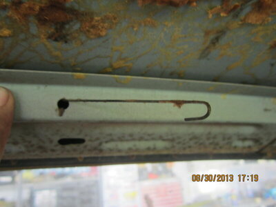

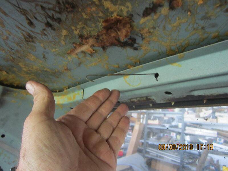

Somehow lost the 2 little wires that hook onto the back headliner bow. When I tore the car apart I was afraid I would loose them, so put in a safe place. Now I can't find that safe place. I found later year one's for sale, but not 1965. Will later yerk ones work? Could I just make some out of piano wire. How long are they? Anyone have a pair?

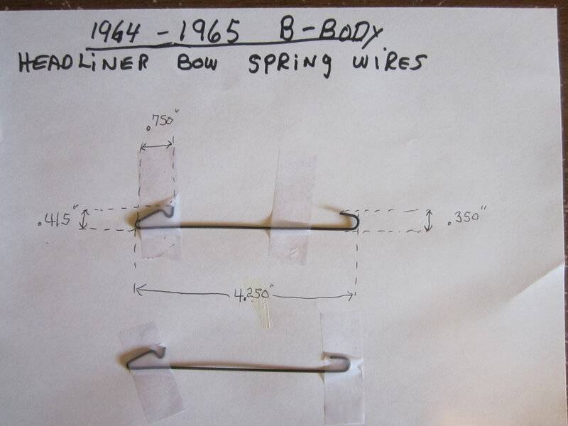

These are the dimensions of the 64-65 b-body wires I just got.
Looks like all the later years (A or B Body) are either longer or the ends are 90 degrees to each other.
