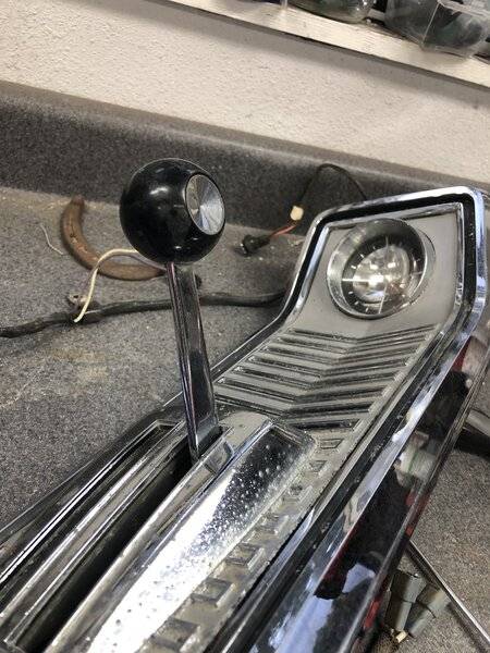

Looking to do some repairs to my center console but cant figure out how to remove the knob...Anyone know??
Most knobs including Hurst and Inland screw on and twisting CCW will remove them. All I've see (but maybe not all) have a jam-nut under the ball to tighten them against. The nut may actually be up in a recess in the bottom of the ball. Sometimes they are jammed pretty tight. Get one of those rubber bottle lid opener aids if it's really tight.
Don’t see any set screws. This one threads off ??
