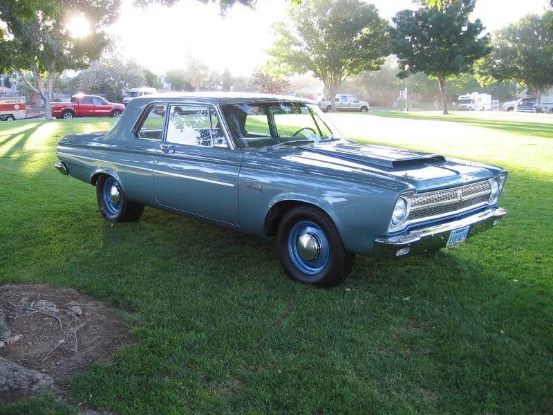

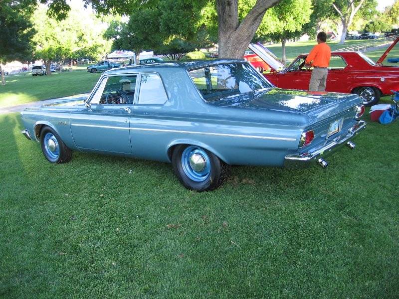

Here is how my car sat with 456/457 SS springs. Installed 2006. Photo 2021
