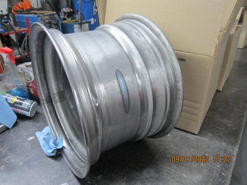

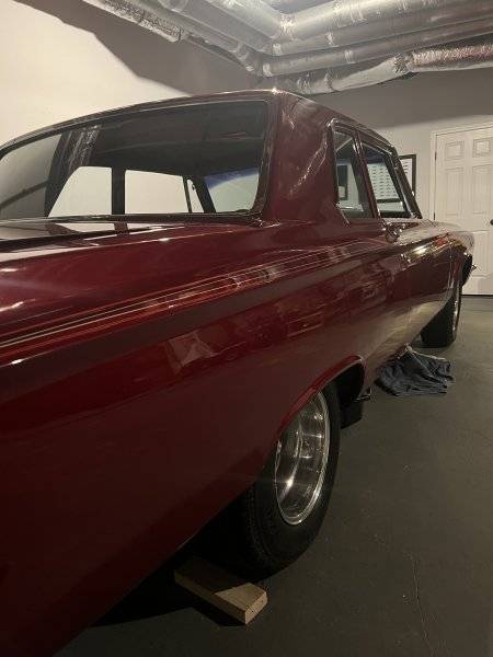

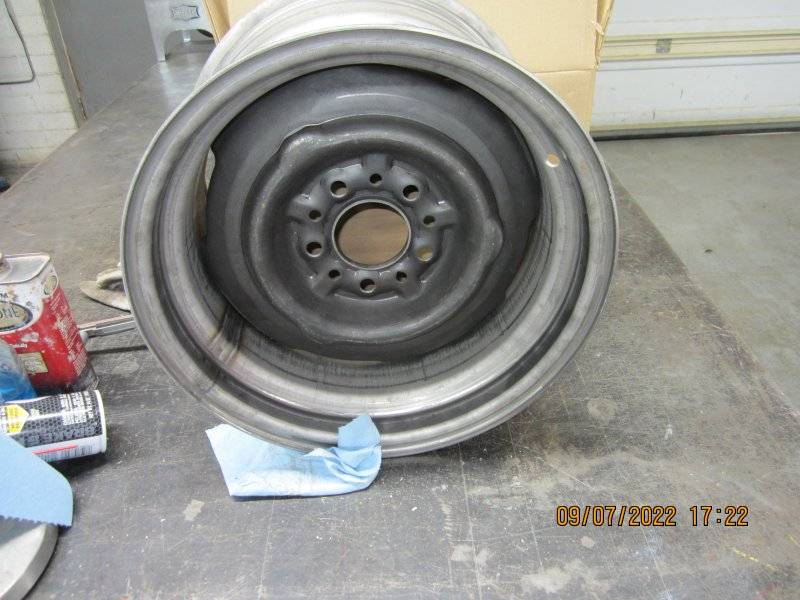

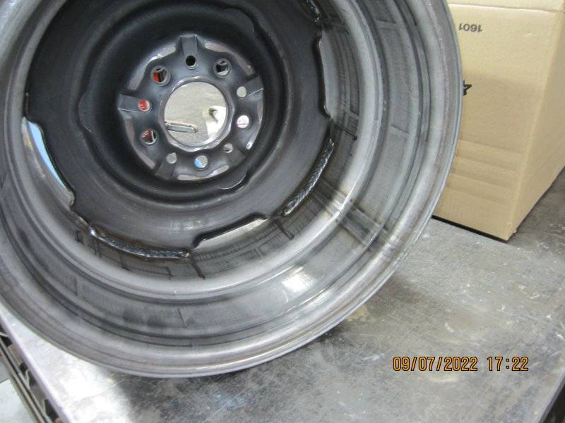

Just got my rear original looking wheels. Got them from Wheel-Smith. Only took 5 days after ordering and they were on my doorstep. Great service. Got 7" backspacing to fit with my mini tubs and inboard springs.
$295 each. They can make them in almost any width and backspacing. They made made mine really quick.

Wheel looks great, I have not seen any of the completed wheels with my centers in the 15 x 10 size. Cool

Don't wanna assume... They supplied the wheel centers?? You did'nt have to get the centers and send to them??
They look great, thx Lefty71
Yes, I sell to the Wheelsmith and I sell to individuals too just in case someone has the materials, equipment and skills to do them for themselves.

I haven't mounted my tires yet on the 15X10 with 7" backspacing. I have a used set of Pro-Trac 50 Bias Ply tires. N-50-15, 28" diameter, 11.3 thre4ad width, Cross section 12-3/4.
Using my tire jig simulator there will be a good inch on each side.
Mount one tire, don't bother balancing it, try it for fit on both sides. If it clears good on both sides, mount the other, and balance.
