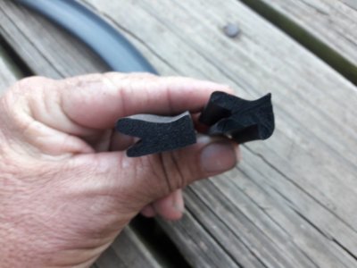

Nobody makes a correct style trunk weatherstrip with the lip that extends over into the trunk area with the specific areas removed for the rain gutter.
Most of the vendors now sell the basic generic style which is known as a "Y" shaped piece which does not feature the extended lip.
The only manufacture that makes a seal now with the lip or leg is Clester's. To make it work correctly, you will have to hand cut certain areas to remove the lip which is not difficult to do.
Up to the end of 2017, I was able to purchase from an OEM manufacture a nice seal with the lip and I was cutting them for the particular body styles and year models. Unfortunately, I am still searching for a nice replacement.
I have a posted a picture of the two different styles as used from '63 through '72 for the B-Body applications.
