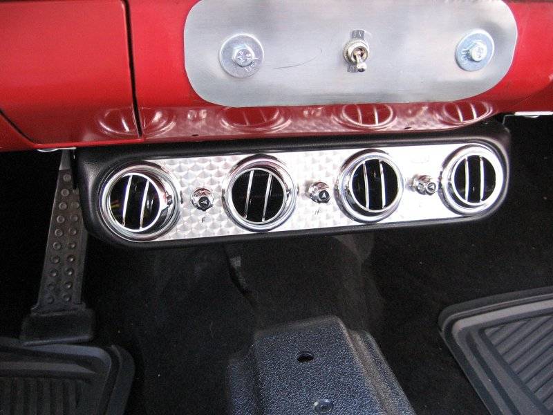

Now this is just a thought because you mentioned "Reviving" I went with Vintage air/heat all in one for my 63 Belvedere.
My car is just a fun beater and needed air for the Nevada desert.Easy to install and has the 60's style and look.
Again this is just a thought. Don't mind the ugly radio delete. Gotta get a real one.
