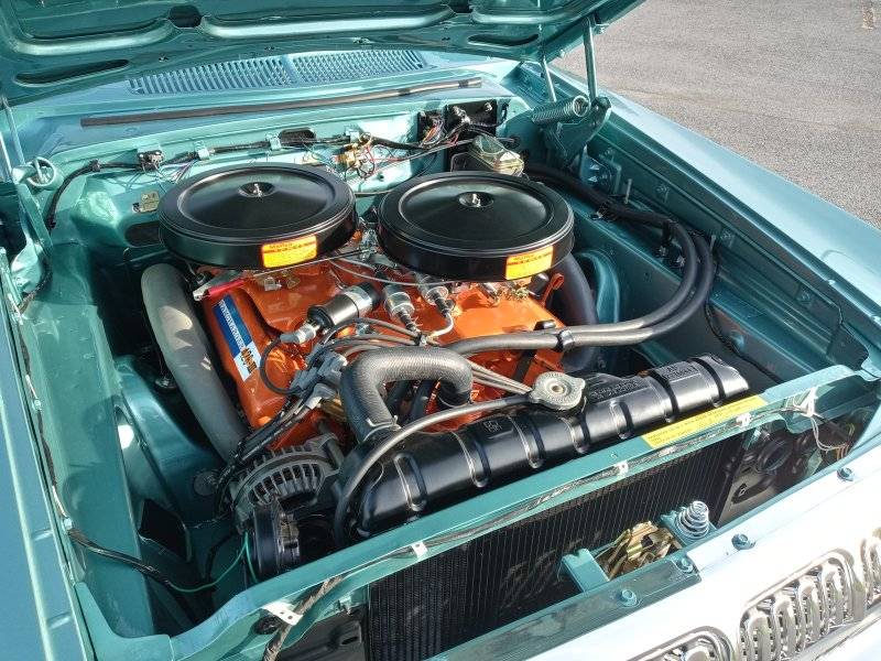

65's Deserve a BB ! There's plenty of room in that engine compartment.
Go Big, or Go Home !!!
