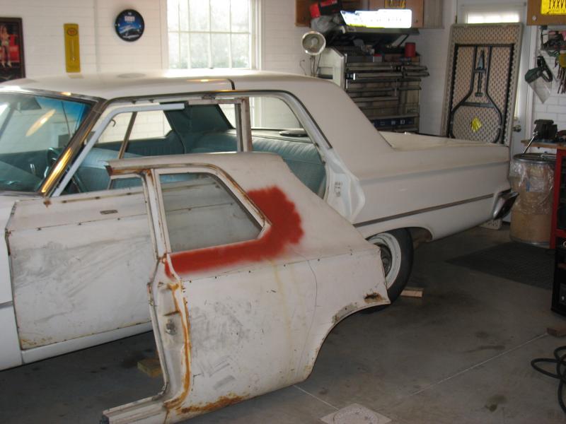

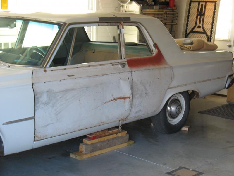

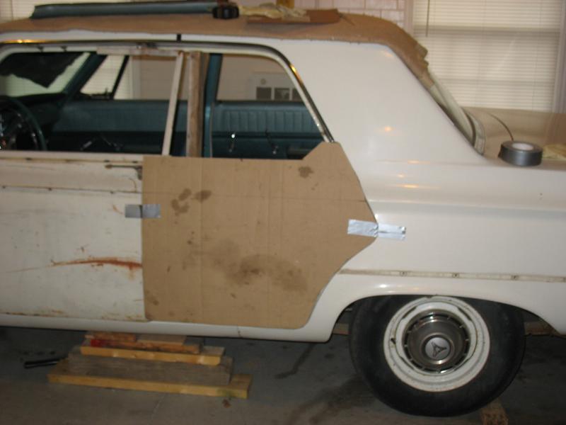

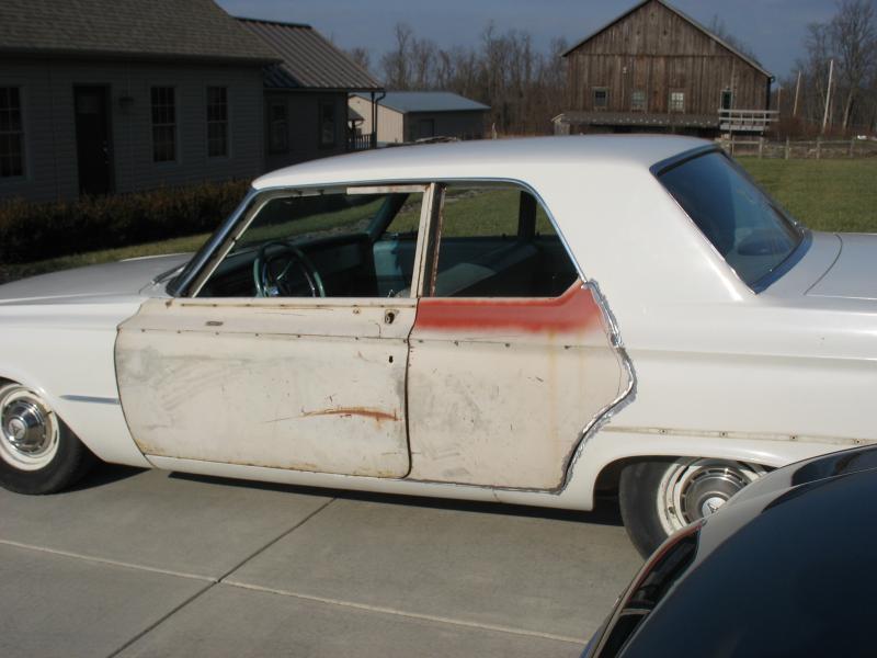

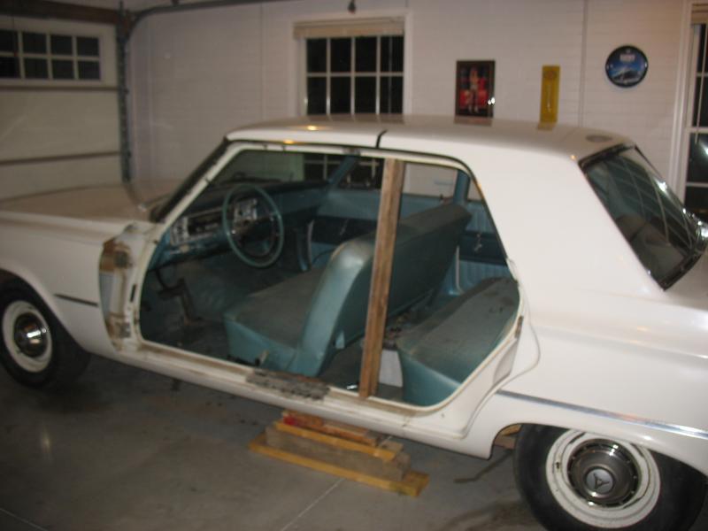

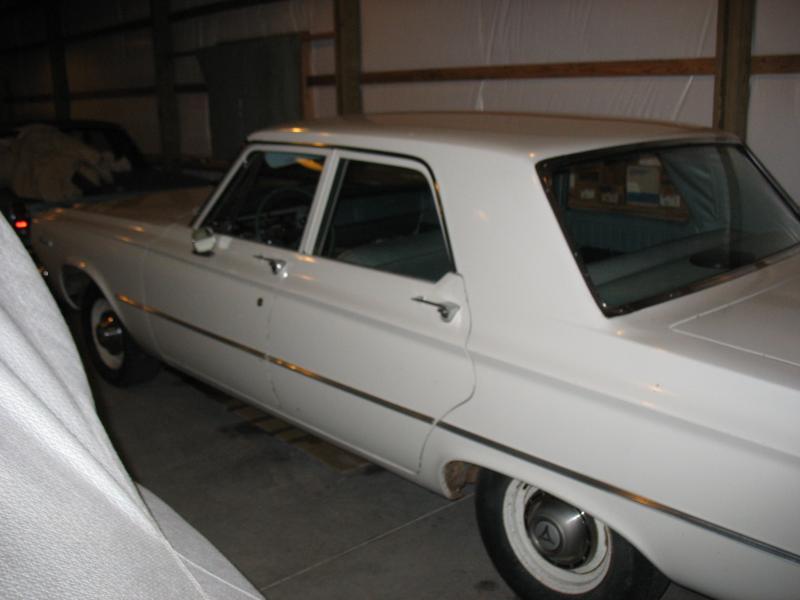

So I have decided to do the 65 Coronet 2X4 and table my 64 Savoy resto for a little while.
The project is a 65 Coronet California rust free AWESOME 4 door sedan.
56K original mile two option car, PS and seatbelts, radio delete and no backup lights, 273, 727.
It is listed for sale here, around the 12th. of Dec. if you want to look back at it before I started.
I'm into it by about 17 hours so far.

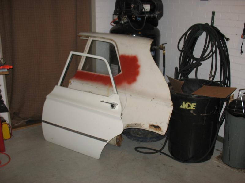

I am using 63 dodge doors and 1/4s so the rake on the doors do not match so I had to remove part of the upper frame from it and weld in the frame from one of my 4 door doner cars. It took one saw cut and drill out three spot welds and it fits perfect.
I have taken several pictures and have posted them here.
I just put the car in the barn until my neighbor is ready to weld everything for me. (I do not own a welder).
THE CAR IS FOR SALE AT ANY POINT AND INCLUDES ALL OF THE PARTS TO COMPLETE.
Let me know what you guys think!!!!!!!!!!!!!
Steve.........FU64RY
I posted like 10 pictures and these were the only ones that cam up. I'll try and figure out what went wrong.
