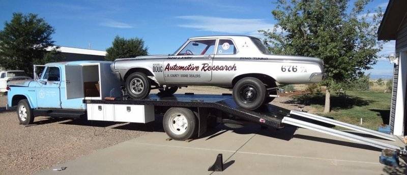

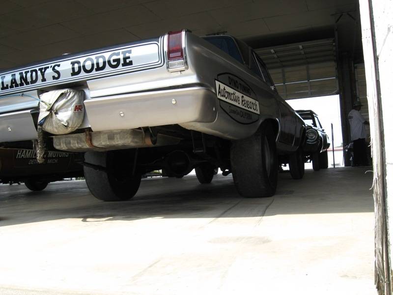

By the looks of the 2 pics you posted, the front ends don't appear to be moved forward. I really hope you get some knowing responses on this, as I am very interested in all I can learn on these also. Thanks for posting...

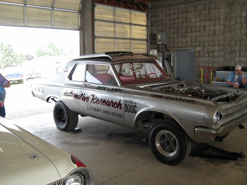

I'm pretty sure the 2% cars were '64's. Look at Hemi-itis' photos of the RAMCHARGER Dodge above (Unlettered, it's the top right photo). The K frame bolts were moved forward. The leaf spring front section was shortened and the inner fenders were rolled. I don't think they used sedan doors on hardtops...I think all the 2% cars were sedans. This I'm not positive of though.

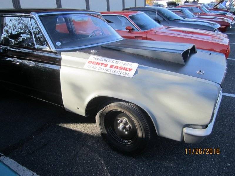

These 2% cars used thin gauge metal in place of the already outlawed aluminum from the previous year. Windshields were special bubble shaped plexiglass and sedan doors were modified to fit within the hardtop layout using plexiglass for the windows as well. The one tattle tail sign of one of these cars either in 64' or 65' were the deletion of the wind wing vent windows and its hardware on the doors. Full plexiglass sheet was installed in its place to make for a one piece type door.

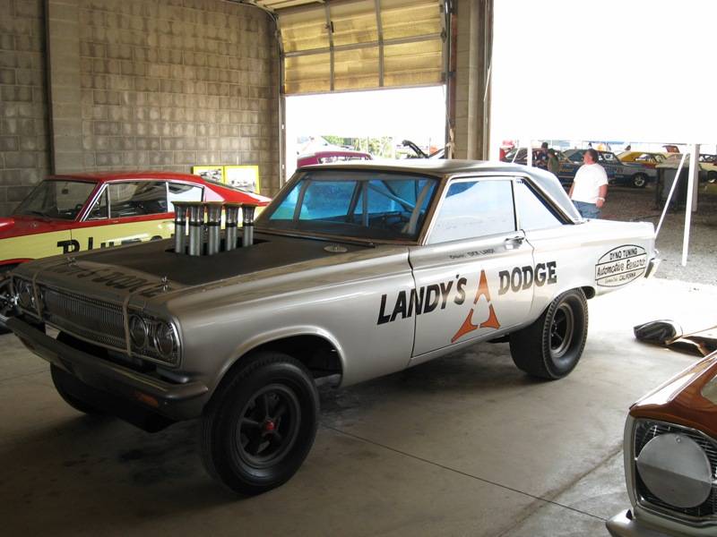

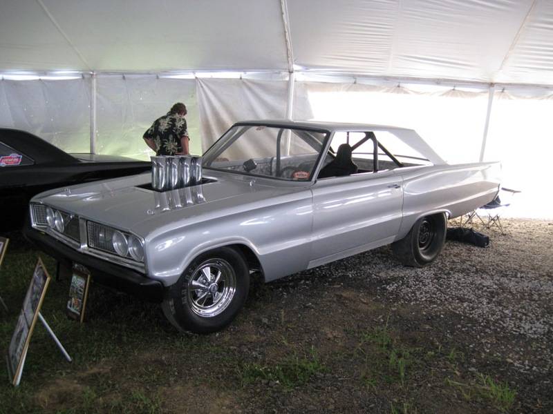

Looking at Hemi-itis's photo montage, there are a host of different cars there. The first one which is Dandy Dicks car is a bonafide 1965 10/15 AFX altered wheelbase car. The second one is Dandy Dicks 1964 A-864 Sedan SS car that was altered to a 2% stance, but also utilizing a straight axle by Dick himself. Perhaps the first of its kind.

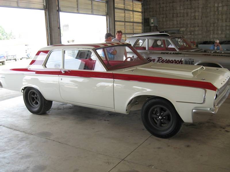

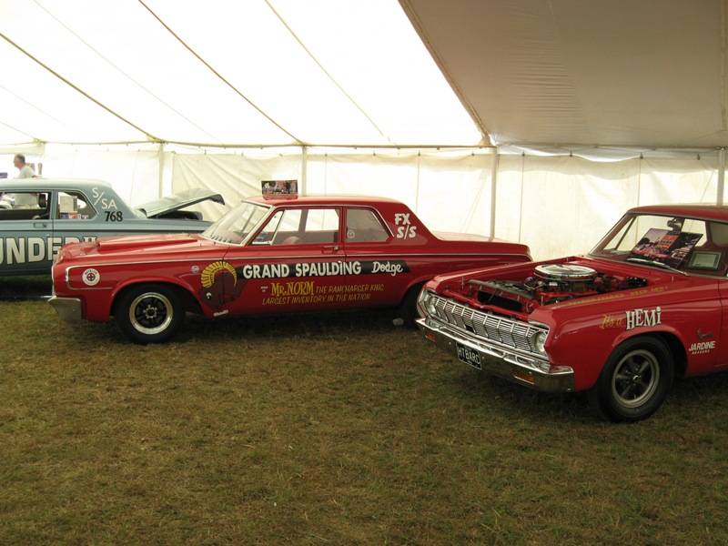

The 3rd photo down is the Diamond. It's the Ramchargers bonafide factory 1964' 2% car. Note the front fender apron cut out to clear the front wheels.
