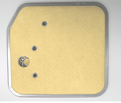

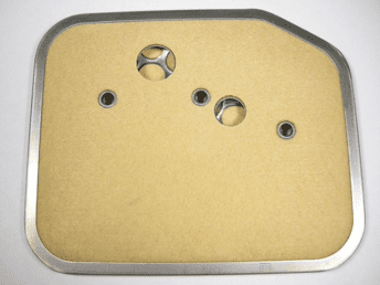

Make sure you have the 2-hole filter on it. These cable-shift tranny's have a rear pump in them that later Torqueflights don't. If you block that one pump intake off with a regular newer filter, the trans will do funny things, like not upshift. Don't ask me how I know!
Like was mentioned above was the trans filter replaced while lowering the fluid level? If so it has the wrong filter...
Early filter

Late filter

The screw pattern is the same, if you use the late filter on the early trans you get no high gear...
