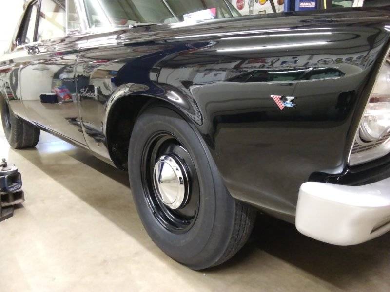

When I finished my '65 I had radials front and rear. Didn't have the look I was after. Then I changed the rear tires to the old period correct cheater slicks. Mixing radials with bias tires ain't good!
So I just bought a pair of BF Goodrich Silvertown Bias 7.10-15's from Coker. Expensive but period correct look and no more crazy, ill handling.

Do you have a close up of the rear wheels, front wheels, and a good side view of the whole car? My 65 is black also! I still need to take some pictures to post here.
