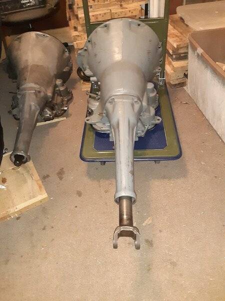

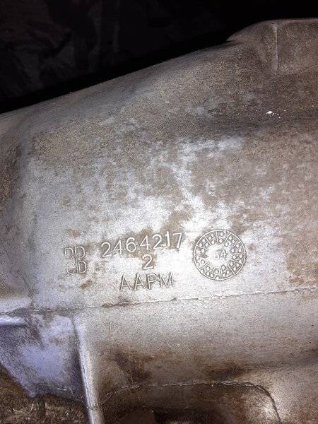

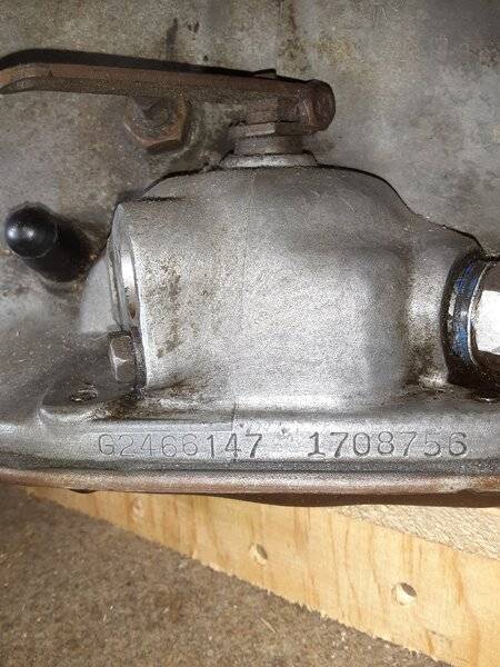

1. Car is originally a 318 automatic but the only original driveline part that I have is the tapered rear axle. When I bought the car, the P.O. included a 727 cable shift Trans. numbered G2466147 1850873. I've decoded this as a 1965 for a 361, 383, or 413 'B' or 'C' body. It has a 30 spline output shaft that has nothing attached to it. The tailshaft measures 18 1/2" long and is numbered 2464217-4 and the number '64' is in the date wheel. I also have a torque convertor but I'm not sure what it is.

2. Can I adapt the 65 transmission to work with my B&T driveshaft? If 'yes' what would you recommend? And yes, I realize that 65 was the first year for the slip yoke and that I'm trying to go the opposite direction of the way most folks go. Thanks!

Why not just use the 65 trans with a standard slip yoke drive shaft? The valve body would need a 62-64 push button rooster comb and manual valve. It’s a simple swap. Both the 65 and the 64 and earlier use the same converter. Either can be converted to late model 67 and up converter as well.
Doug
Check parts for sale in mechanical awhile ago I posted two 64/65 cable shift trans for sale, three different stall converters, cables, and a nice console still have them all.
I will sell separate parts if needed.Lenny
