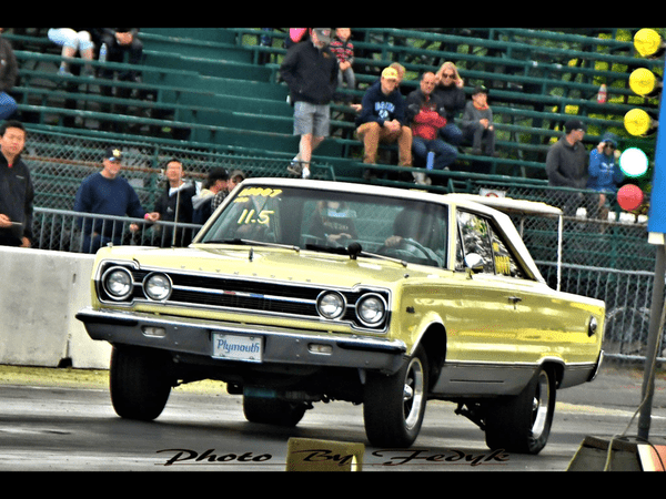

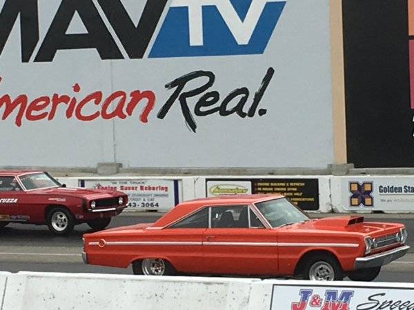

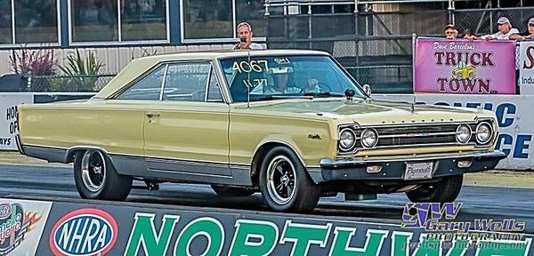

Been a while since I’ve checked this thread, sorry I didn’t reply to this..... regarding the results to the port work: I was actually somewhat disappointed in what I got out of the headwork alone last year, which was about 2 tenths. From 11.6x’s in 17 prior to the headwork, to 11.4x’s in ‘18 after (given I did add about 65lbs with the roll-bar, so maybe at the same weight it would have been in the .25 range. But it made me think.... “the heads must no longer be the choke point, lets see if more valve lift will make better use of the headwork”. So this past winter I went to 1.6 rockers, moving the valve lift from .573 to .610. My theory was proved to be correct, as I gained a good tenth + from the rocker gear.
Gary what size exhaust are you running I ask because a guy I was talking to at the race track this weekend said he was running 12.20 with 2.5 and changed to 3in and now his best is 11.8x .. Great job on your car
4 door 273, 3 speed and 2 door 318, automatic. Just fun cruisers.
When I bought this car, the ONLY non-stock item on the entire car was a new dual exhaust system; complete street type of system with 2-1/4” tube and Flowmaster 40’s. Since the , I have added a set of of Hooker 1-7/8” Comps with 18” of 3” head pipe off the collectors leading to a set of 3” dumps. From there it steps down to 2-1/2” with an H-pipe setup, then into the existing 2-/4” system. I figure at the track I open the dumps, so the small exhaust shouldn’t be hurting me much, other than the weight.
The only change I’m contemplating is to get another set of 3” dumps, and cut the flanges off them and rearrange them so the cap comes off the straight through pipe side, and the intersecting “Y” pipe would then lead to the exhaust system. Since I don’t street race, I’m really not concerned in the slightest with losing a few HP when the exhaust is corked up. It’s still plenty beefy a street car, but I think that change could be worth a few HP by making the open system truly a straight through type of setup.
