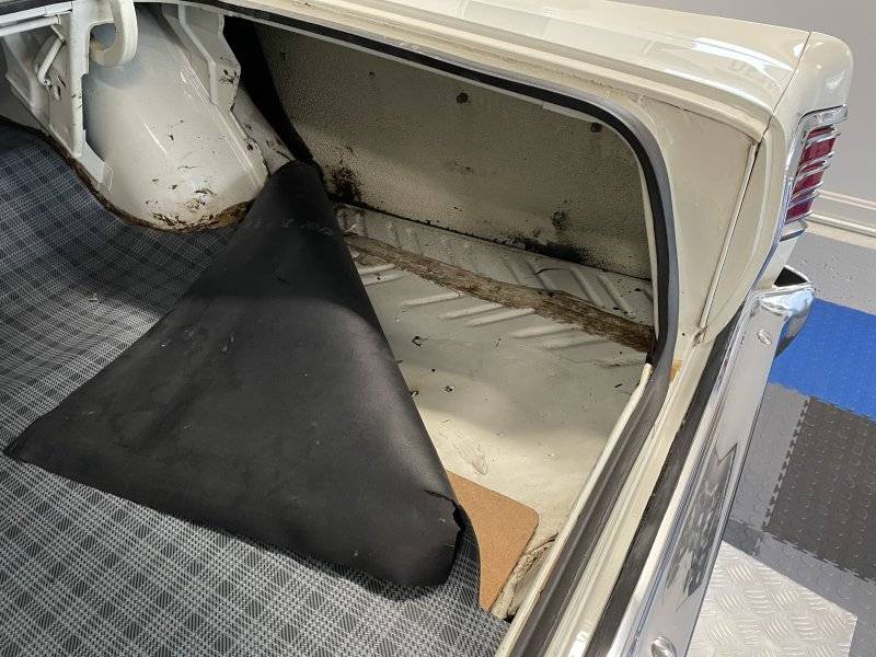

Well my '66 was built in '65 and the trunk inside hasn't been repainted...

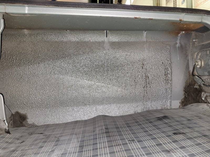

Here’s the trunk floor of my unrestored 66.

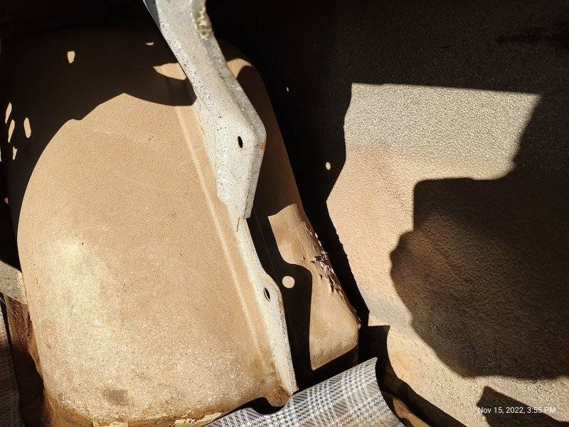

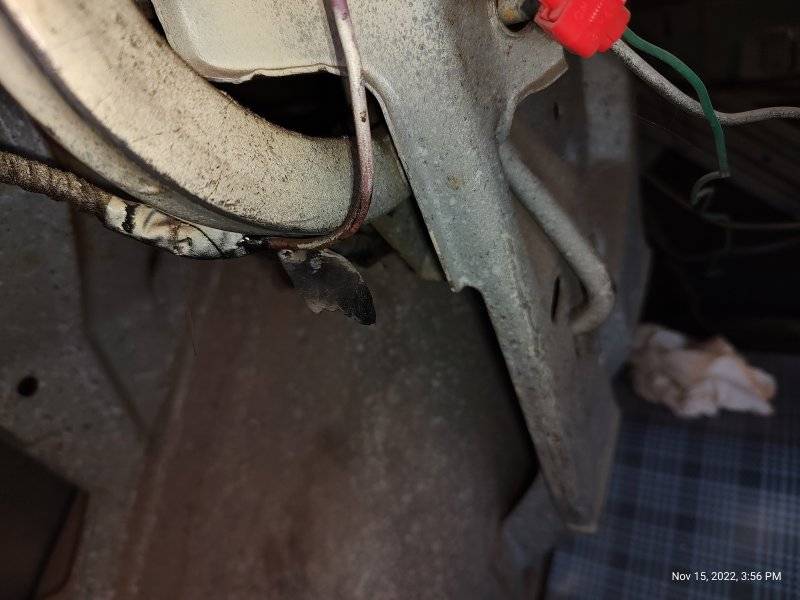

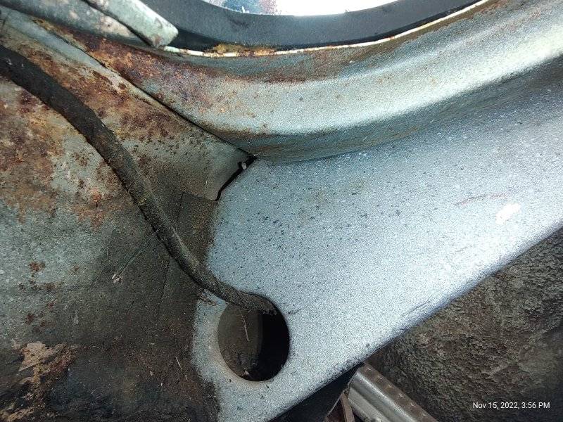

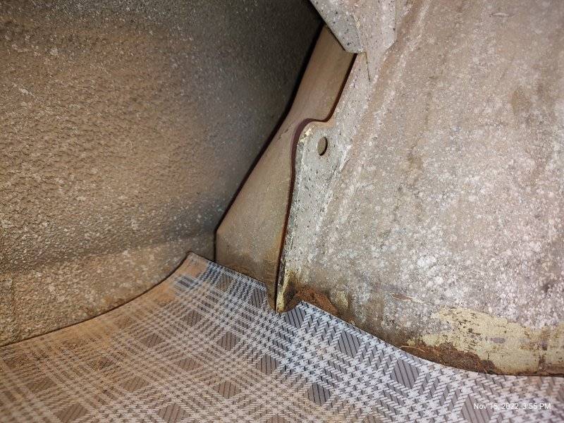

Here's my '66, built at Lynch Road, with an SPD of 901. The grey speckle appears to be original to the car. I've owned the car coming up on 43 years and have never touched the trunk finish. The outside part of the right wheel house has the grey paint flaking up a bit, I just noticed.
