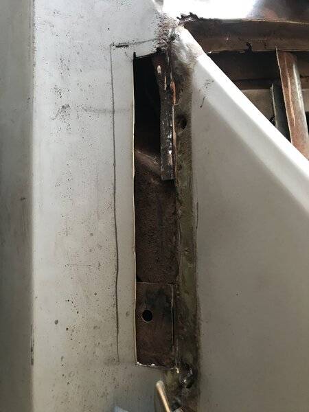

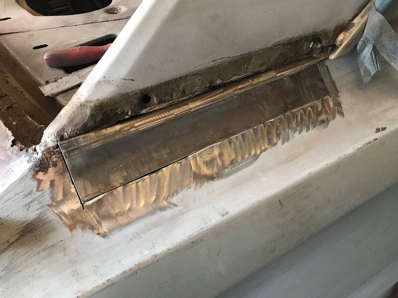

I used an old cracked door to get this piece and make a patch for the C Pillar of my 1966.
