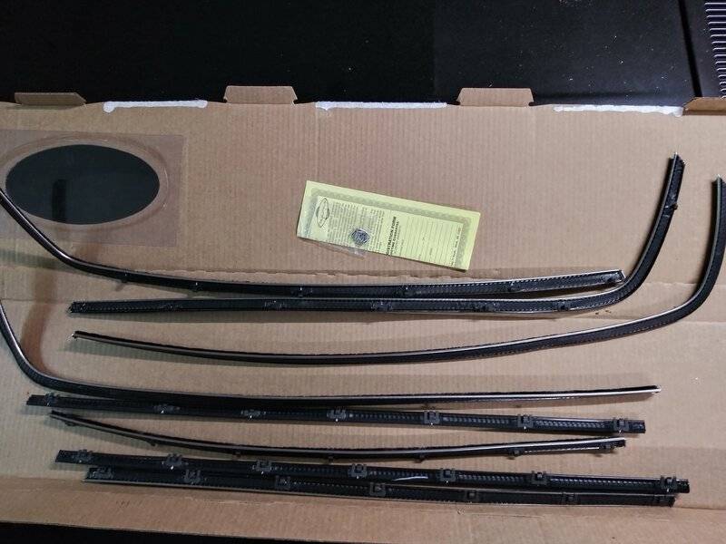

These are from Steele. Got an invoice from them yesterday that said they were being shipped from an "alternate location". Didn't know what that meant until today. The ones for the outside back will require holes drilled for the pop in fasteners (no instructions). The inside backs have the staples in the small bag but I have no idea how to use them. That's what the originals used but who has a stapler that goes through metal? Don't want to see that bad boy! The fronts look pretty straight forward but who knows. Don't know what I expected for $198.41 (shipped ) but there they are.....
I don't know about this stuff...View attachment 1103282 View attachment 1103283
These look just like the ones I just got. I got the Brand Name Cat Whiskers. They look exactly the same. The front ones went in beautifully. I put just a tiny spot of grease on the clip where it contacts the metal and they popped right in. I had to remove to regulator bolts to let the window drop down. I haven't put in the rear whiskers yet. I'm not really looking forward to it after hearing what others have gone through.

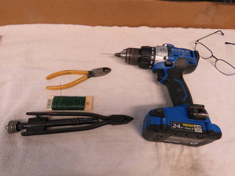

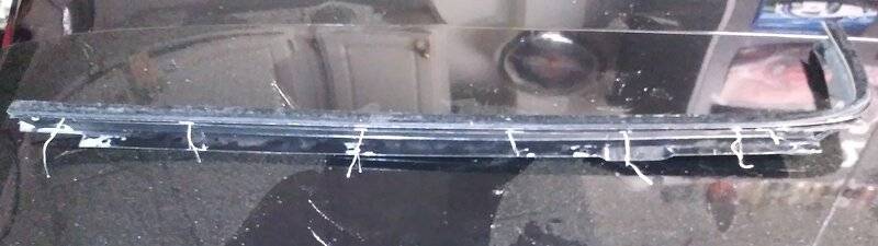

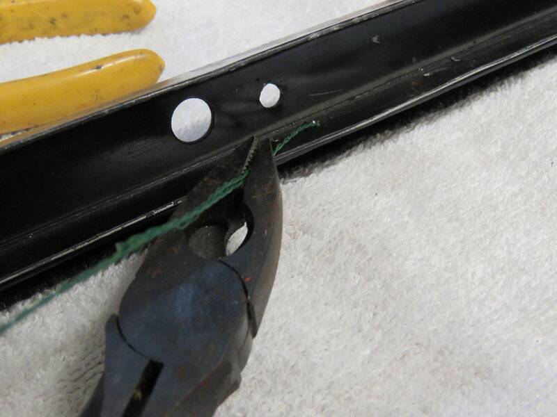

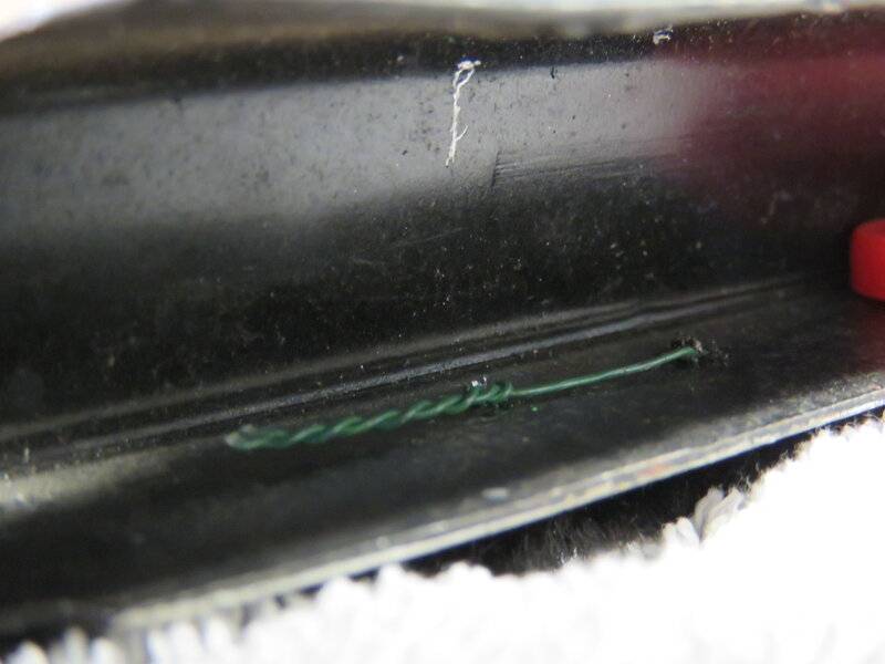

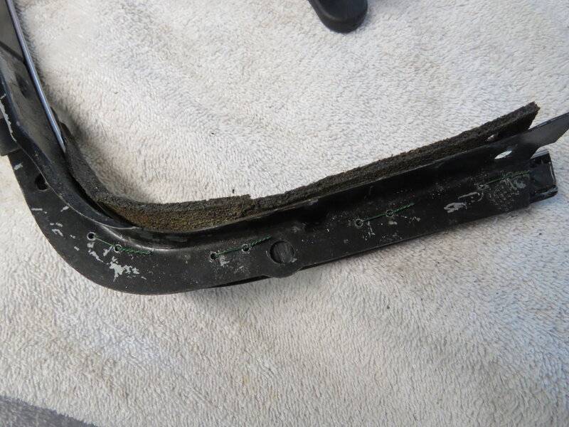

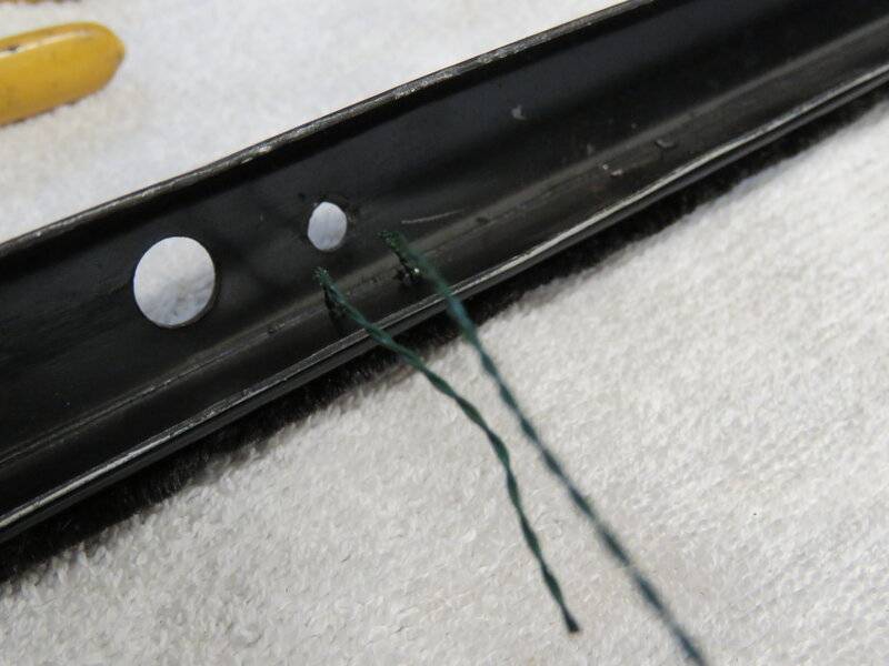

Window Fuzzies -- or, some call them Cat Whiskers. The inner and outer front door fuzzies go on with no issues. The quarter windows -- well, that's another story. For the inside, some say they glue them on -- some, double sided tape -- some, they screw them on. I tried something different. I lockwired them (Nuclear training paid off).
