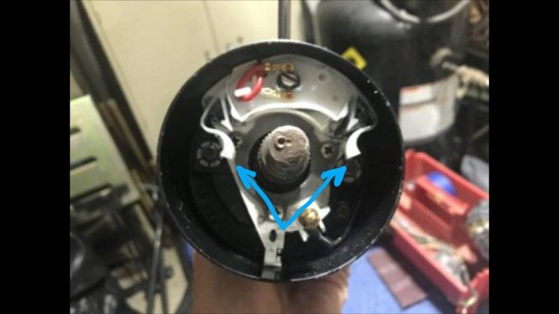

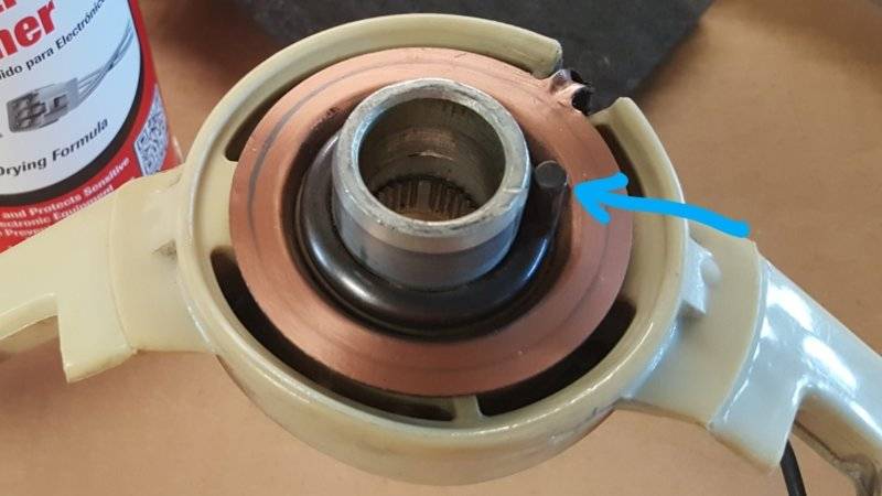

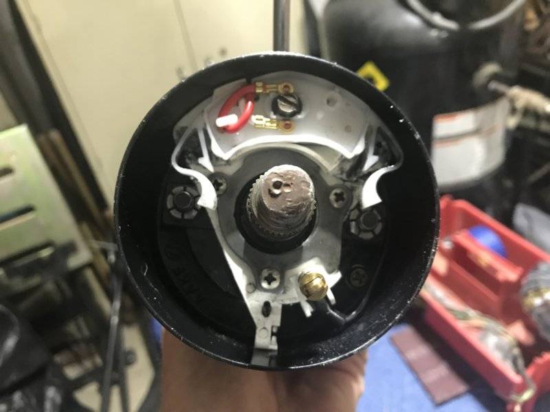

Hello everyone! I have been here for awhile now. But I could not get in from my old sign on! I tried everything! My son and I are restoring a 66 Charger for him. I just repainted and rebuilt the steering column. And replaced the turn signal switch. This car was partially torn down when we bought it. So I am not sure how the turn signal auto cancels itself ?? Am I missing a part? Between the steering wheel and the switch? Every schematic I have looked at online shows me nothing also the book I have is no help! Any advice would be greatly appreciated!!!

These are the cancellation fingers on the switch...
This is the pin on the back of the steering wheel that makes contact with them. It's like a heavy spring clip...
Thank you for any help and welcomes! I believe the 66 and maybe the 67 Chargers are setup differently than the 70s models? I would greatly appreciate a photo with just the steering wheel removed and the bottom of a steering wheel photo if possible. Thanks again for any help!

Thank you so much! I see the clip you show in the photo on our steering wheel. But mine appears to not touch the ears at all? With it turned right or left of the turn signal. The steering shaft just spins. Maybe the steering wheel is not going all the way down on the steering shaft? Someone had beat on it with a hammer. I had to do a lot of grinding on it and rethread it for the steering wheel hold down nut!! Did I buy the wrong replacement turn signal switch?

It doesn't touch until you turn the lever to the right or left. Then it catches it on the way back.

I can see what you are showing me, but it appears ours does not touch those ears for some reason, clicked in either direction? Like the ears for it to click against are way too short? Ours was all broken so I’m not sure what it should look like from the factory?

Not sure exactly what your '66 switch should look like. Double check the part number. There shouldn't be much of a gap between the column and wheel.
