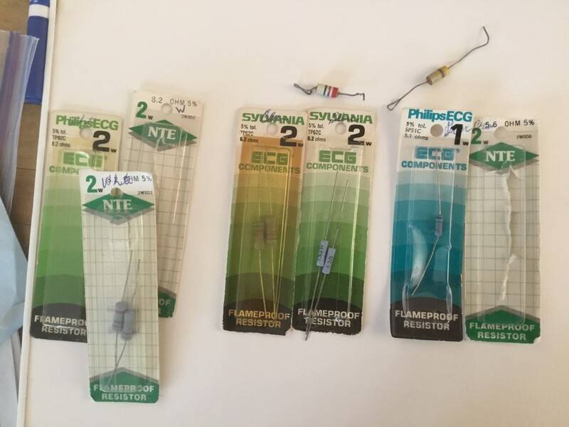

About 20 years ago, a friend of mine checked out my radio. There were 3 transistors near the right hand front of the radio. Each had a different rating. Replaced them. Might have spent 5.00 for all 3. Radio still works fine.

Thank you reheard. Hope one can make sense out of write up. Can’t remember why I had written down the 5 needed, almost think it might have been because I was doing more than one radio.

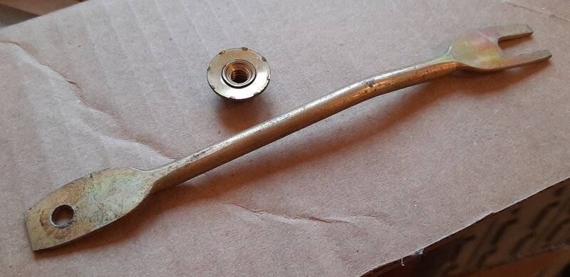

Big thanks to twecomm ! I sent Terry my radio and he checked it out only to confirm that it is in fine working order. I'm eating some crow here as I didn't realize the support bracket is also the "ground" for the radio... you live and learn I guess. All that means is that I either need to find a bracket or hopefully someone on here can share a photo and dimensions so that I can build one.

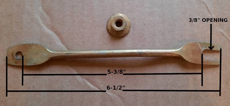

Note: 3/8" is for the fork end opening width, not length.
